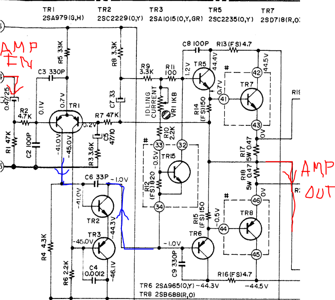

I got an Akai AM2450. I am trying to understand a bit of the schematics. (here joined)
Here the input of the amplifier stage. The differential pair takes its input from the pre-amp.
At the output of the differential pair, V+ is connected to the base of a PNP, and V- to the base of the NPN.
I am wondering what is this schematics doing ? In particular, they give voltage when no inputs, and I see 2.3V between the NPN base and emitter, which surprises me (0.7V would no be a maximum before failure ?)

Hi degleve,
IMO, the NPN/PNP pair you're asking about is just another differential pair. It's clever in that it avoids the parts needed to implement a current source to drive the emitters of TR2 and TR3, and operates near the negative rail without needing voltage "head-room."
I believe the voltages noted in the manual are mistakes. I predict if you measure actual voltages you'll find about 0.6V Vbe in both devices, just as you expect. Be careful with measuring techniques to avoid damage.

Mhh, I am not sure to understand. You means these transistors just pass the current of the diff pair to the amp ?
I mean what is the purpose of these two ? I provide a little bit more schematics attached

That's correct, but I would have said it passes the voltages on the collectors of TR1. It also serves at the so-called VAS (Voltage Amplification Stage).
Also note that R4 is about twice the value of R3. This is consistent with equal Vbe on both TR2 and TR3, and makes the bias currents in the both TR1 transistors roughly equal--- good for linearity, etc.
The input stages consist of two NPN differential amplifiers in cascade.
But in the second DA, one of the transistors is changed to a PNP type, and its collector is connected to -V instead of +V.
Since those two transistors still conduct the same (and equal) current, the current source is not needed.
