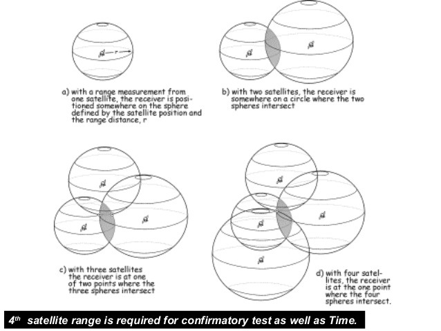

For those who can't get their heads round Einsteinian four-dimensional spacetime, here's a simplification.
You need four intersecting spheres to exactly pinpoint your location, and hence you need FOUR satellites (see attachment).
I remember you, mchambin, saying that this was the basis of early GPS algorithms.
This is THE wrong reason for a 4th satellite.
It is not needed to determine which of the two points is the right one.
The true reason is. You do not have the time of the receiver accurate enough. You cannot afford the cost and the weight and size of an atomic clock, at the receiver even an expensive crystal clock would not be good enough.
So, the receiver's time is unknown.
Thanks to a 4th satellite you can workaround this issue, calculating all 4 coordinates x,y,z,t ( receiver location: x,y,z, receiver time: t ).
A neat algorithm to do this is Bancroft method. It gives the answer with 4 satellites and with more than 4 which is usually the case.
https://www.google.com/url?sa=t&sou...EQFnoECAwQAQ&usg=AOvVaw24LtcQj3F-rX8WIQ2juxMw.
