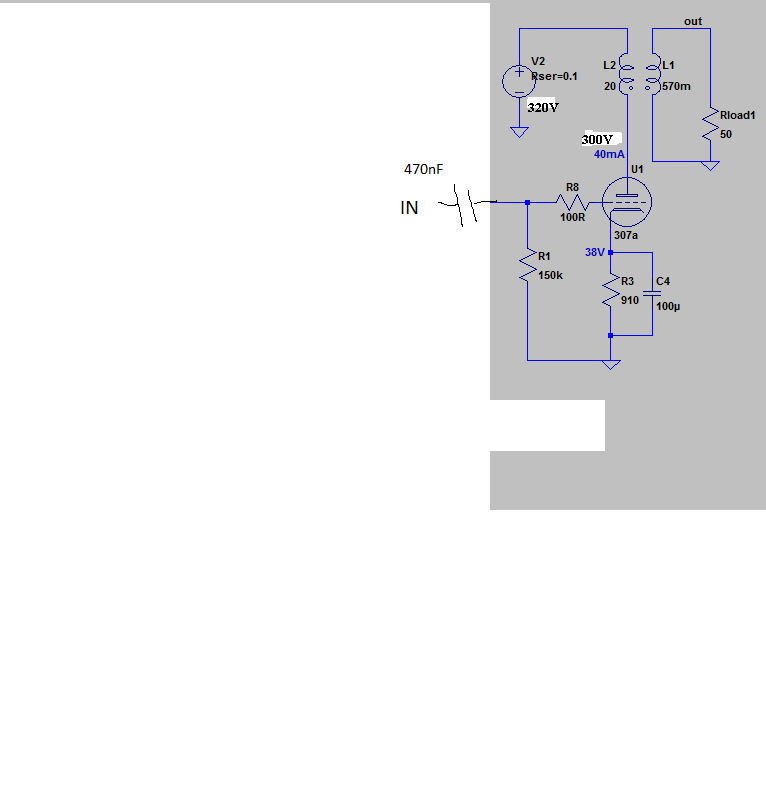

I am not sure what you are asking.
For a real Schade amplifier:
Start with fig. 33 on page 41 that was provided by Chris Hornbeck.
Re-calculate the resistances, output transformer, B+, etc. to use the 307A at optimum operating conditions.
It is push pull. You will have to do modifications to use it for single ended.
For the modern misuse of the Schade name:
I you want a schematic so you can use a 307A for a Schade negative feedback amplifier, start with the RH84 schematic.
You will need to adjust resistor values, output transformer, B+, etc. as appropriate for optimal operating conditions.
To make the amplifier as much like the RH84, you need to connect the 307A suppressor grid to one end of the filament (right at the 5 pin socket).
I would call the 307A a True 5-element Pentode (it does not even have a dual element filament/cathode combination).
DHP, Direct Heated Pentode? How about that for a 3 letter acronym.
Have fun!

Thanks for answers guys, I want to use it for a headphone amp. Original schematic posted by ikoflexer, still not tested. OPT Edcor 15K-600R 5W gapped. I think no Schade used.
I'm not tried nothing because I don't know how to connect G1, G2 & G3, also I want to use it in horizontal plane not vertical but not sure the proper orientation of filaments: for sure horizontal but I don't know if up or down (attached pinout shows horizontal down)?
That's and not knowing the correct Schade SE schematic left the project on stand by.
