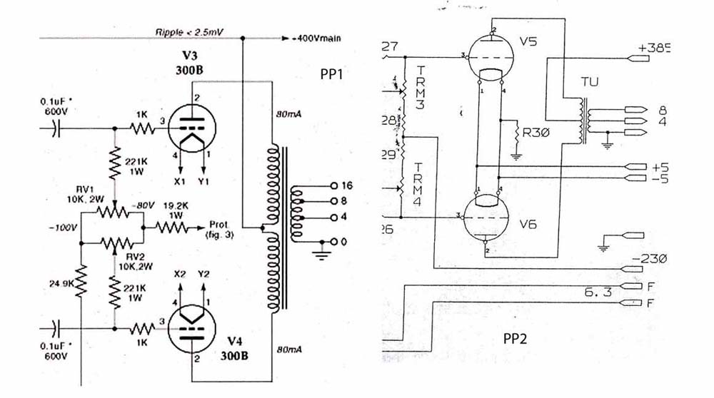

I am building a 300B PP 30W amp using the attached PP1.jpg schematic.
For some reasons I biased it like the attached PP2.jpg using a single regulator for each pair of 300B and a small single resistor (6.8 ohm) to ground them. (the original bias for each 300B was given by an individual AC winding grounded with a 10 ohm resistor as test point for the current.
Well, the PP1 is designed for 30W having 80mA per tube at -80V grid with 400V plate voltage. and the project specs say to adjust the current per tube at 80 mA having the V grid around -82 ...-80V.
The second amp is designed for 20W having 45 mA per tube at -80V grid with 385V plate voltage and the designer recommend to stay around 45mA adjusting the grid bias around -80V.
My PSU gives 394V and all the necessary current but, biasing the grids at -80 I can only have around 45 mA that are far away from the 80 mA originally given by the first amp specs.
What is wrong?
What is the right plate current to be expected with my 394V and -80V?
Any suggestion/explanation is more than welcome.

None of those numbers smell quite right.
There will be w-i-d-e variation between WE-300s from different factories, different decades, and different amounts of wear.
http://www.mif.pg.gda.pl/homepages/frank/sheets/136/3/300A.pdf on page 5 shows WE's official plots, for what they are worth. (This is for 300A, but 300B is a different base-lock on the same tube.)
In practice: you apply your B+ and then adjust the grid voltage to whatever value is needed to set the desired current. In SET use, you often want to run the current up until the plate is not-quite overheating. In push-pull, you usually set for 50%-90% of the current that would exceed plate dissipation rating.

300B curves say that you should have 100mA with 400V at the plate and -80V at the grid. May I ask how you measure the plate current?
A1: no grid current and plate current flowing even with no input signal
If you lower the anode current you move towards class AB, while decreasing the bias (i.e. going up to -0V grid bias) you enter class A2 with grid currents. I believe 300B does not like A2.
You can get more power out of the tubes in AB. Power depends on the output tranny BTW, I believe you can get +20W out of the 300Bs with this bias.

If I looked at the first schema I'd see 80mA for each tube biased at 400V (minus the voltage drop in the tranny) and -80V at the grid and that point is on the WE plate curve. (I cant understand why they use such a large grid leak resistor, 221K, with grid bias?!)
Again if you set the bias at -90v with 400V at the plate you shoud have something like 45mA running through the tube. I don't know what that mag was looking at but its suggested bias seems to exceed the typical +/-10% difference from the 300B WE curves (385V,-80V, 65mA).
I am sure you double checked the bias voltage ... but, as I am reading a -230V on the rail feeding the bias (2nd schema) :bigeyes: , probably a complete schematics with some values may help.

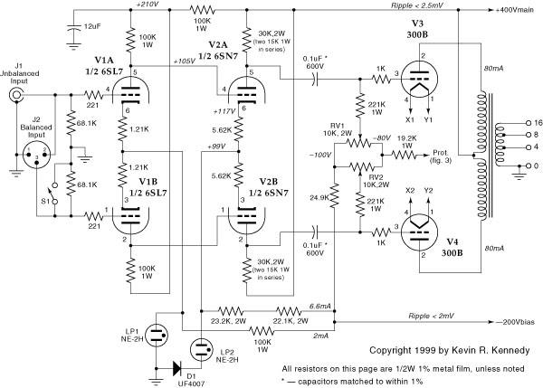

Ciao Gianluca,
attached you will find the amp I built.
The bias I have chosen comes out from the second schematic, yje one wher they recommend 385/-80/45 mA that is what I get out of my amp wher I should have 80 mA per tube with -80 V grid. This is what I do not understand, since I am biasing 394V, -80V and I only have 40-45 mA per tube ... 🙁

That bias and set-up, from the last pic I mean, sounds familiar to me. May I ask if you measured the voltage diff between the grid and the cathode directly at the pins of the tube (or cathode resistor)?
Just to be 100% sure I would measure the resistance of each winding of the primaries' OPT, power up the amp and look at the voltage drop across them (ie. between B+ and the plate of each tube) ... this way you can easily measure the current for each 300B (separately).

Hello Gianluca,
yes, I doubled and triple checked the values, they are correct.
To have 55-60 mA per tube I have to go down to -70...-72V.
