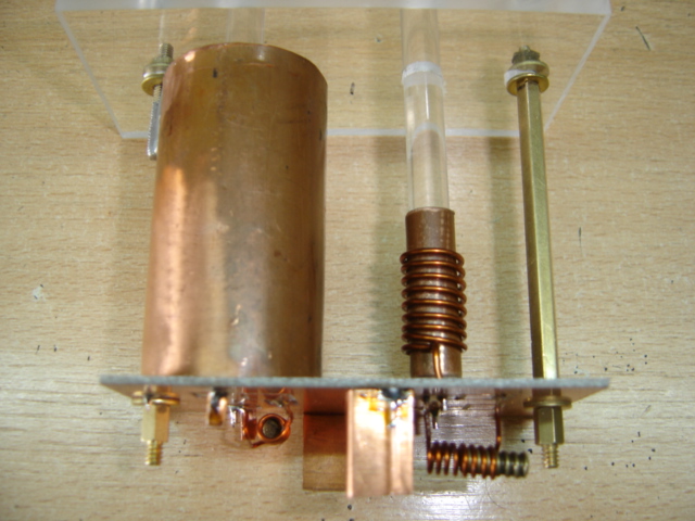

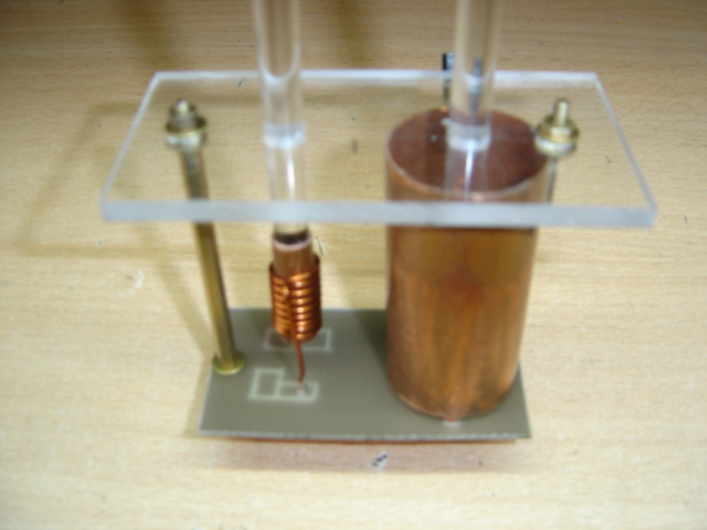

The same line of reasoning applies to other things. I'm mulling a copper tubing permeability FM receiver with tubes and with big coils and PCB's, contrarily to the enormous majority of varicap and synthesized minute FM tuners. This is the RF tuned circuit, still under development.
