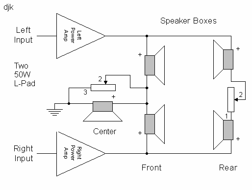

If my center was a flat load, I'd wanted to try a mono center (can be done passively). The negative speaker wires together, run through center with an l-pad around it (otherwise it will be 6db too loud).

Look at the front wiring in the picture below for an instant understanding.
