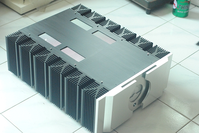

This is the biggest, the meanest and the heaviest DIY amp box I've ever made for a friend, needless to say that he is a Pass fan, so do I :), made only one and that tile is 30x30cm btw..Thank you mr Pass for inspiration, I hope you don't mind

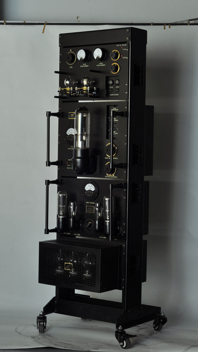

Looks like Dr. Frankenstein should have invested in some non-marking wheels for his super tube amp thingy...
