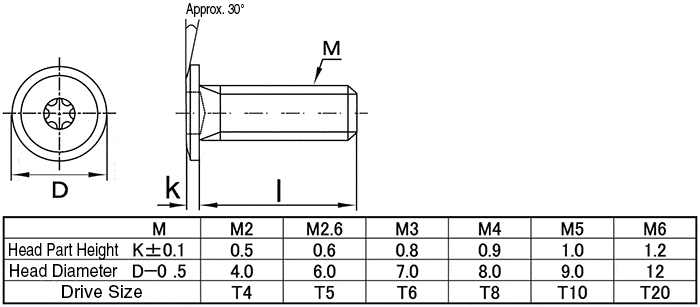

It seems that M6 is the closest compatible with that flat recess. An M6 slim head is probably slim enough.

I was searching for smaller but M6 may be good
You need some serious grunt in a hand/gravity driven press to form a shape that deep in >1.0mm steel if the diameter exceeds 20mm.
Suppose that a new enclosure for an amplifier was needed. Then 1 mm steel would be sturdy enough, and 6 mm screws would hold the bits together. If the screws had slim heads, then the diameter of the flat recess should be 12 mm. The depth of the recess needs not be more than 2 mm.
