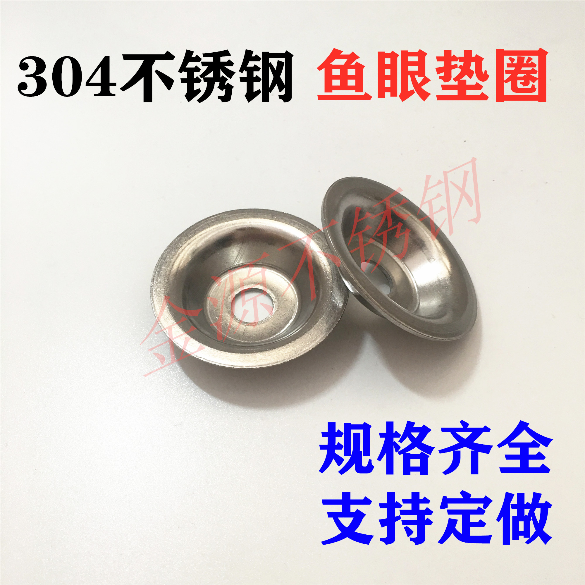

What is the name of this little component?
I noticed this on a Chinese page, but although I know how useful this component would be, I don't know its name. It would be easier to find more of them if I knew. And yes, I tried.
I think it would be very useful in constructing metal enclosures for electronics, such as amplifiers, CD players, etc.
Another interesting would be a tool that presses a similar shape into sheet metal.

You MUST give us more, such as ... ummmm .... dimensions.
If 8/10 mm diameter they may be cup washers.
If 50/100 mm, unfinished Tweeter frames.
If 300/400 mm, car wheel hubs.
And so on.
Also a direct link to page and some ,legible text.

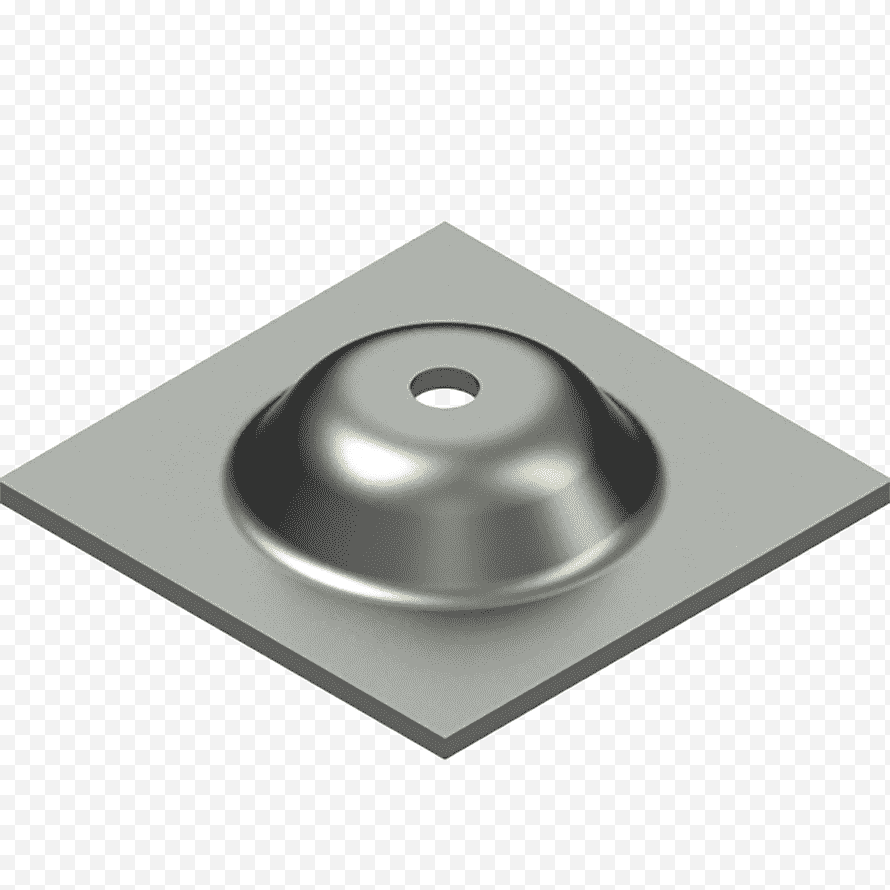

What is this tool?
I have another question: What is the name of a tool that stamps that kind of tiny cup shapes around a hole?
There are small and handy metal punch tools that punch nice round holes through metal sheets, so I thought there may be very much resembling tools that stamp tiny cups into metal sheet.
The cup washer may be a good product, no doubt. On the other hand with a correct tool a hobbyist could avoid such washers, and the metal case would look cleaner without them.
That would be a simple tool for a simple task.
Punch and die sets.
Just as an example, these
cut custom washers out of sheet metal, the thin ones make the central hole,the larger ones cut the "donut" out of sheet metal, you want a set which has no sharp edges but is rounded (matching male and female sides of course) soy you push metal into nice rounded cups with the proper hole in the middle.
These are mounted in a mechanical press for high production:
h
Or a lever operated bench type one (what I use) for prototype or small scale work:
Remember needed pressure is measured in TONS, no flimsy hand pressed thingies here.
You may kludge one having a male punch and female die set made at a metallurgical shop and using a 2 to 5 kg mace to do the pushing in.
Not kidding.
You´re welcome.

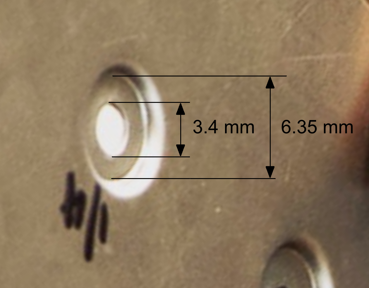

Recession dimensions
I think that the 1/4 inch tool could be useful because M3 screw head diameter is usually 5.5 mm or 6 mm. But the height of the head could be something like 1.8 mm to 2.4 mm, and there may be also some special slim heads too. The screw head should disappear completely in the recession, so that the head could not accidentally scratch some random surface.
So the 6.35 mm diameter of the flat recession would be quite okay, but then the depth should be at least 1.8 mm. I don't know is it that much.
