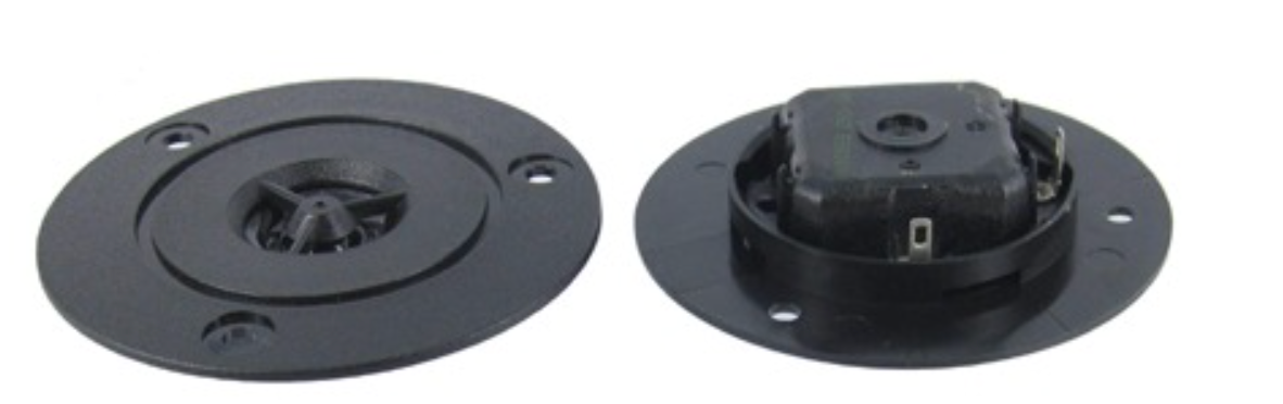

The audax TW025A0 is a great cheap soft dome. It was used alot in Germany when I grew up in the 70s and 80s.

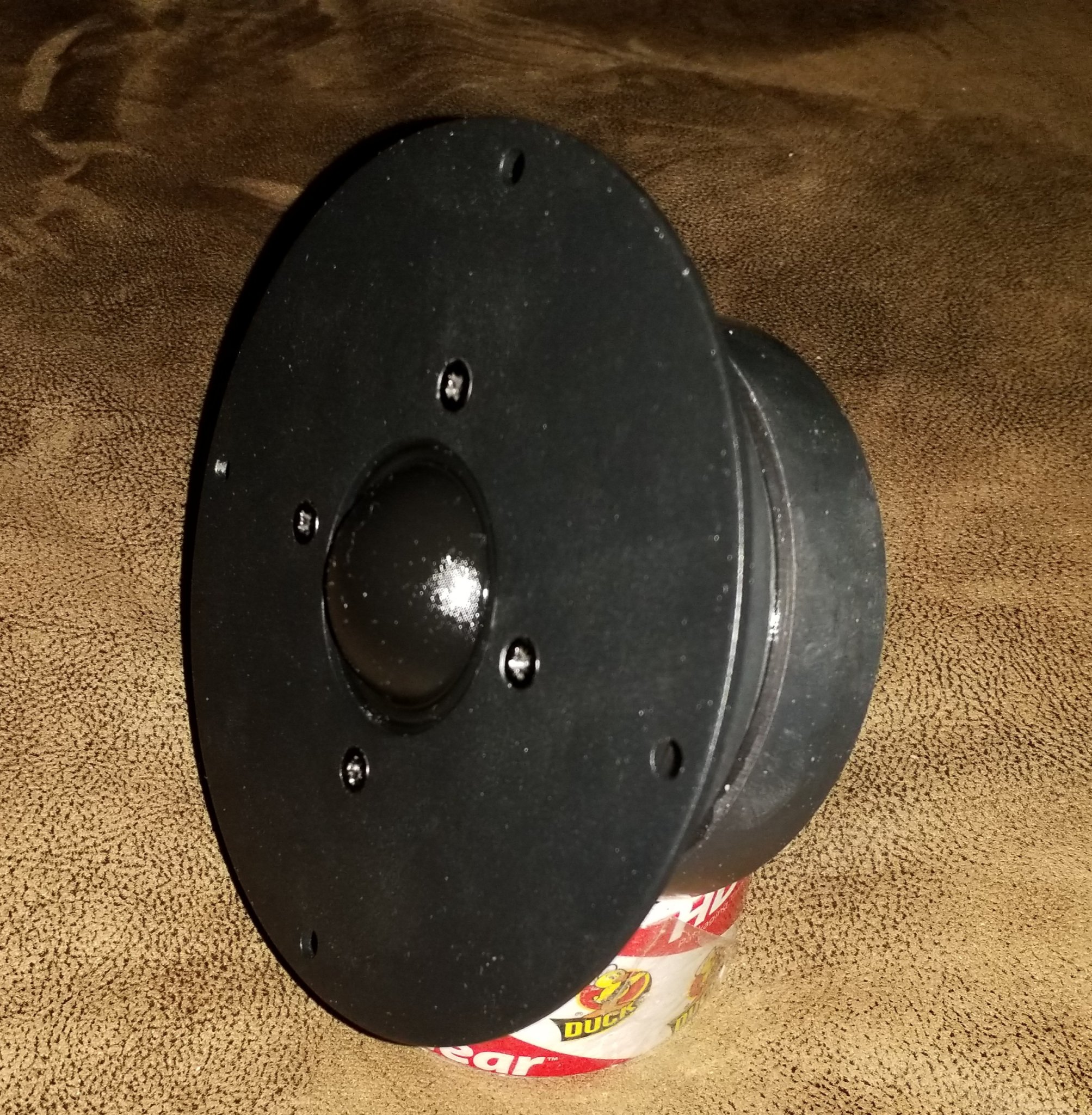

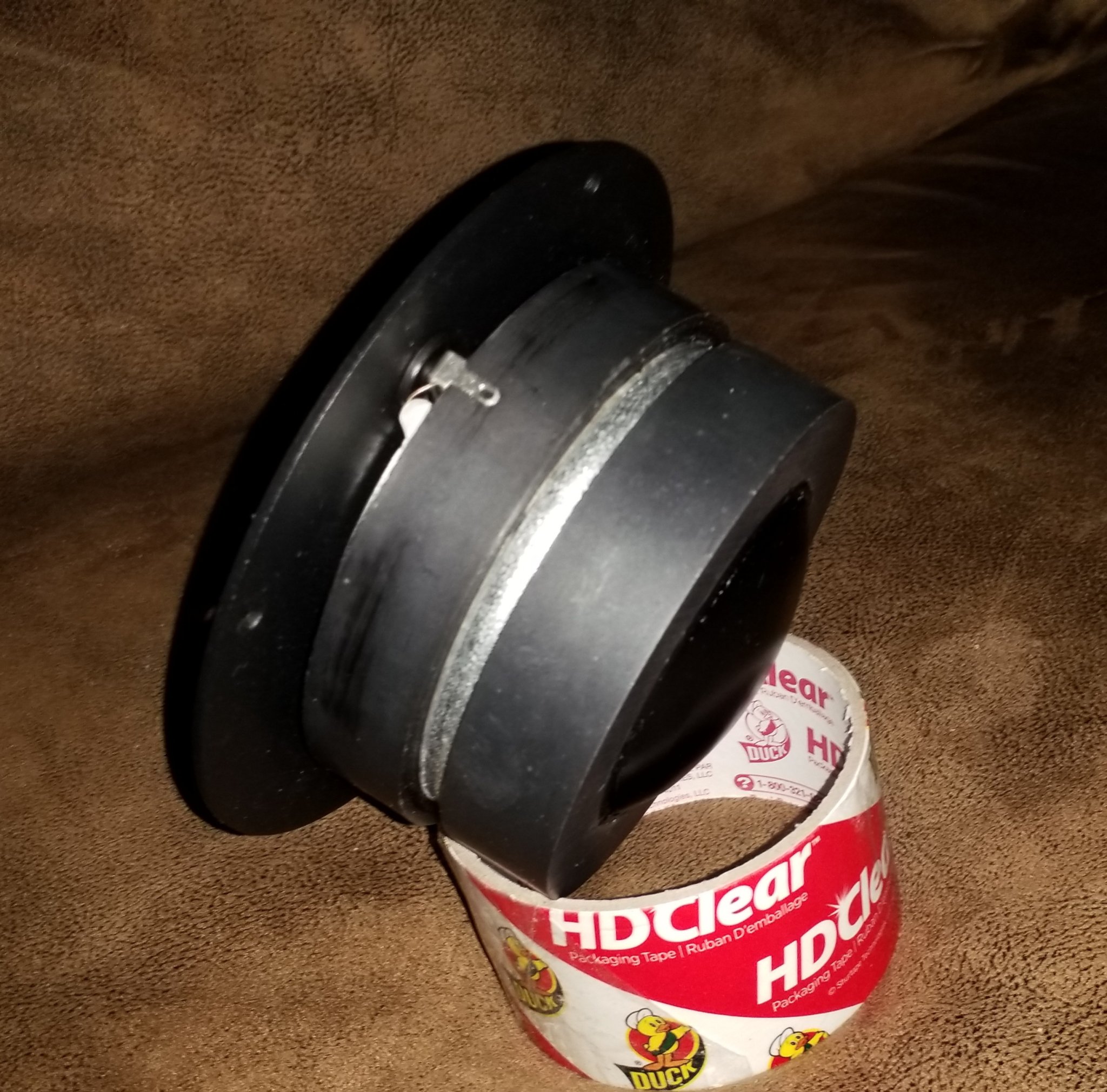

The TW034XO is another great one when used correctly. It plays loud and very clear with the right passive network. I usually take these one step further adding another magnet, opening the pole piece and extra dampening. It fixes the weird resonance around 2k.

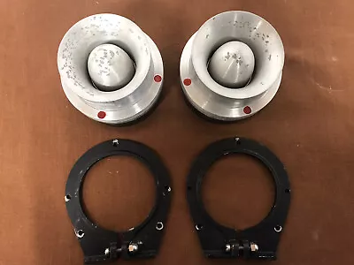

I think the best tweets ever made, or the most desired by all fans of hifi, are the JBL 075/077 tweets, and their variants. While it is an old design, it is one that really has not been superseded. The reason being, it is one that can be used in home or pro audio, puts out a lot of sound, it is rather directional and stays quite linear, but using the deflectors that they made can be diffused quite effectively for a small space, and with the various kits made for them, can handle any and every type of need for high end, and tailored to fit any the system. Otherwise I do agree that paper tweeters are arguably the easiest and most readily available, and there's really nothing wrong with them other than their limitations in output. But they actually can be everything you need as well.
Is that resonance what Troels wanted to dampen by adding damping material behind the dome? I remember that after a lot of work he came to the conclusion that it was not worth the trouble to "get involved". Unfortunately, the TG website is excellent, but it suffers from a major flaw, it doesn't have a search engine, and finding each topic he addresses is a real pain.....
By the way, it's a great tweeter and adding a waveguide - if necessary - (as in the case of my DTQWTII), it has a very wide directivity and a very natural tonality. To my ears, which are somewhat worn, but I still enjoy it very much!
I agree, it was used by JBL in the Paragon and many years later Hiraga chose it for their speakers, there must be some good reason...
