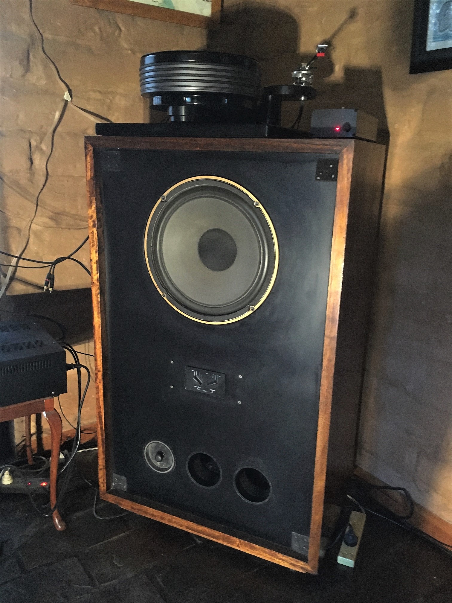

Hi everyone, can you give me some advice on what DIY Pass Lab design would best drive a set of Tannoy Dual concentric 15" Arden style speakers 92db efficiency in a medium size room. Currently using a 15W valve amp typical music levels and listen to SPL of 95db max at listening position. My preamp has a voltage gain of approximately 2 and I use a phone stage so need an amp with input sensitivity of around 1V for full power.
Cheers Johno
Thanks for the feedback, many choices suggested so can we drill down please.
Drivers are 8ohm, Alnico HPD385 (15" diameter) in good working order.
Enclosures are 320L built by Scott Krix (Krix Loudspeakers in Australia) around 1978.
Agree you do not need many watts particularly in a medium size room.
So, the amp will need an input sensitivity of around 1V to compliment my preamp & phono stage.

You say you, "need an amp with input sensitivity of around 1V for full power." You've included that spec twice, so I assume it's important to you.
Can you provide a bit more insight re: why you chose that spec? You've stated the same definition I use (voltage at input to reach full power at output), but .... I admit that don't understand why you want it 'so low' at 1V.
Correct, I have a phono stage that outputs around 500mV and a low gain line stage with a voltage gain of 2 so it appears none of the FW designs meet my upstream requirements. That's fine thank you for the clarification.
Thank you for clarifying. I see where you're coming from, but you don't necessarily need the (any) amp to output full power at 1V input though.
You just need 'enough' power at the output with 1V at the input to make you 'happy', correct? I'd think that some FW amps might just do the trick. No sure how exact the sensitivity of your speakers is and how far you sit away, but it'd be 'close enough' for me to still consider that a FW amp might get you to 95dB at your listening position with it "cranked".
However, a higher gain amp would definitely be required to fit your 1V input sensitivity criteria. See the specs Dennis linked, and you can do some math to see if you're willing to give it a go.

In OP's case, ~7dB gain and ~5W would be enough for 95dB spl. There is a nice calculator that gives you a ballpark

say Aleph J
25W@8R
means 14.14Vrms at output for max power@8R
original gain of Aleph J is 10V/V. which is 20db, meaning that for full power it demands 1.41Vrms at input
scenario - make Aleph J with ultrasimplesuperduperabrakadabra kit set which is soon going to be in Store, as Boyz are saying
in very unlikely case of feeling that Aleph is not getting to enough ooomph to clip properly feeding Ardens, it's super easy to elevate gain slightly. to make situation better
realistically - Arden box is lousy, original xover is lousy ( schematic and values Made by Gods, but beancounters in Factory crippled it in physical realm), DC driver (when mint) is also Made by Gods; verdict - it'll sing as never before, with Aleph J
forgot internet myths about Tannoy synergy with Accuphase and Luxman integrates .... those are Fairytales for poor bstrds not knowing better, not being able to make it better and not being able to find this place
been there, done that, believing in all Synergy BS; though - in Yore, situation was clearer - Myths were spread by people having some commercial agendas, while nowadays - ppl are doing the same just for the sake of gaining some doubtful online credibility - everyone is havin' relieve holes, and opinion
:rofl:
edit: with 1Vrms you have on disposal now, Aleph J will put 10Vrms at output; that's 10V^2/8R=12W5
perfect for start, easy to build up
