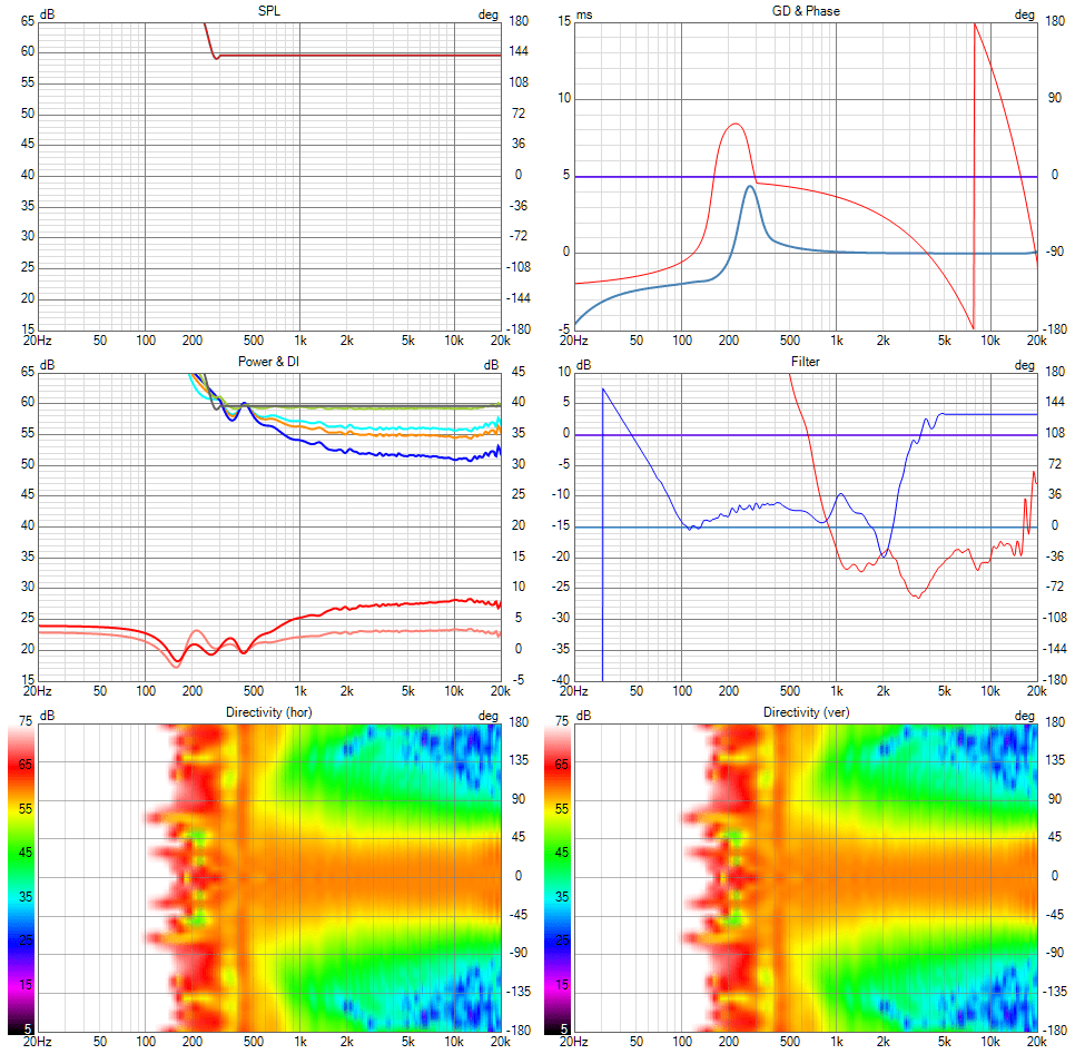

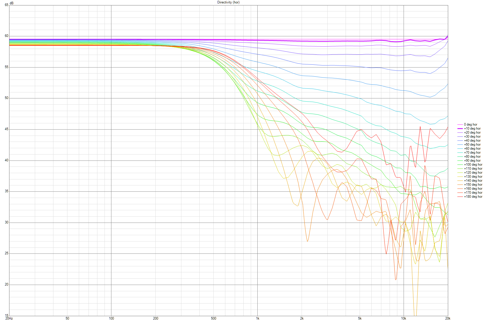

I was in the same boat several months ago. I don't know how to use AKABAK but I simulated my drivers/enclosure in ABEC then exported FRD files to simulate the crossovers in VituixCAD. Alternatively, you can physically build and measure the drivers in REW or other measurement software and import those files into VituixCAD. Once you have your FRD files in VituixCAD you can simulate different crossovers. If you physically build the speaker you can also listen to the different crossover options by exporting files from VituixCAD into a program such as Equalizer APO (Windows) and individually amplifying each driver via an audio interface or home theater receiver connected by your PC outputs. That's the method that worked out best for me personally but it is far from the only method available.
First image is from VituixCAD from FRD files simulated in ABEC. Second image is from real measurements taken in REW and imported into VituixCAD. The REW measurements are wrong because I measured in 10 degree increments rather than 5 degree increments that VituixCAD instructions require when you measure speakers with higher directivity (waveguides).

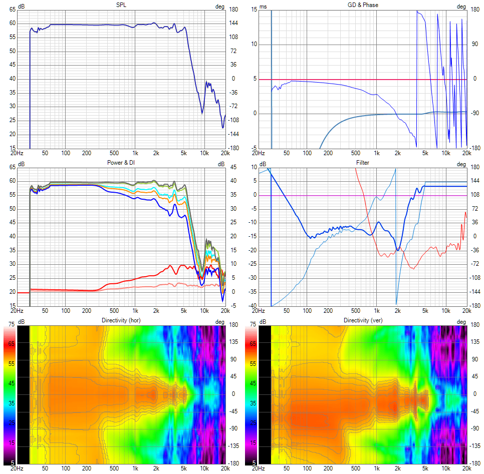

To give you a basic idea of where you might look for places to cross, here are the independent measurements of my woofer and tweeter flattened on-axis.
Tweeter vs Woofer
I'm still in learning phase so I bet other people could show you much better VituixCAD simulations to show you what to look for. Which reminds me of something. If you go to the trouble of learning VituixCAD and importing your measurements it is an excellent way to receive help with your speakers because you can show your images like I just did. ABEC simulation isn't necessary but it helped me discover my measurements were bad. Simulation also helped me rapidly iterate designs.

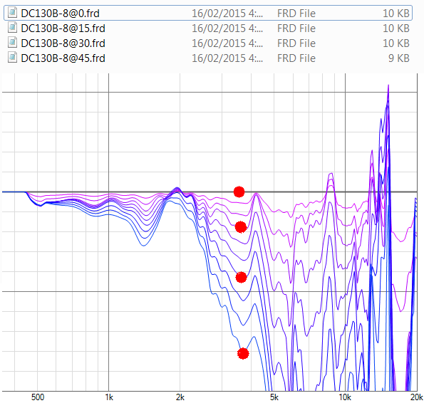

It appears from observation that Vituixcad interpolates the intervening angles. Some of the internals of Vituixcad are not clear, so I'm not sure, but I'm inclined to disagree with your usage of the word 'wrong', when lower resolution might be a more fitting way to describe it.The REW measurements are wrong because I measured in 10 degree increments rather than 5 degree increments that VituixCAD instructions require
You're right. I didn't check the woofer, only waveguide portion. Here's a post in the ATH thread showing the difference between using 5 degree vs 10 degree vs the simulation. Albeit, with different microphones. I still haven't confirmed with my XLR microphone but now that I think about it I should probably simulate the waveguide using 10 degree increments rather than 5 and see what happens in VituixCAD.
https://www.diyaudio.com/community/...-design-the-easy-way-ath4.338806/post-7503817

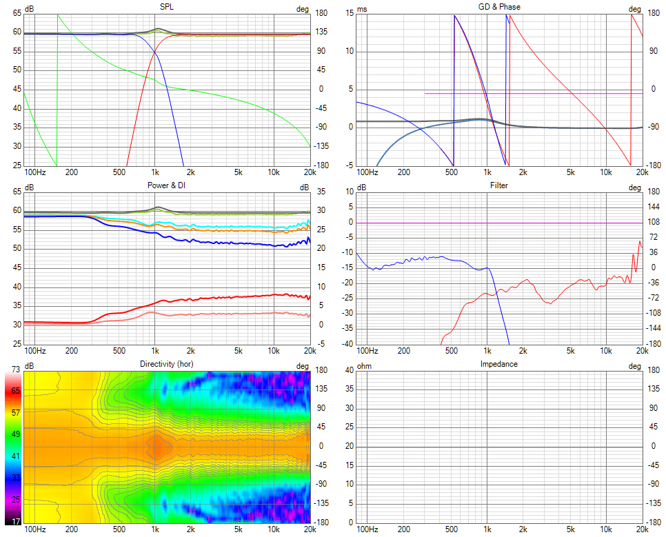

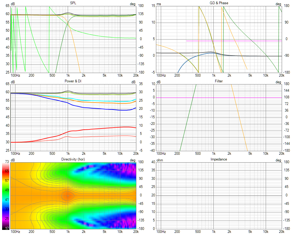

I just imported a set of 10 degree increments from the simulation (deleted the FRD files between every 10 degrees and then imported them as a separate driver). There's a little bit of difference but not much compared to the difference from my two sets of REW measurements. Of course, my two REW measurements are a lot more ragged. I guess the next step would be to take my original 5 degree REW measurements and delete every other measurement to see what happens when I only supply VituixCAD with 10 degrees from that set.
Simulations: 2.5 degree vs 10 degree
