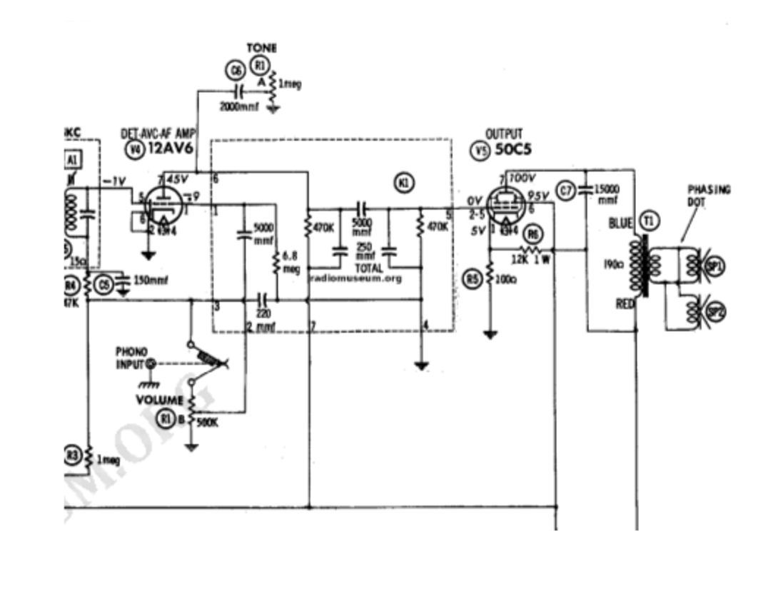

What is the main purpose of this module?
I am playing with an AA5 type radio - Sears Silvertone 7013, CH 132.40100.
I have downloaded the schematic and found in the AF section between the 12AV6 and 50C5, there is a module (like an earlier version of IC indicated as a rectangular dotted line). The module is a network of R/C. I opened the radio and confirmed there is indeed such as physical module.
There is nothing special about the components inside, only Rs and Cs. I have a few tube radios and this is the only one having such a module. I wonder what is the main purpose of using it instead of discrete components. I tried google but nothing come up, maybe I used the wrong term for searching. After all, I have no idea what it is called.....

There were several brands of radios, HiFi and even some TV sets that took some of their standard passive circuitry and made it into a custom circuit module. I always assumed the the true motive was to sell replacement parts, or insure that the unit would be brought to one of their authorized service centers for repair.
The early versions of these modules had small discrete components inside and the whole thing was coated in a brown resin or plastic case. Later on the resistors were screen printed on to the substrate, but the capacitors were discrete parts. By the late 60's all or most the passive components were screen printed on the substrate.
I started my 41 year engineering career at a Motorola plant in 1973. The plant would start a microelectronics operation in about 1975 manufacturing these modules for their two way radios. It would encompass about half the plant by the early 80's, and be completely gone by the 90's due to the advances in SMT (Surface Mount Technology).
The modules that were screen printed with conductive, resistive, or dielectric ink were called Thick Film Hybrids, or just Thick Film.
There were also some modules that used vapor deposition and electroplating to deposit the metals. These were used for high frequency RF circuitry where more precision was needed. These were Thin Film Hybrids or just Thin Film.
Different manufacturers often used different terminology for these devices, and their designs and manufacturing technology varied widely depending on the driving factors involved. We built "Mission Critical" (a person's life may depend on it working) two way radios for police fire and military applications.....cost was NOT a factor. Often cost is the primary factor in consumer grade electronics.
Before joining Motorola I was a service tech at an Olson's Electronics store. Those modules were the biggest failure in some products, and number two behind output transistors overall.
