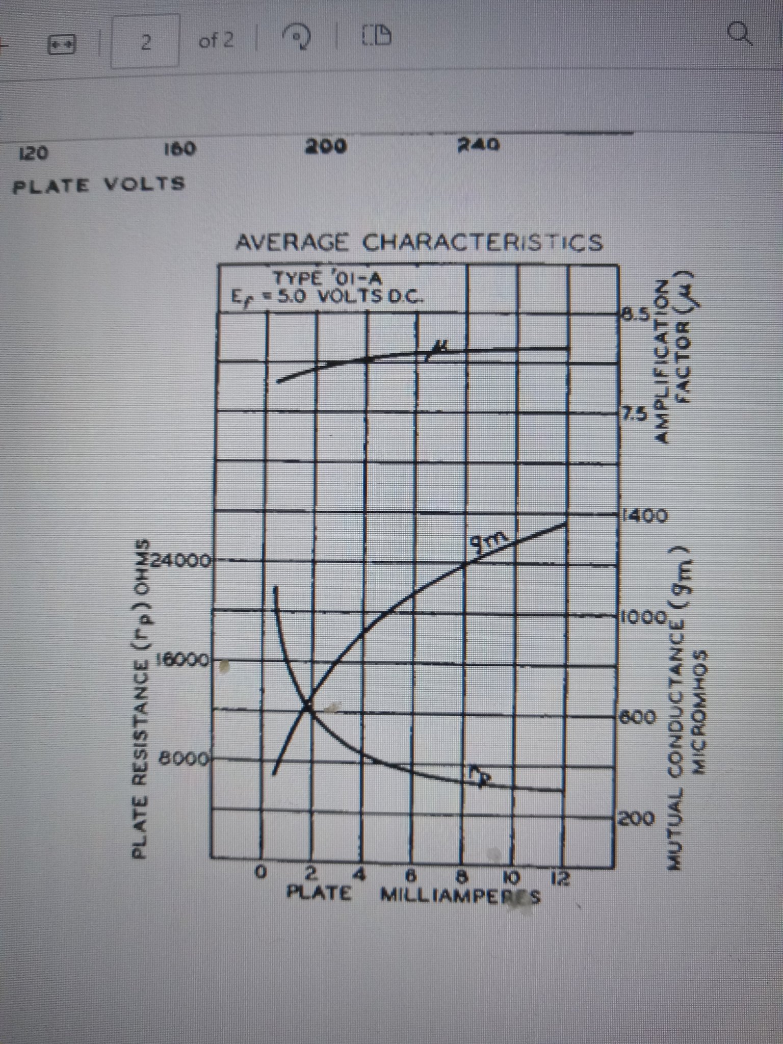

Rod - I don't understand "low and stable Ra".
Looking at 01A data sheet, Ra change is quite dramatic through Ik range. This is intrinsic for any triode, DH or IDH.
Re. uniformity of grid control over cathode length, Russian rod tubes are perfectly uniform.

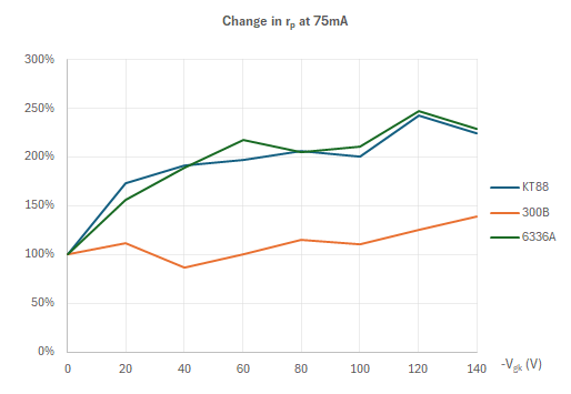

I have attached a chart showing changes in rp for three power triodes. The data was derived from the data sheets for:
  • the directly heated 300B using plate curves from the WE datasheet;
  • the indirectly heated KT88 using the triode-connected plate curves from the Svetlana datasheet; and
  • the indirectly heated 6336A using the plate curves from the Raytheon data sheet.
I used the data sheets to estimate rp at a constant 75mA anode current at each plate curve from Vgk=0V through to Vgk=-140V at each 20V interval. The estimates of rp were then expressed as a percentage of rp at Vgk=0V for each triode.
The estimates plotted in the chart show that rp for the directly heated 300B remains more constant than rp for the indirectly heated KT88 and 6336A.
The 300B holds rp steadier at the extremes of grid voltage (toward Vgk=0V and Vgk=-140V). On the basis of the data from the data sheets, if each triode was operated at Vgk=-70V and ia=75mA:
  • there is little difference in the rate of variation of rp for each of the triodes over the range Vgk=-20V to Vgk=-120V (that is, swinging 50V either side of the bias point);
  • which implies that, if variation in rp is the criterion in question, there would be little to pick between the three triodes for small signals and moderate signals; and
  • in respect of steady rp, the 300B has an advantage when swinging voltages >50V : that is, when amplifying larger signals including large transient signals.
It was convenient for the purposes of illustration for me to choose to estimate rp at a constant 75mA. I think it unlikely that any builder or designer would use a power triode this way. Practical designs will no doubt consider the load to be driven and select bias conditions accordingly. The actual measured performance (and its sonic performance) depends, as always,on the circuit in which the triode is employed.

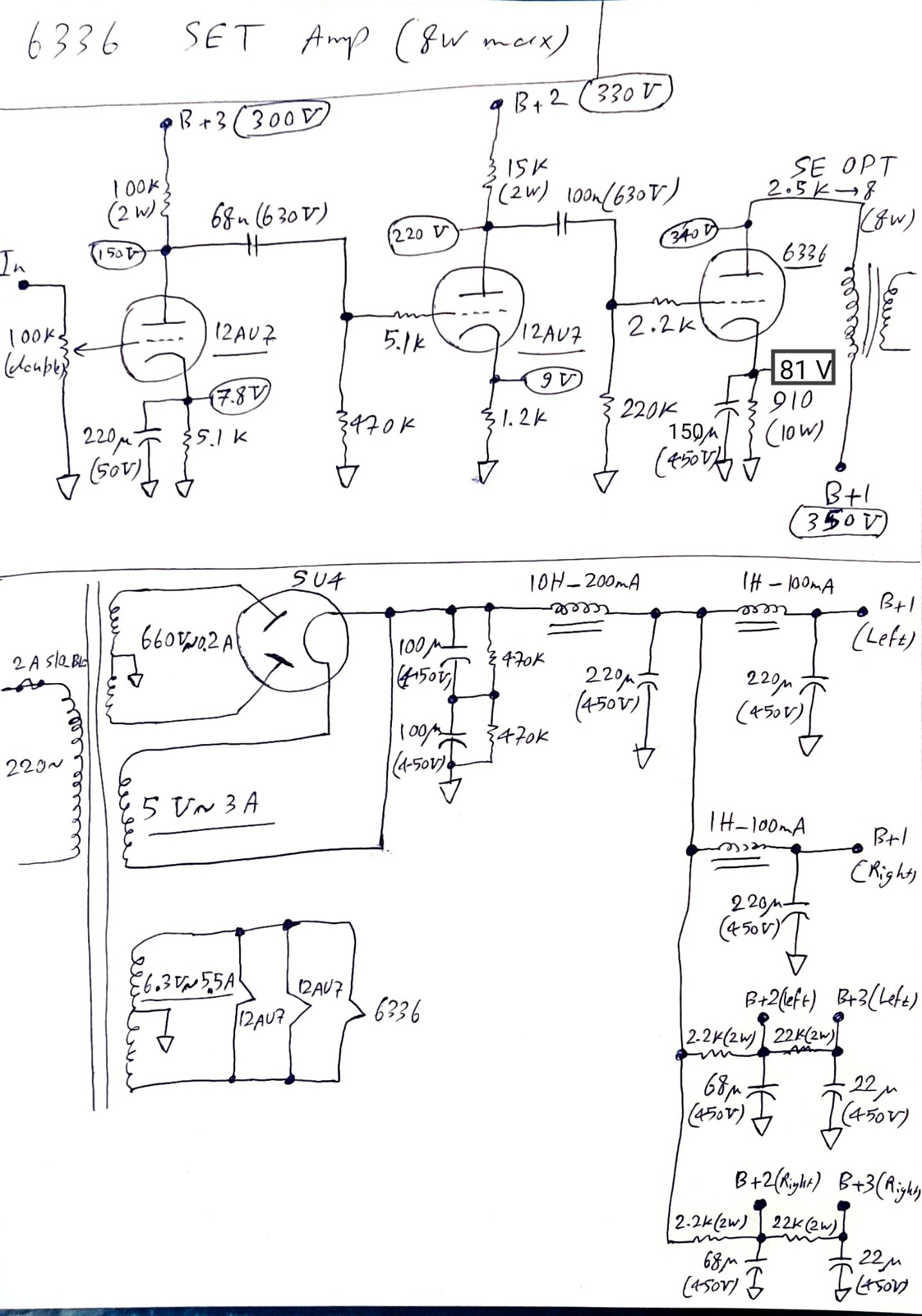

That plus the driver circuit, I was able to get lower than 2.5 percent THD almost all 2nd order with 6336A at 8W using the correct driver.
Care to share the driver information?

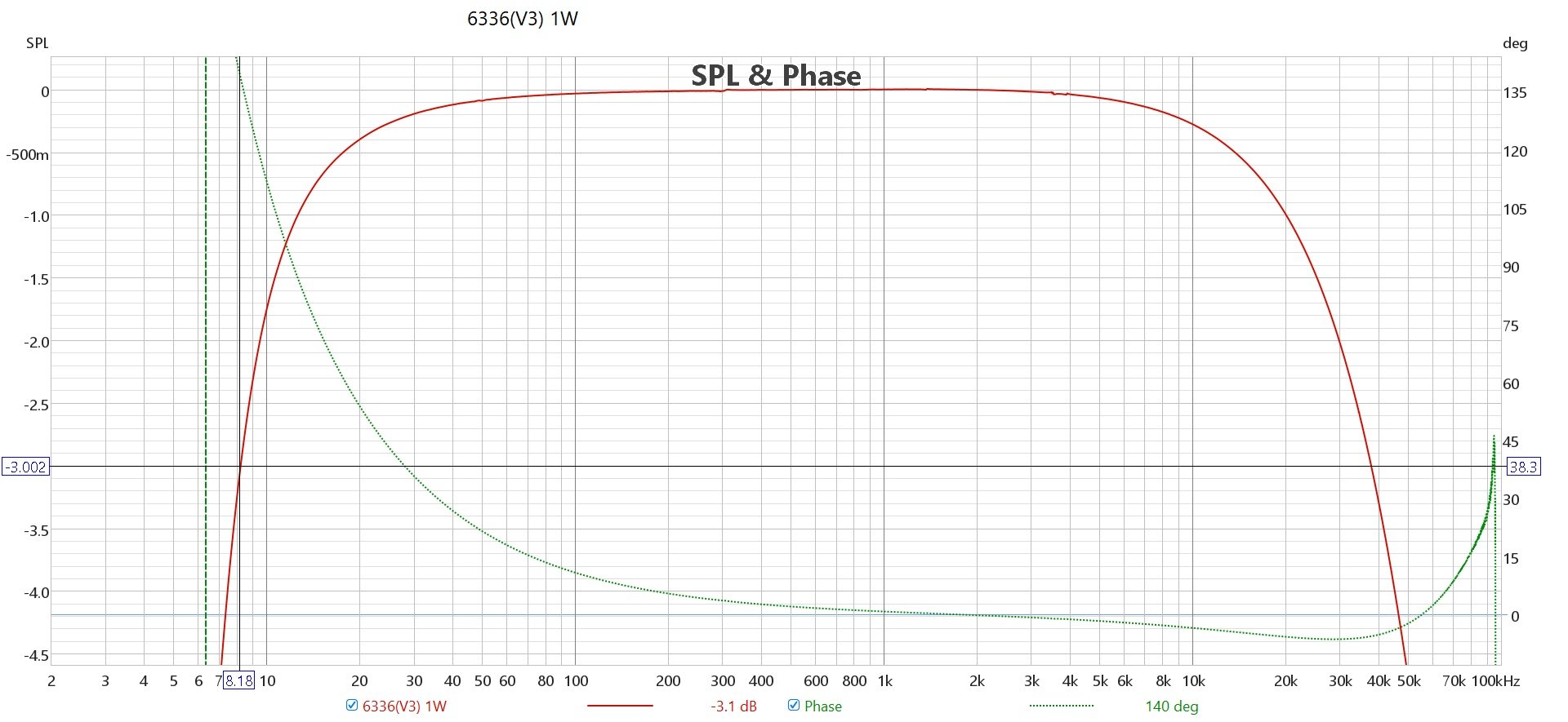

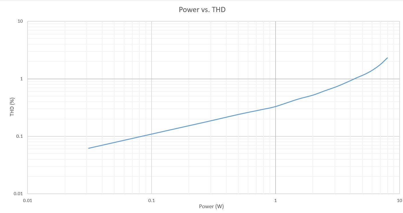

Of course my pleasure, here is the final schematics:
And here is the test results:
This driver is able to produce 90V peak signal at power triode's grid. Based on the loadlines of both 12AU7s and 6336, it should produce a ton of distortion, but somehow it produces even less distortion than my 300b amp with 6SN7 cascode driver, and IMHO the sound is way better!
I wish if someone knowledgeable could give an explanation how most of the distortion got canceled here; because I've searched everywhere and there is only information about distortion cancelation in a cathode follower after the gain stage, both biased at the same point.
