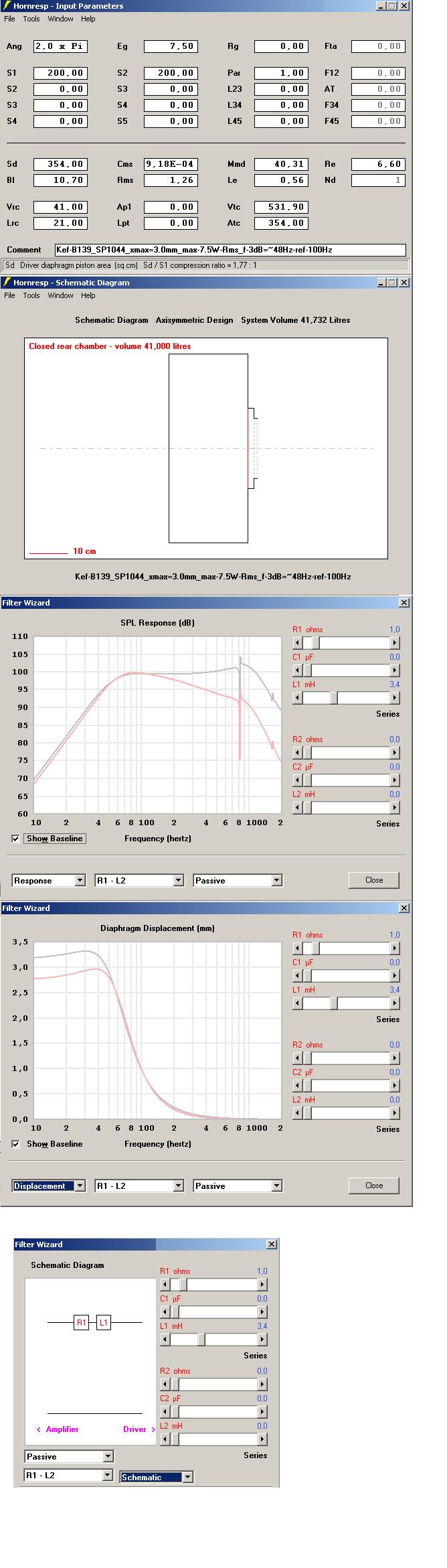

What is the effect of hiding the B139 in the Kef Concord?

Hi, FYI
Might be of use...:
b🙂
PS: Change .txt to .frd extension and the two _wave files to .wav
