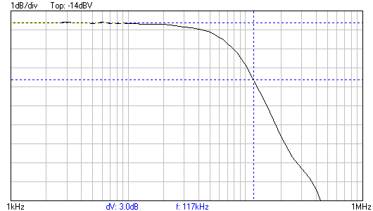

Hi Erik,
the lower you want your lf roll off the more inductance you need which means more turns of wire which, more important than the DCR, increases the interwinding capacitance. The higher the capacitance the earlier your high end will roll off and you also get more problems with ringing.
There is a lot more horrible stuff happening but that's the most important in that context.

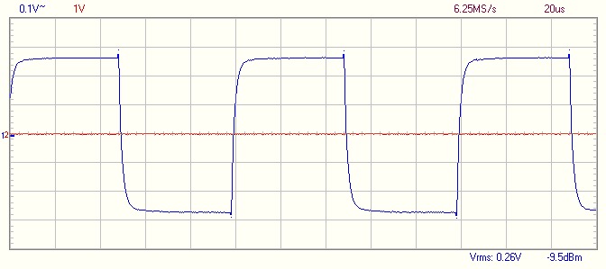

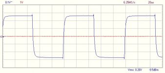

It's all about good design and i think that more transformer manufactures should be more open to give proper datasheet about there transformers.
For instance something like this:
Rp=3700; Rs=8
Copperloss 0,19dB
Frequency response -3dB 8Hz-110kHz (measured with el34 in triode mode)
Hi Erik,
