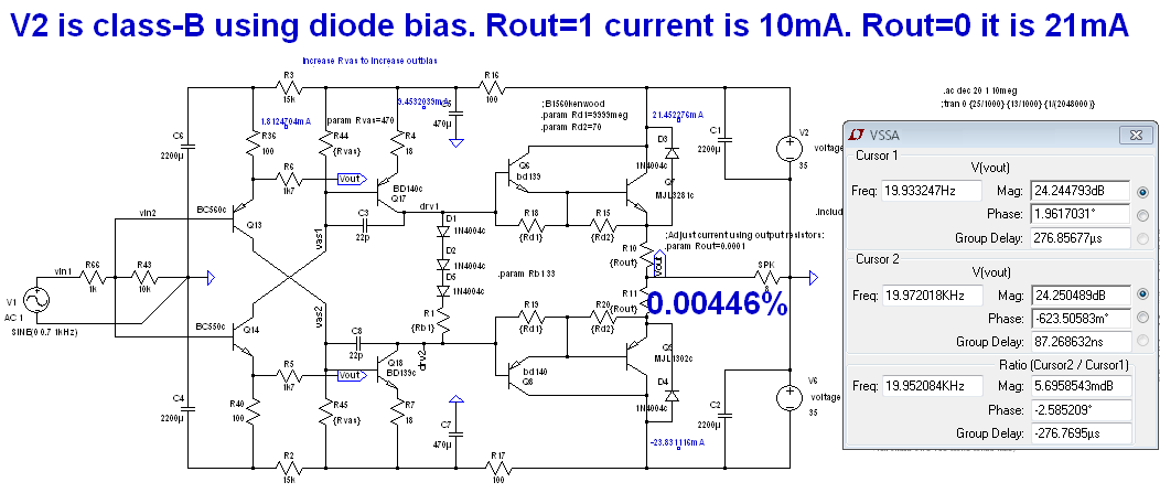

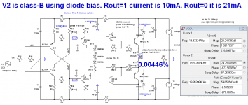

It is important to understand that we need to set an objective first in order to be able to find the right processes (the topology, the parts, etc.). "Best amp" is not specific enough for a design objective. Money, is always an important criteria. If we want the absolute best amp, then be prepared to purchase very high current transformer (and heatsink), matched top quality transistors and many more.
The smallest entity of an amplifier is a transistor. For a good amplifier, good transistors is a must. Unfortunately, transistors are produced for other purposes than audio such that best transistors are usually rare.
We can start from choosing our favorite input transistor. If we want the high impedance and low noise JFET as the input transistor, then the following stages (which dicates the topology chosen) should be designed accordingly. Finding matched P and N channel JFET is hard/expensive, so either SE or LTP left to be used. High trans-conductance JFET is also hard to find, making ordinary JFET design unfavorable, especially when coupled with low trans-conductance output stage and a speaker with low impedance.
LATFETs have very low trans-conductance. It is so low that THD is not usually the first priority when designing with them. The dual LTP is the 'de-facto' topology as advertised by Hitachi (0.01% at 100W). Also the paralleled 2 or 3 pairs. One of the best 'topology' for LATFET is what has been implemented by Goldmund (dual LTP). Equal performance (but probably not similar) can be easily achieved with CFA topology.
BJT transistors have very high trans-conductance. This makes THD the first priority when designing with them. If you can reach 0.001% or below, then do it (it is a must).
Darlington BJTs are unique because they are designed usually not for audio. They are not flexible and not useful unless you already have them on hand. For high current they are 'difficult' to compensate. But because they can run well with very limited current, they can be useful if you need to use small transformer and small heatsink.
From all the topology, I found that CFA is very useful/flexible and can always be used with performance above average.
Below is a quick drawing of a darlington BJT in a CFA topology. It is so rough but the AC performance is so good (CFA has wide bandwidth). The darlington is a Sanken 2SB1560 and its complementary. (I usually use around 19mA of the output stage and 8mA of the driver stage). It is not yet finalized (I haven't even seen the PM/GM) but I will build it, probably starting with the schematic as is.
