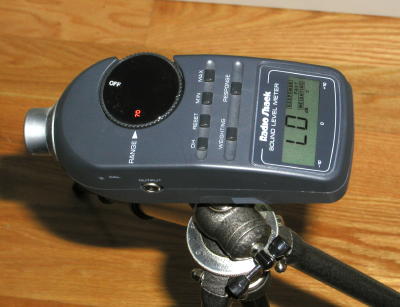

Get yourself a copy of the Stryke Basszone Test CD , it sells for about $10. It has test tones from 10Hz to 20,000 kHz on it and is especially good for testing subs. Next, get yourself a Radio Shack analog SPL meter (cheaper and many claim its easier to read).
Run the test tones and record the SPL levels (set meter to "Average" or "Slow" reading and "C" weighted). Then, add the following correction values to the meter readings (compensate for its limitations):

What you want to see is relatively flat response between 20Hz and 100Hz after applying the correction values listed above. If you have lots of peaks and valleys in your response curve, try different placement of your sub. If moving it around does not even out the response, you can use and EQ to remove peaks, but valleys (null points) are absolutely unaffected by equalization as they are caused by interference patterns of sound reflection.
I'm usually using Sterophile Test CD 2 with 1/3 octave warble tones and Radio Shack meter (Stereophile Magazine is using it too). I also have better mike and better meter but for quick measurements I find it most convenient.:nod:

I didn't know about correction values. It means that my subs have much better response that I thought.
Peter Daniel,
The correction values for the Analog version of the Radio Shack SPL meter have been floating around for years. The microphone on the unit is not sensitive at the extreme low end. As I understand it, the values were determined by a group of folks who compared the Radio Shack unit to professional grade calibrated microphones. I'll dig around a little and see if I can find the original source of the numbers I posted. Keep in mind, unless you do ground plane measurements outside and away from buildings, you are also measuring room gain.

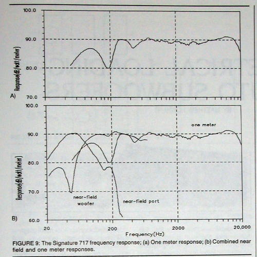

You can do also nearfield test with mike very close to driver (2")and it shows you what driver is producing. If you have additional slots, holes, tunnels in the box you have to measure them too and add the individual responses.

The enclosure is a ported enclosure with 2 Cu Ft. internal volume after displacement for driver and port. I am sorry if I am coming across as stupid or ignorant but Peter Daniel what do you mean by “If you have additional slots, holes, tunnels in the box you have to measure them too and add the individual responses”? I am a little confused by this, what do you mean? I am not sure how to interpret what you said. Do you mean average the entire test results or what?
