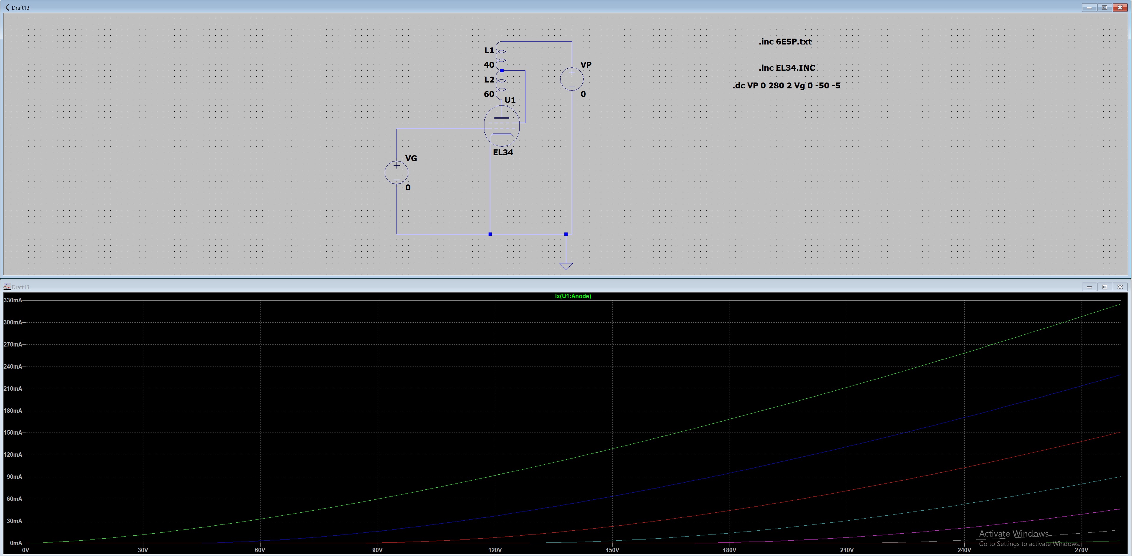

Title basically says it all. Im trying to plot UL curves for various tubes, and my methods aren't quite working. No matter what I do, the current seems to be much lower compared to what people have measured on a curve tracer.
For reference, here is what I am comparing my simulation to The EL34 Tube
