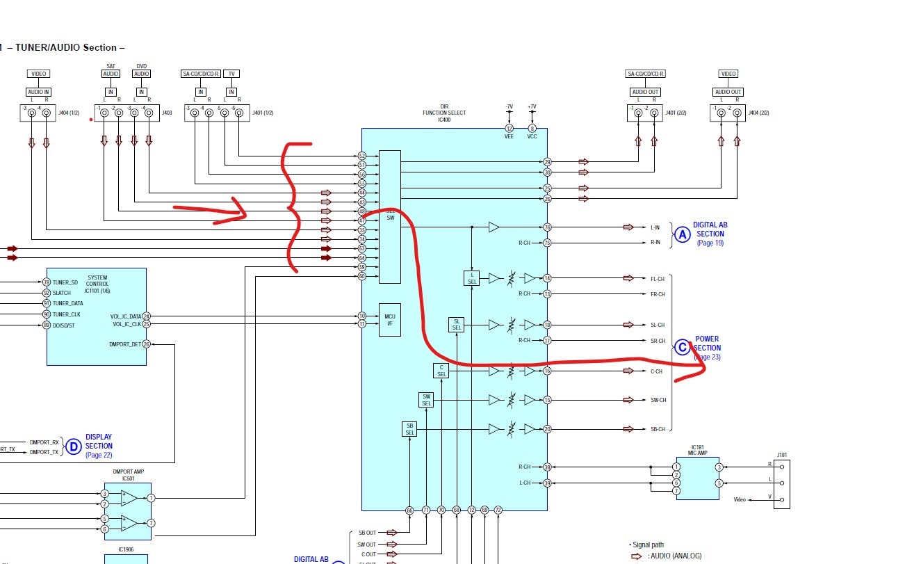

Preamp is IC400, located on Main 2/3, page 27. DAC is IC1452, Digital AB 1/3, page 31. The easiest way to find this is to first reference the block diagrams on page 18 and 19, then find the relevant ICs on the schematic pages. You can then take the part numbers on the schematics and locate them on the PCB drawings located before the schematics.

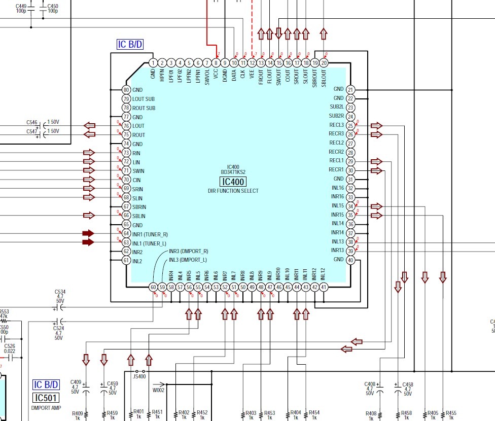

Which pins handle the bass and treble frequency on IC400 And I would like to know how you figured that ic400 is the Pre-amp from service diagram
It is one complex product, that is why I said you needed the service manual. Everything looks to be handled by dedicated LSI (large scale integration) chips). It is hard to decipher it all but the audio processing appears to be done in IC 400, not that that helps much 🙁I downloaded the service diagram for my Sony STR-KM 5500 home theatre amplifier but cannot find the Pre-amp section
According to the datasheet for the IC, none of the pins handle it (See attachment). The pre amp IC essentially only performs input selection and volume control. All EQ must be handled purely in the digital domain by the DSP, IC1501.Which pins handle the bass and treble frequency on IC400 And I would like to know how you figured that ic400 is the Pre-amp from service diagram
How I found it is I have looked at a lot of AVR service manuals so I knew basically where to look and knew what that IC was based on its name. But when I was first learning I would trace the signal from speaker outputs, back through the power amp, and then see what came immediately before the power amp. I would look up the IC data sheets to determine their functions (or look at the IC block diagram in the service manual).

Thank You Sir I think things are different on home theater digital that everything is handle by ic pleasure god bless you sirAccording to the datasheet for the IC, none of the pins handle it (See attachment). The pre amp IC essentially only performs input selection and volume control. All EQ must be handled purely in the digital domain by the DSP, IC1501.
