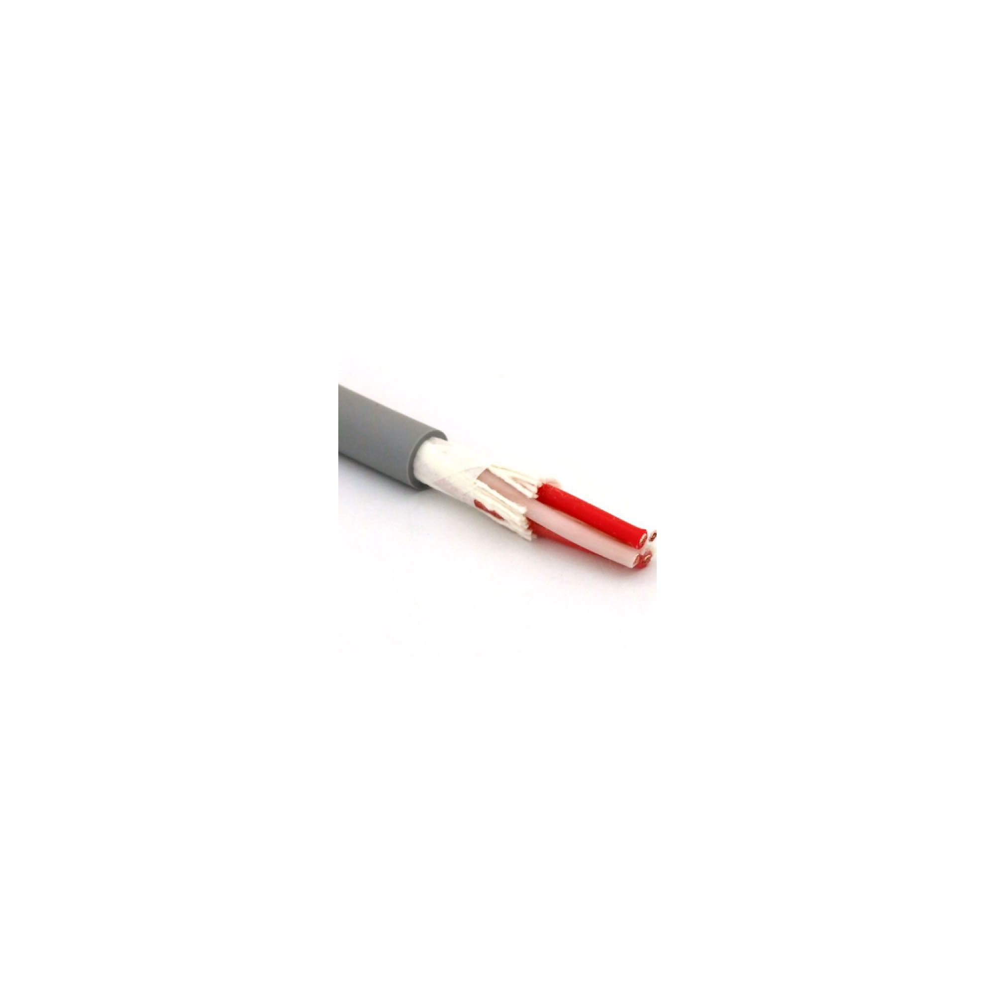

Yes, another cable thread - but this one has the intention to see it from the technical sight and was therefore originally posted in the amplifiers forum.
Thanks to you all so far for your answers - even if they are mostly subjectivists view.
to summarize it: none of you really uses shielded cable and it looks like the starquad configuration is the way to go. To that i found a video on youtube that demonstrates the difference between a standard microphone cable and a starquad one (think it was the manufacturer benchmark). I think their findings can be also transferred to speaker cable.
Does anyone of you use ferrite clipped on the speaker cable?
I haven't played with ferrites clipped to speaker cables. I would think it not normally necessary, however I would not suggest it can't do something; it really depends on the circumstances and the design of the attached equipment. Many items of electronics respond in ways that seem to some people to impossible or ridiculous, because the behaviour of any individual piece of gear defies simple understanding.
I wish so much when OPs or responders use a seemingly arbitrary label like "starquad" that they would say clearly what it actually is - and not assume everyone knows what they're talking about.
Is it a brand? Is it a "configuration"; like a way wires get hooked up? Or assembled into a long, skinny structure? "Quad" seems to imply 4 of something.
"Star" seems to imply a grounding method. I cant for the life of me...
Then microphones gets mentioned. What does that have to do with how speaker cables sound? What's good for the goose?

Whilst it is certainly true that microphones and loudspeakers are different applications therefore subject to different degradations, the electrons in a conductor don't really care what they are being harnessed for. Current flow and its associated electromagnetic phenomena don't change whether its a microphone or speaker any more than if it's classical music or punk. Knowing what properties are important to a given application and correctly applying them is the key. Most professional cable manufacturers including Belden (US), Canare (Japan), Klotz (Germany), Eurocable (Italy), etc make a star-quad speaker cable. It's up to the user to determine if that property is important for their application.
well I think there is a difference not from the electrons flowing, but from the level (5mV MM or Mic) and impedance.
In a speaker cable the level is 20V and very low output impedance.
An external field induction will be attenuated by the low impedance and the level is a lot below the 20V
Now when the impedance is high a much higher voltage gets coupled and it is only 5mV level.
So it is completely unnecessary to shield speaker lines
It will do more harm by adding hundreds of pF as output load.

It would be the conductor thickness for speaker cable. Cheap cables can do the job fine as long as it's thick enough.
^^^^^^^^ THAT.
At the short distances involved in "normal" amp to speaker setups, capacitance or inductance have no practical effect, and minimizing resistance is nice, although not to obsess about.
0.2 ohm is nothing to worry about and of course 0.02 or even 0.002 ohm is fine as long as it does not require forearm thick copper bars.
On the other side, needlessly multiplying capacitance shown by a regular parallel pair by 10 - 100 - 1000 X is worrying.
As long as speakers are not 100 meters away from amps, no big deal.
