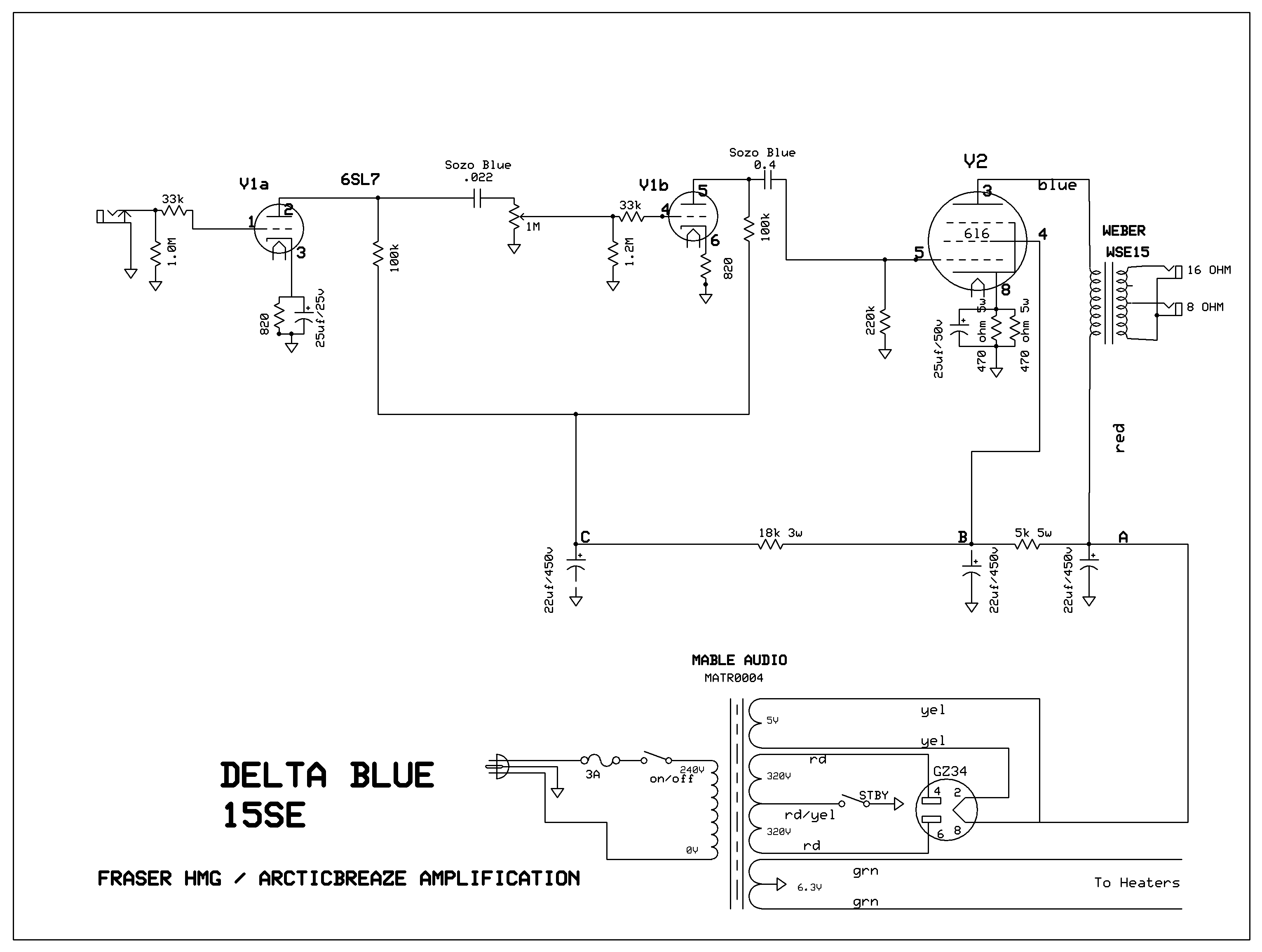

this is my take on the champ circuit and it runs into a WGS ET60, before this I built a turbo champ from Tubelab's schematic (found in the hundred dollar chalange about page one or two) this was really quite bassy used a KT88 and WGS G12c/s
