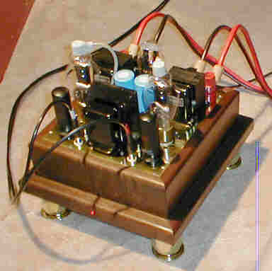

I recently built a two stage stereo SET amp using a 1619 DH octal base pentode with 2.5 volt fil on DC heat to drive an 809 DHT in A2, 6.3 volt fil also on DC heat. I used an interstage xfmer with +9 VDC G1 bias on the 809. The 809 and 1619 driver stand in series under a 625 volt B+ supply. Power for the drivers comes through the output tubes to minimize current load on the power transformer. ~375 volts plate to cathode from 420 volt plate supply on the 809. I have 200 volt plate supply on the 1619. A bit less on the plate through the I.T. I get 3.1 watts RMS per channel, similar to a 2A3. I could not get my pair of I.T.'s to match the 1619's well as a pentode and got much, much better results at a loss of gain by triode strapping the 1619 (1k R G2 to plate). In this mode this tube is really sweet and black silent! The amp turned out well and sounds very good.
I mention this as a 1619 would give one a DH alternative to a EL84/6BQ5 as a driver for the 2A3 and it is a metal octal, basically a DH 6L6.
