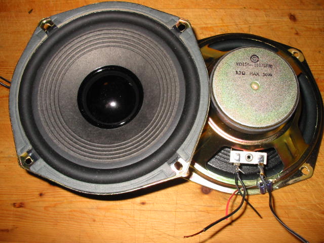

Could you give any more clues about the Sansui? I'm looking for an all-rounder.
For the last however many years, I've thought of it as a Sansui but looking at the pic...it's also one of the salvaged drivers so you wouldn't be able to buy it off the shelf. Really nice all around driver though. I think I like it more than the RS1354.
He is probably talking about the F10.
See the pic. Maybe you guys can sort out what it actually is. It's at the other place so I can't go look at it right now. Inverted rubber surround and plastic dust cap.
