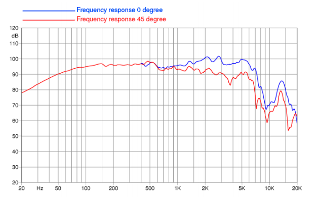

This Beyma is a gem, good price and great sound. Good for 60Hz to 1,600 Hz.
LOUDSPEAKER 10MC500 8 OH
http://lsv-achenbach.de/images/lautsprecher/eigene/point_p/kt_test_phl_3002.jpg

Great driver!
Eighteen Sound - Professional loudspeakers

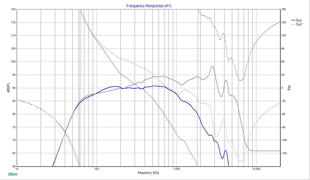

While Troels is only using it as a midrange here, it is a midbass (..requiring a proper bass-reflex design):
The-Loudspeaker
The-Loudspeaker
With an EBP of 250 I wouldn't really regard it as woofer.
Regards
Charles
It's a pro midbass (as requested), not a woofer. 😉
30 liters, 60 Hz vent tuning.
