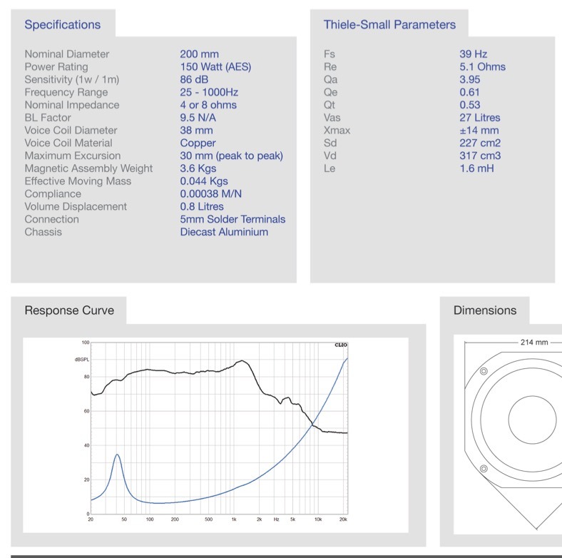

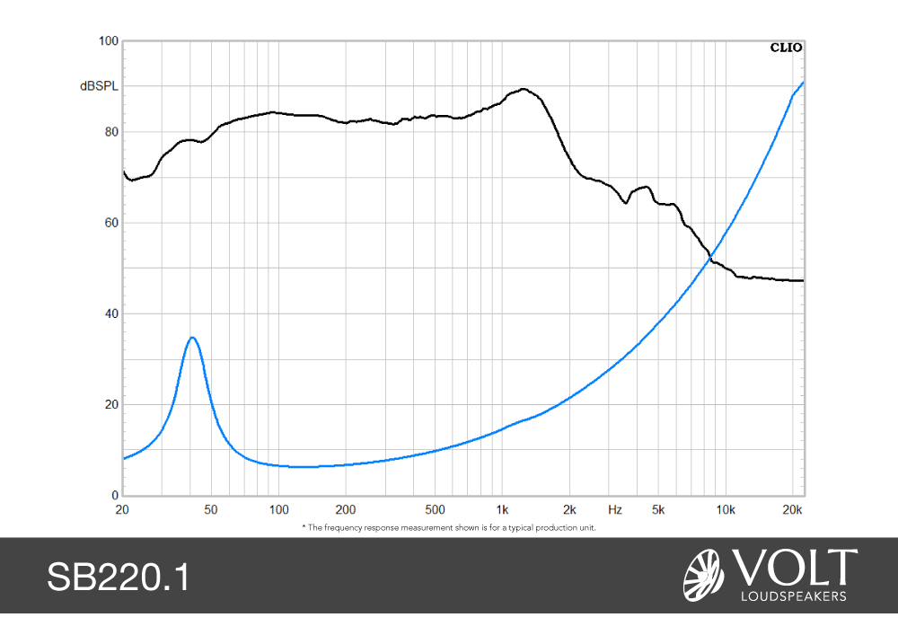

Regardless what route you choose to takeThe speaker should be smallish because it has to go on my desk so 8" is prob the most. (Depending on the volume needed ..)

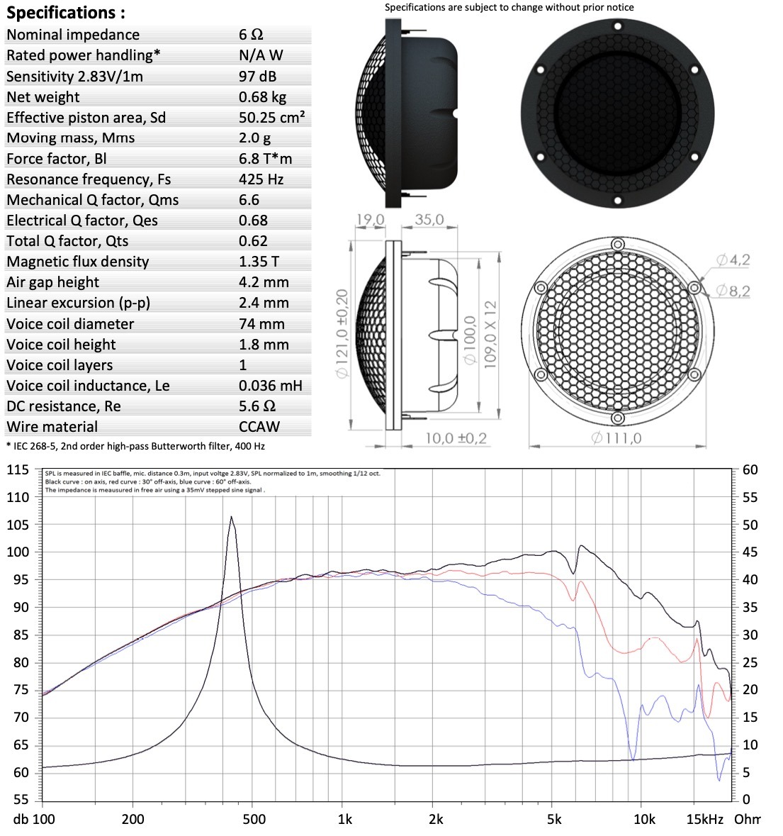

I do already have mid Bliesma t25s, tweeter Bliesma M74S and amp module Hypex 123.
Only thing missing currently is the lows.

i was reading the specs on their site, since it is 3" is not suited to match with your dome HF driverBliesma M74S is a soft dome mid ?!
you need something more like a 6.5" mid driver
and again, why you want 3 way for NEARFIELD
there is only 1way or 2 way for NEARFIELD
