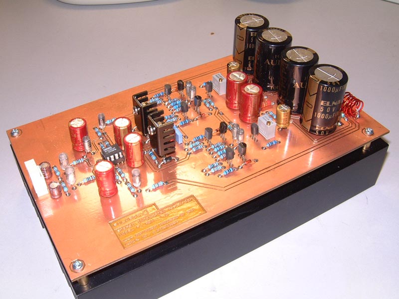

Also, I have put the heatsink to connected chassis with GND.
These oscillations that I have had queerly appeared in a design of amplifier of 2 pair of 1058/162 and alone I have been able to stop them adjusting the Bias. However when it assembles an amplifier of 4 pair of 1058/162 I was able to stop the alone oscillation connecting the heatsink to GND.
Should I use lateral mosfet matched pair or quad perhaps.? Maybe, I have good luck with the choice mosfet for the 4 pair of 1058/162 and have a coincidence with the similar Beta and don't have bigger oscillation.
I am also using a wide band in frequency response very High in the order of 1 MHz and perhaps the oscillations appear there. But, I loved this sound so detailed and I don't want to lose quality audio!
Also, I have noticed improvement in sound quality in low levels in audio when the Bias adjusts to stop the oscillations. But maybe, this is a masquerade, because in high levels the sound isn't the very best (keeping in mind the normal distortion of the used volumes).

amplifierguru said:If you are concerned with linearising your MOSFETs AND allaying some temp/bias vagaries, why not do a CFP ? A quite low power driver like 2n5551/5401 would ensure low Vas loading c.f. HF gate capacitance drive.
Yes, but getting low rail loss is not trivial - the CFP needs to have less than 100% feedback and thus some gain, which may complicate things stability-wise. To be honest, I have not investigated how introducing gain affects the required thermal stabilisation methods...
Another thing to consider is that the gate damper resistor becomes a current limit for the driver transistors should zener Vgs limiting be employed for current limit of the output stage. In the event of clipping due to current limiting, the driver transistors become the output transistors sourcing current through the zener, gate damper and through C-E into the output. For an output short, and typical 6V or so zener and 100 ohm damper, on say 40V rails, this will be some 340mA at full saturation, but if it happens slow enough, a small driver may pass outside it's SOA and die...
luclucmir said:Also, I have put the heatsink to connected chassis with GND.
Yes, of course. But you still need to add small bypass caps located as close as physically possible from the drains of the output transistors to the heatsink. (Again assuming that you have a source-follower output stage.)
luclucmir said:I am also using a wide band in frequency response very High in the order of 1 MHz and perhaps the oscillations appear there.
Again, you need to use gate "stopper" resistors as close as physically possible to the gate of each output device. These will reduce the bandwidth below 1 MHz, but the amplifier will sound much better when it isn't oscillating...
It would help us tremendously if you posted a schematic of the circuit you are using.
