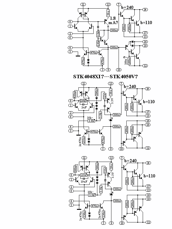

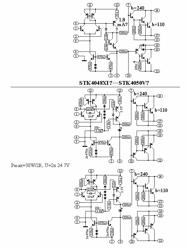

What is it STK4048?---STK4050V? and do the itself work?, surely it is not a pure audio amplifier.
I find it ironic that you say this circuit is not a "pure audio amplifier", yet it is functionally identical to the obselete garbage you peddle as being "Pure" ad nauseum. You should shut your pie hole and ask questions, instead of trying to bamboozle experts with your nonsense.
Latest for fun hybrid amplifiers STK .. .
The STK4048XI is not a complementary output stage, I opened and I know what the truth is.
Well it's sure odd that the schematic you posted clearly shows a complimentary output stage.
I want to see foto of inside.
I cut a fried one open. It's a hybrid with discrete outputs.
