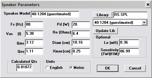

Wild Burro Audio Labs - DIY Full Range Speakers
'Guestimated' specs after break-in of a pair measured probably at least a decade ago, so no idea how accurate they are for any later variants from vendors other than Taiwan:
GM

'Ideal'? 'Best'?
With a high output impedance, tuning to Fs is one requirement, so with such a high effective Qts [Re + Rs], a [huge] horn, aperiodic, or OB are the choices and since each amp will probably have a different impedance [as in DF, not tap, rating] will require different cab designs. That, or build whichever combination yields the largest cab net volume [Vb] and add however much series resistance is required to the others to ~ tonally balance them out.
