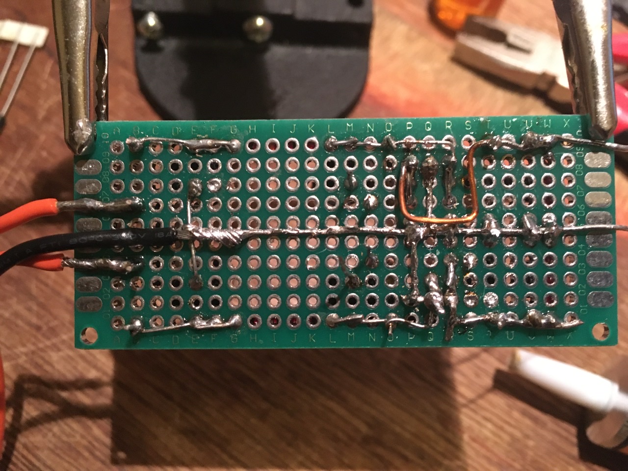

I have built Rod Elliot’s simple preamp supply with bits I had on hand. I will eventually be building an active crossover for the home system and am having a go at the basic building blocks for experience.
I have followed the schematic on figure 2. on his wonderful page: Power Supply for Preamps except I didn’t have 100nf ceramic capacitors and so used 1F ceramics.

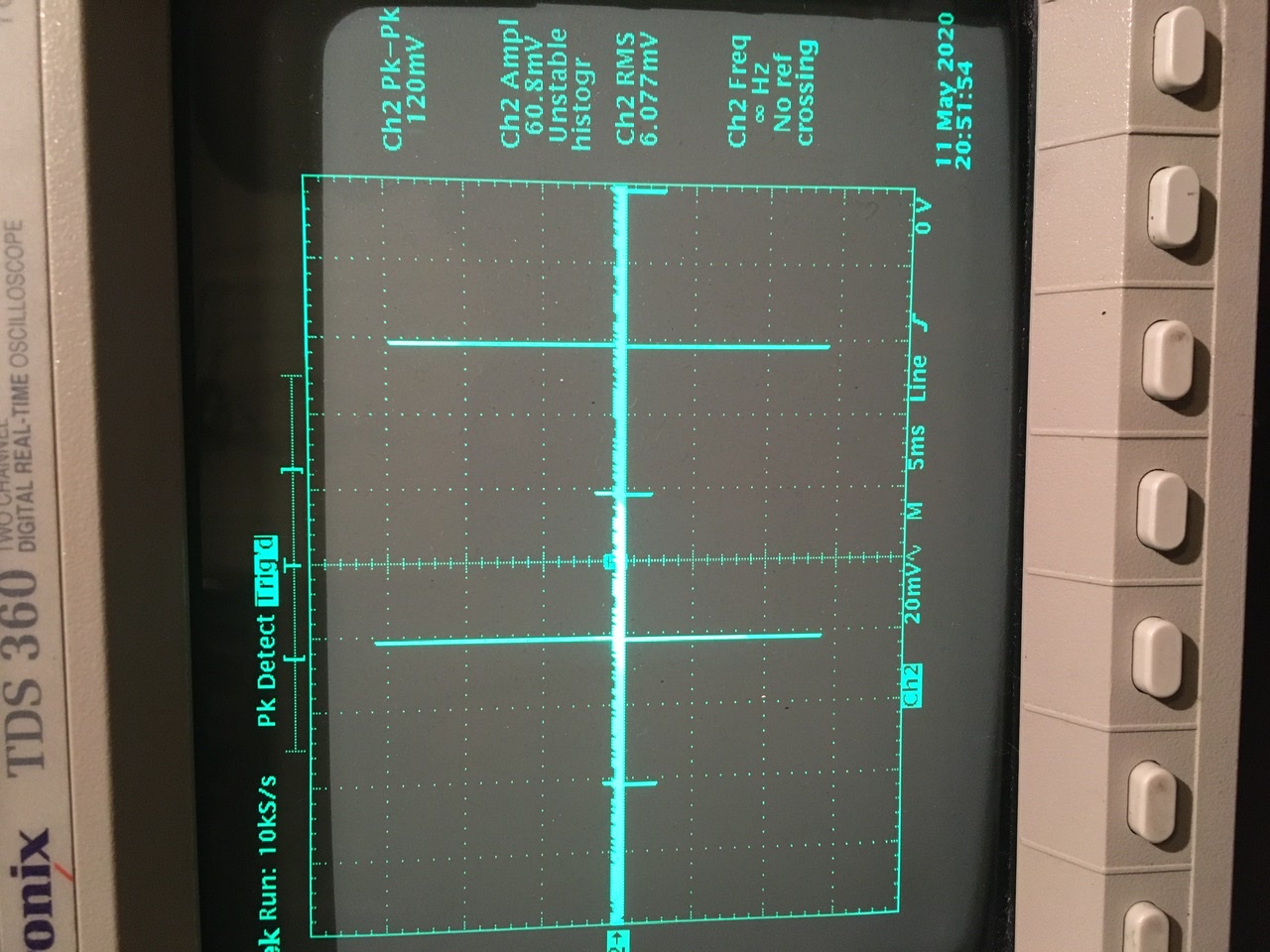

With 2.2k resistors across the outputs world as to draw a ~5mA constant current and discharge the caps when off, I probed across the 10uf output capacitor (with a ground spring on the probe) and got much more noise than I was expecting.
The frequency of the spikes in the photo are at almost exactly 100Hz but I am baffled as to what might cause them, I was expecting much better noise performance?
Is the bridge rectifier?
These are charging pulses of current into the first capacitors, from IR voltage drop due to layout.
The connection between the secondary center tap and the two 4700uF capacitors should not be shared
with the rest of the circuit. The ground connection between the 4700uF capacitors and the regulators
must be separate, taken directly from the input capacitors (near their bodies) to the regulator ground pins.
The second 4700uF capacitors should return directly to the regulator ground pins, and then a single wire
from there goes back to the input capacitors' ground point.
Yes, it's hard to see details on the breadboard, probably not oscillation per se, maybe some ringing,
but you could post a clearer waveform, with an expanded time base. Unless your probe is picking up spikes,
some will. Try moving the probe physically farther away from the input side.
The ideal way is two separate secondaries, each FWB rectified, filtered, and regulated, and each only connected
to circuit ground at the output terminals, with the rest of the circuit floating. This does not apply to a center tapped winding, though. The common ground, like for audio circuits, can have problems.

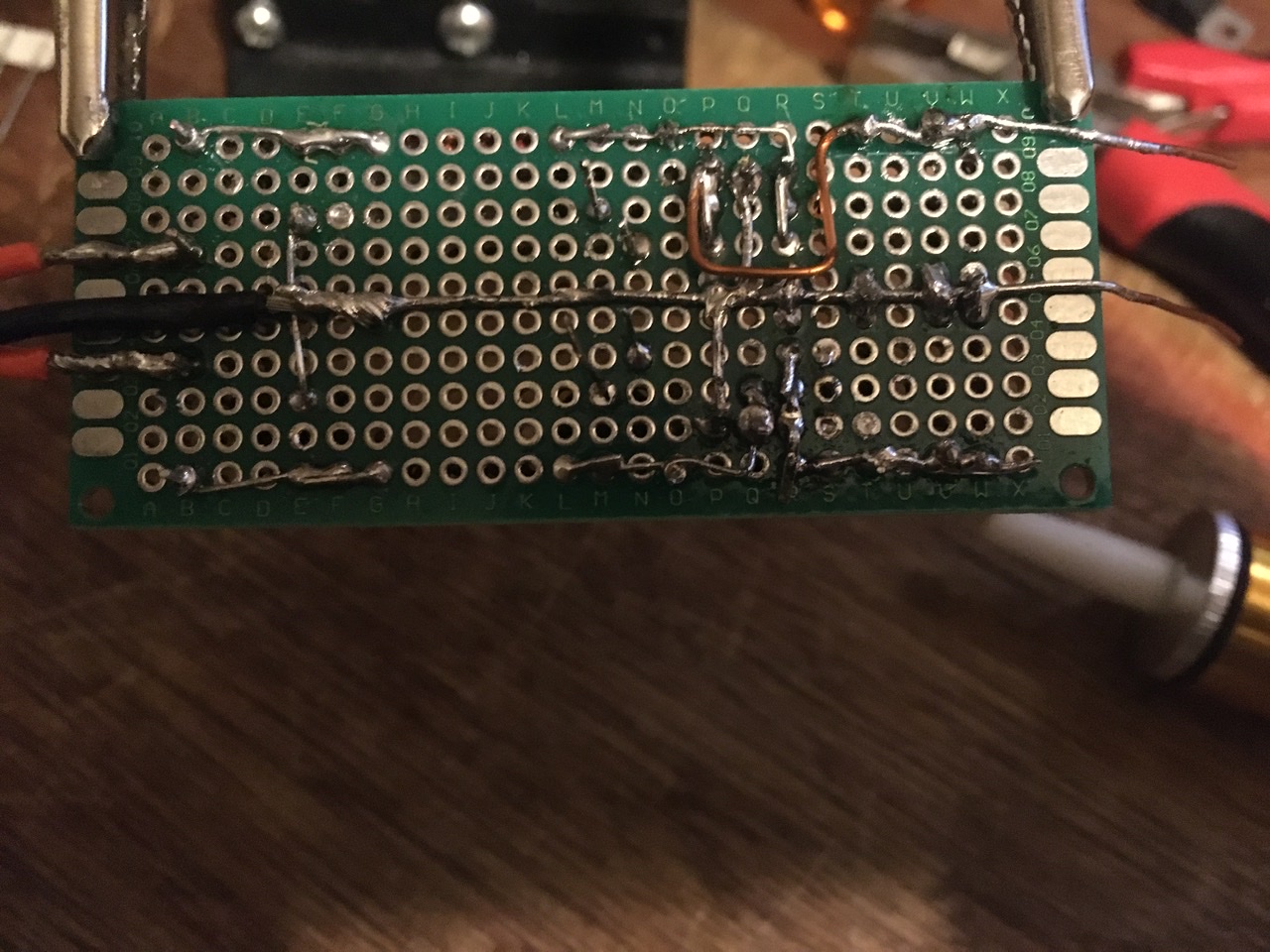

Ok, apologies. I hope this photo is clearer. 🙂
I have desoldered the second set of 2200uf capacitors (after the resistors on the rectifier as well as the side) as well as the 1uF ceramic caps.
If I have understood you correctly, I will solder the negative of one 2200uF capacitor to the ground of the 7812, the positive of the other 2200uf cap to the ground of the 7912 and then a separate ground wire from each going back to the junction of the CT wire and the two primary 2200uF caps?
In this circuit use just one ground wire connection, or else another ground loop will be introduced.
Also try moving the transformer secondary center tap wire connection farther to the left.

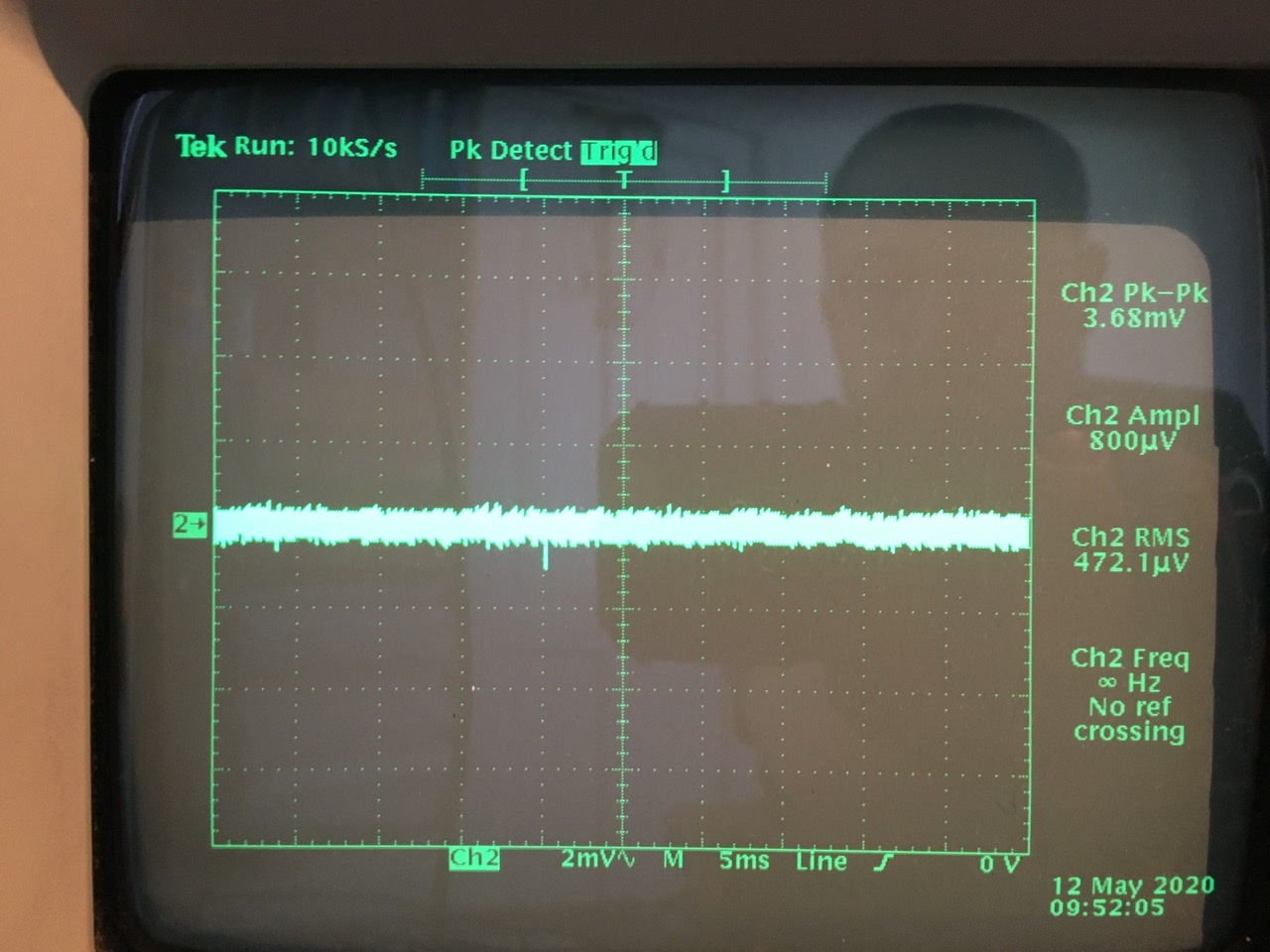

It may be me, I am not an expert on using an oscilloscope, I read to use a ground spring (rather than the clip and wire) and to probe directly on the out put caps, is there some trick to it?
Measure the voltage across D7 and D8 with scope ground on output zero volt line.
With the scope set for 2mV per division, 5ms sweep and glitch detect on?
If so I get this:

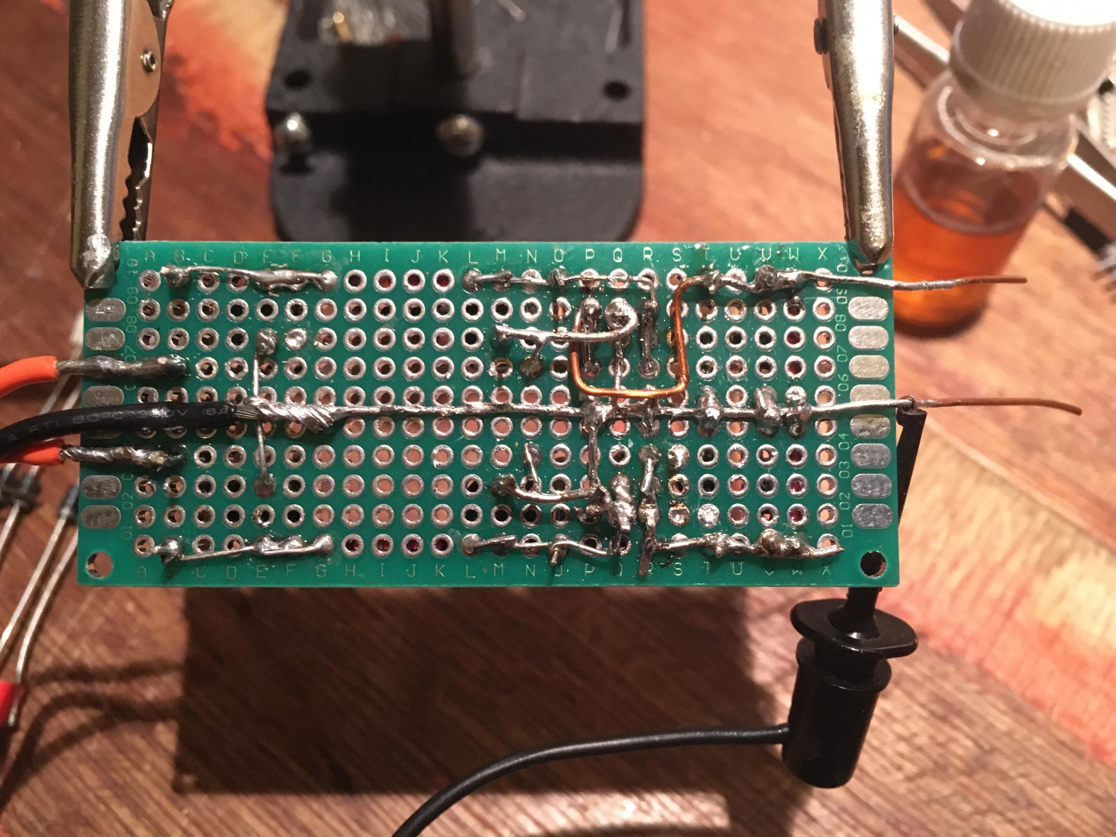

(Changed topography to ground second set of capacitors directly to regulator pins)
Cheers Nigel. 🙂

Yes, and move el. capacitors close to each other (+ to -).
thanks Vovk, the proper caps for the regulator will be bigger and fit fairly tighly in the space, these are just for testing purposes.

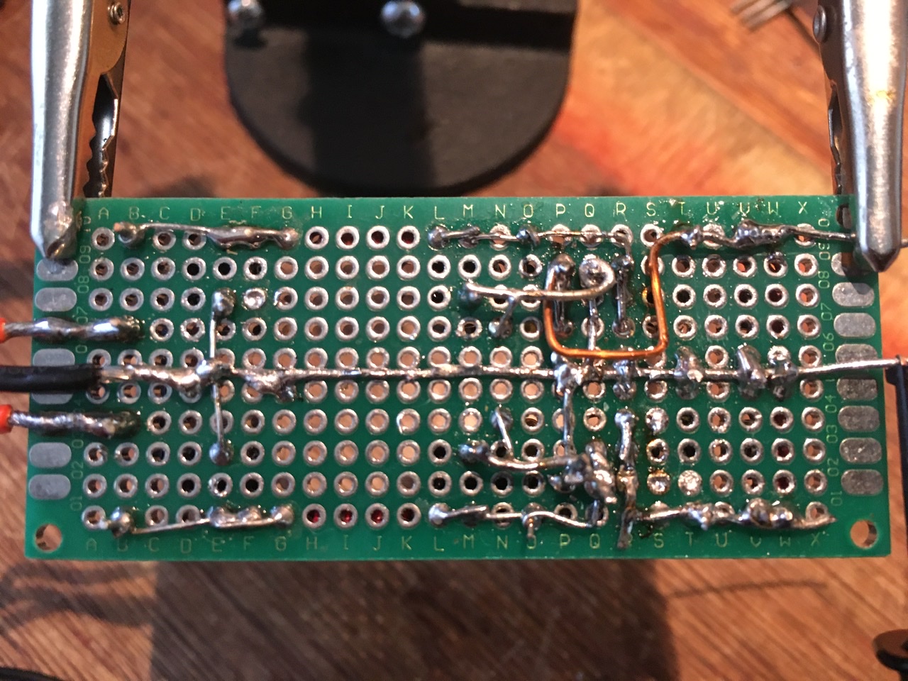

What exactly does the part about moving the connection further to the left mean? If I extend it with a wire... isn't that the same as extending it with a wire? 😕
Sorry about the basic questions chaps and thanks for all your help.
Thank you very much chaps, by removing the CT wire From overlapping the primary capacitor wire and circuit earth track and resoldering it so it just abutts the junction where they meet (I.e. further left as everyone said 😀) and the result was magic, the spikes disappeared straight away.
Thanks again for taking the time to help me out.
