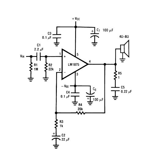

If I have a home built amplifier ex:LM1875 how can you scale it to decibel scale?

Put some numbers in as you suggest.
Lets take the LM1875 here. R3 and R4 determine the voltage gain at AC. Numerically the gain is (R4 + R3)/R3 which is 21. That means that 100 millivolts RMS input would deliver 2100 mv RMS output. If we talked of 300 mv peak input we would get 6300 mv peak output and so on.
So whats the voltage gain in db. The formula is Gain = 20Log(VOut/Vin) So using either of the above two sets of numbers we get 26.4 db using either set of numbers. Also you'll notice if you swap Vin and Vout around in the formula that the answer is the same except with a minus sign in front of it. So if your amplifier really did give 100 mv output for 2100 mv input (an attenuator) then the figure of -26.4db would indicate that.
So thats voltage gain. For that amplifier it is 26.4db at AC in the "midband". Why midband ? Because the input coupling capacitor rolls the gain off to zero at DC. The capacitor C2 also rolls the gain "of the amplifier itself" down to 1 or unity at DC. If we shorted those caps out (don't :)) the amplifier would maintain its gain down to DC. At high frequencies the gain falls off again due to limitations of the IC.
Now imagine its running into an 8 ohm load. Using the same figures we can say that the output of 2100 mv RMS produces a power of 0.55 watts RMS (W= V squared/R). into that load impedance. We can also say that the 100mv input would produce a power of 0.00125 watts into 8 ohms if it were applied across the load (same watts equals v squared over R)
In db that ratio is 10Log(Pout/Pin) which is 26.4db (the same figure as the voltage gain)

Thanks Dan. That sounds as reasonable assumption as any.
I suppose what I was wondering is, why quote a variable gain amplifier (like an integrated amp) as having a gain below and above a notional 0db point. Is some reference value implied in the 0db figure. I don't know the answer to that :)
