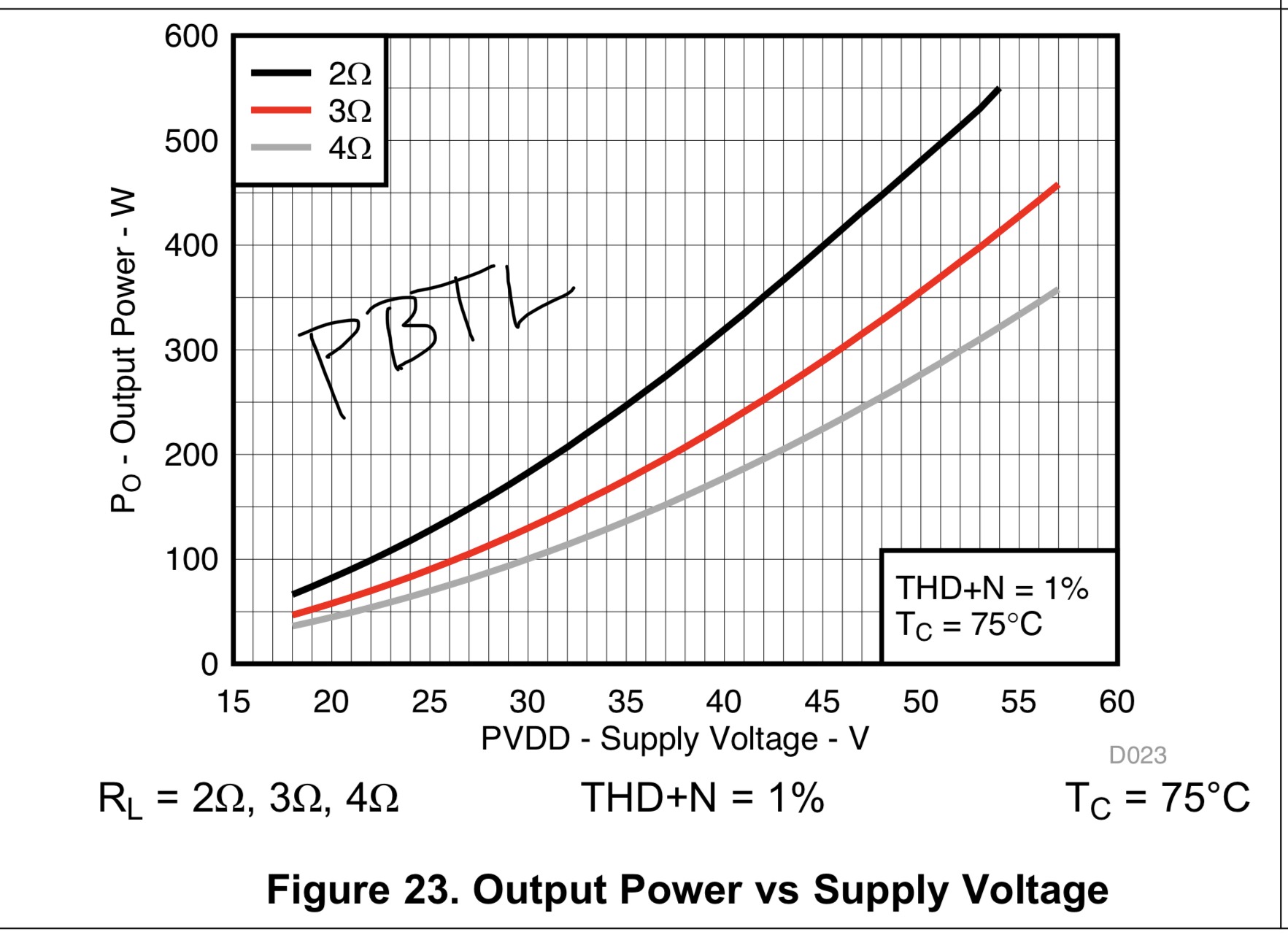

@wolf_teeth, you’d need more than 24VDC with TPA3255 to reach 100W at 4Ohm. See the data sheet charts attached.
Either in BTL (2 channel output per TPA) or PBTL (1 channel output per TPA) would require 30V+.
You could use one of those DC buck converters (many Amazon options) and dial up the voltage if you really want to keep that power supply. One buck converter per amplifier board may work for you. Those things have been reported to be noisy, but I’ve only used lower power ones. You could add a Mark Johnson SMPS filter to the output, but then you’re daisy chaining lots of things to focus on one power supply.

Seems I can get ~120W with some 400W boards at my supply voltage, but the THD is climbing to 10% by that point.
Those numbers are pure marketing and useless.
Post #5 explain it, so a good quality amp board will need more voltage to give you something decent.
Realistically you can get a fairly good sounding 15 to 25W amp with a TPA3116 type of chip.
But at the end we don't know what kind of power supply you have, model number will be useful.
24V in bridge is 48Vp-p at best. 24V peak is 17V rms which is 72 Watts into 4 Ohms.
100W into 4 Ohms requires 20Vrms which is 28.28V peak (56.56Vp-p) (minimum)
At 27.6VDC (supply max), you can get 95.22 Watts into 4 Ohms maximum, which is within 0.5dB of 100W, ie don't sweat a couple dB.
1dB is about 26% power, ie the difference between 74W and 100W is just barely noticeable.
