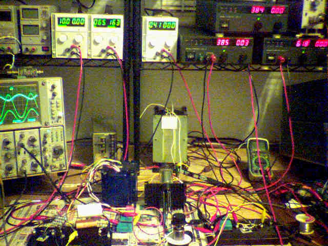

Weird coincidence... I've been doodling with the concept of making a high-performance tube curve tracer with SMUs for a couple of months. I would like to accommodate large power tubes, so the system would have to incorporate at least one brutal-class programmable HV PSU as well. I'm none too sure my fun budget is adequate for this project.

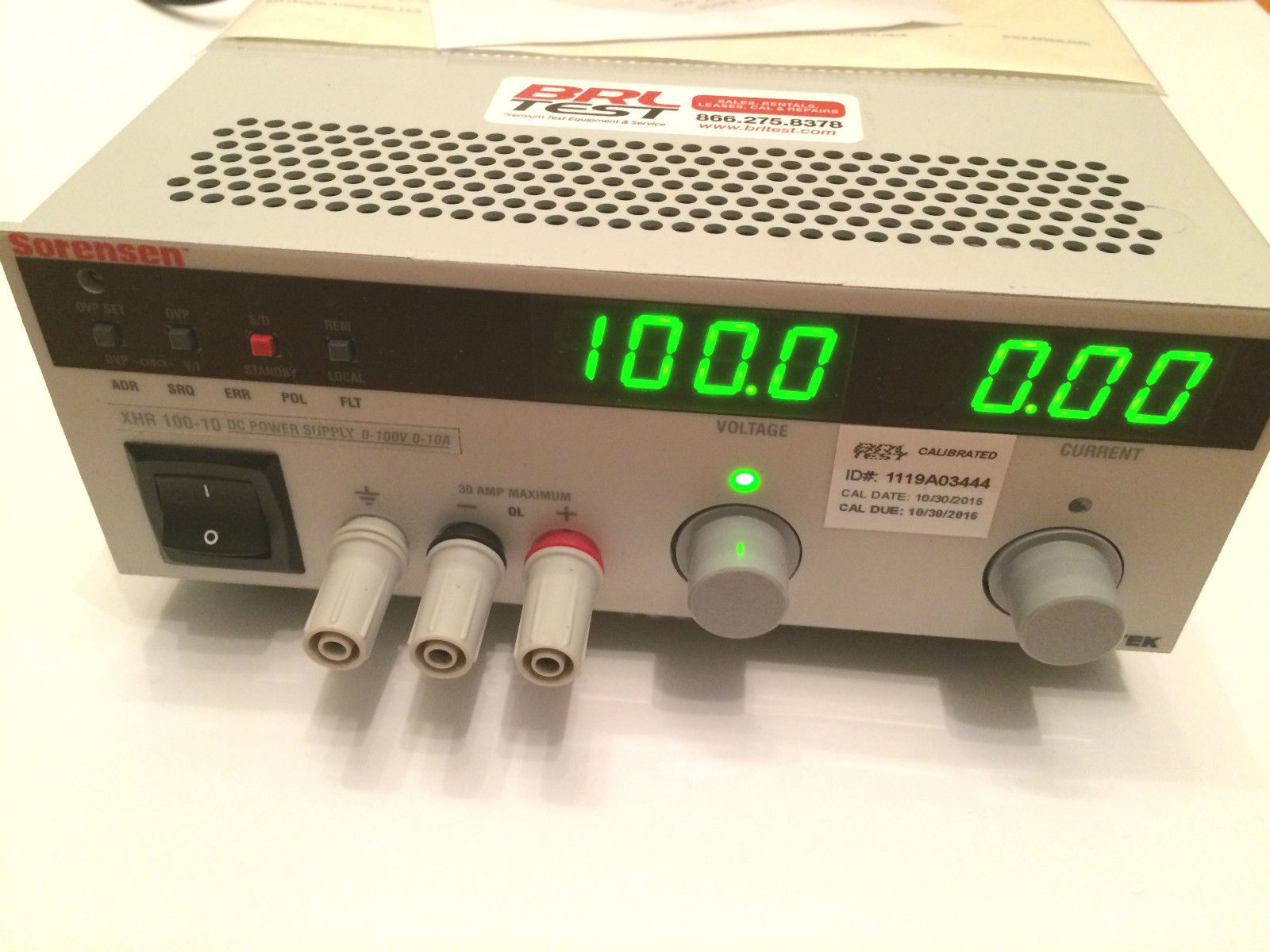

There are Xantrex XHR-600-1.7 power supplies on Ebay. (0-600V 1.7 Amp) Many of these have isolated GPIB interfaces on them, can tell by looking at the back (an option). A few have an isolated RS-232 interface that is convenient for PC use. The GPIB interfaced ones can be converted to RS-232 interfaces by addition of a small chip, some bypass caps, and some jumpers plus an EPROM change. I have done this on several units here. These supplies are programmable as well as providing V and I readback. Programmable current limiting too. Used to be able to get these for around $300 working ($50 to $100 repairable), but the confiscatory EBAY rates lately have driven them up to the $1000 to $1500 range. I think they are $1800 new.

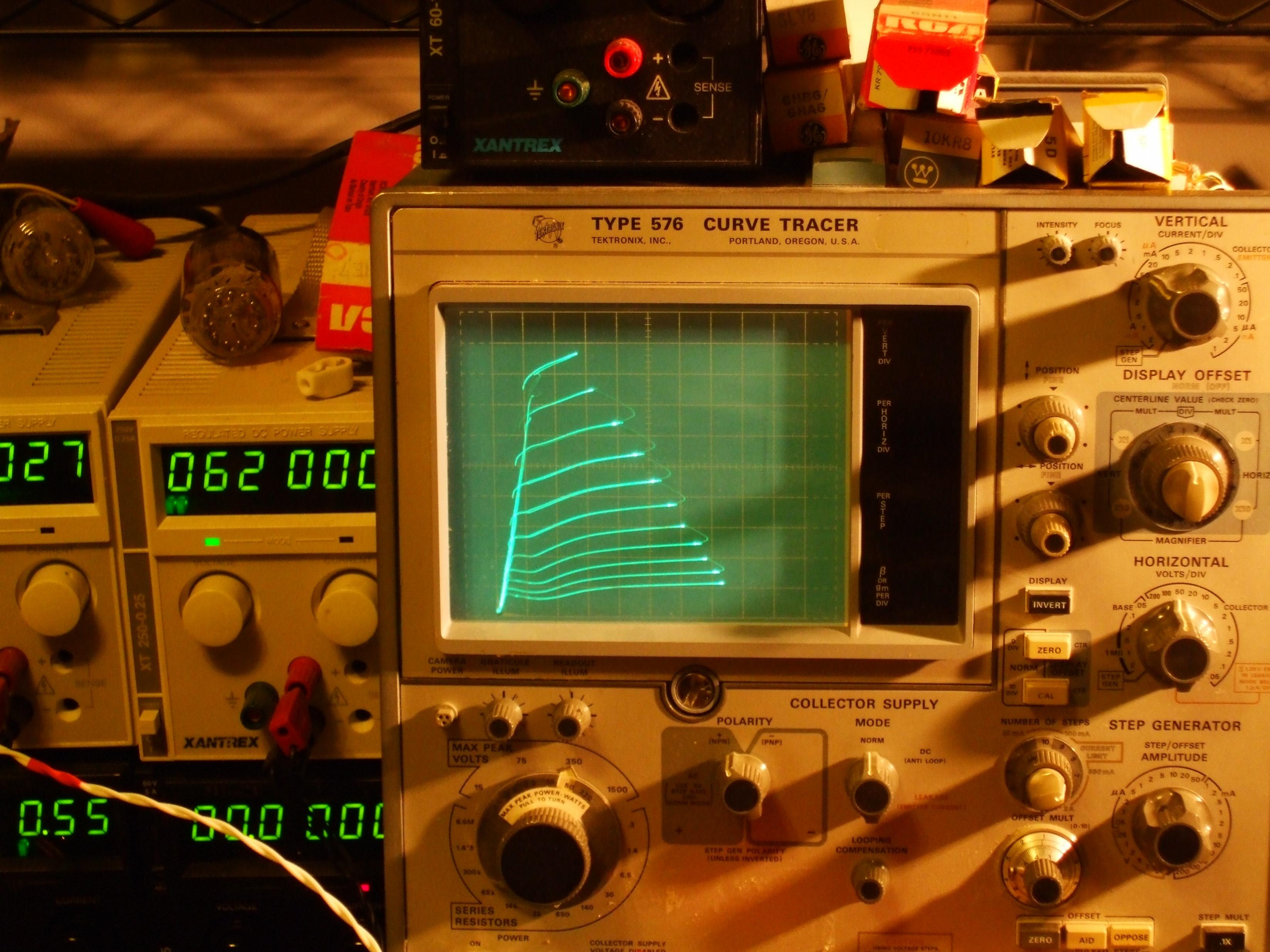

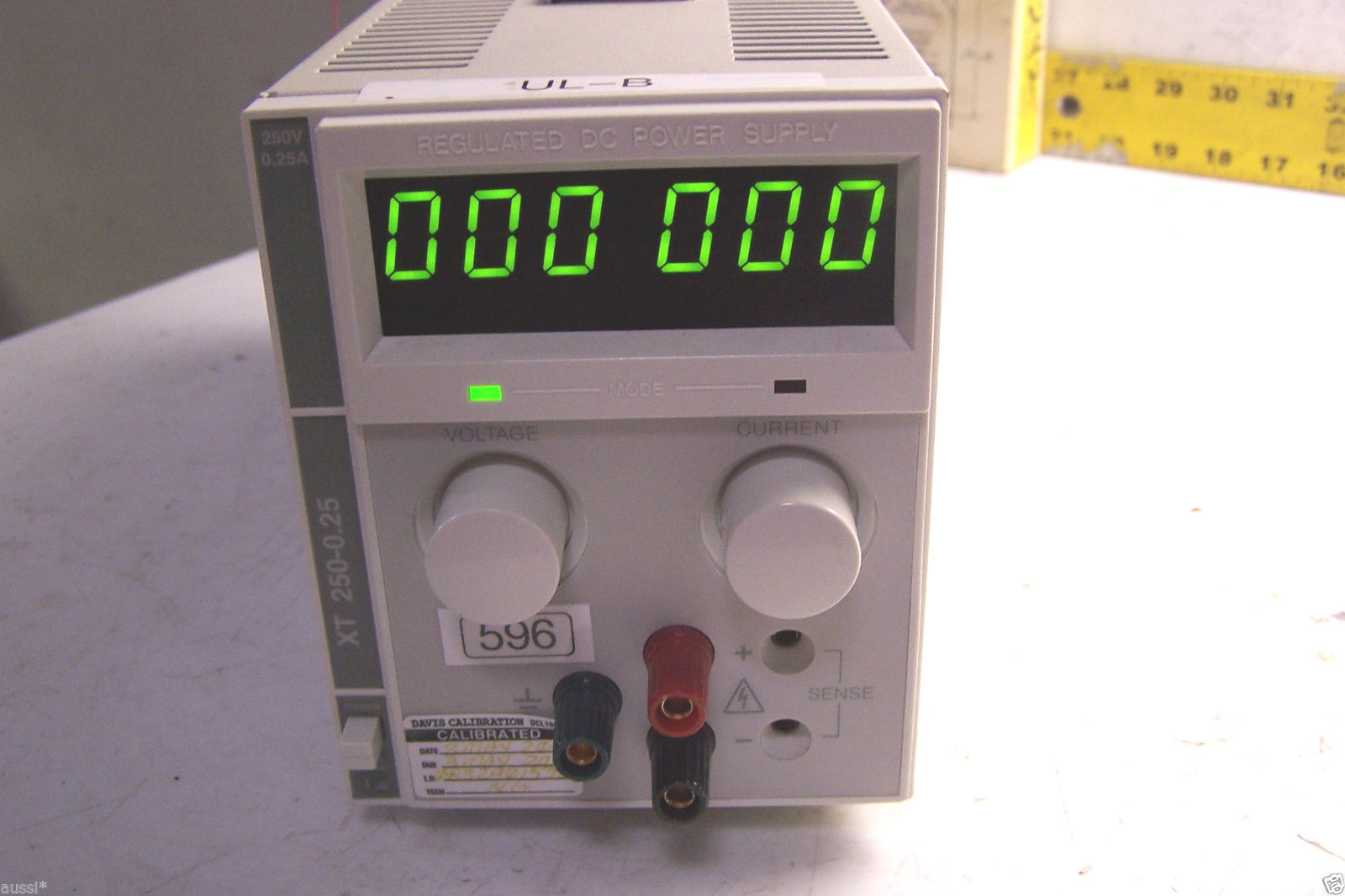

Then there is the Xantrex XT-250-0.25 (0-250V 0.25 Amp) suitable for screen grid supply, well for TV tubes at least. These come in GPIB and RS-232 isolated interfaces also (an option on back, so check pictures), and are similarly inter convertible. (the option interface board on these can be easily swapped from another XT-.. power supply. Often available on cheap 5V supplies.) These XT-250 units can be found for $120 with some patience. Or twice that without. I use them for screen grid supplies for the Tektronix 576 Curve tracer here. (plus Xantrex HPD-60-5 for filaments)
One could use an XT-120-0.5 for grid bias control. HPD-60-5 for filament control.
These supplies could be run with Visual Basic easily to form a flexible PC curve tracer.
You don't really need any other measurement equipment.

I have taken some time to read the specifications for the Sorensen XT series DC power supplies and GPIB card that is installed as an option. The Operation Manual reports current Readback Resolution by the GPIB for the Sorensen DC power supplies as 1mA. Think of it as 2 ½ digits with mA’s as the count digit, in fact this is what appears on the digital meter on the face of the power supply. This level of resolution works fine for the phosphorous display on a curve tracer but doesn’t do much for calculating the slope of a line tangent to an operating point on a plate curve.

Looking at the serial/GPIB interface card for the XT-250 here, it has a BB DAC703KH D/A, which is 16 bit, with guaranteed 15 bit monotonicity.
That should resolve 250 mA to 1/130 mA.

Thank you for lifting the hood and looking inside your machine. All I have to look at is the Operation Manual (see the link below), at the top of page 12 it confirms 16-bit programming and readback of voltage and current. Table 1.1 on page 13 is where it reports 1 mA resolution for all the XT models including the 250-0.25. Perhaps they are conservative in their claims.
