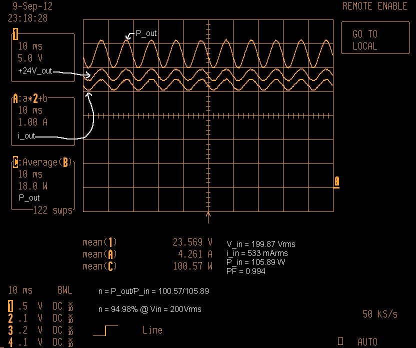

Here's how. all you have to do is have a 4GS/s scope with 8Mb sample memory, an isolated voltage probe with 100MHz bandwidth (in case its a bridged load - you can probably just use an ordinary voltage probe) and a DC-50MHz current probe.
Measure the voltage V(t) and current i(t) thusly, then use scope maths to multiply the two channels together giving P(t). Use scope maths to calculate the mean power, and to find peak power put the scope on infinite persistence and run for however long.
the scope is pretty easy - it looks like all the tek-like DSOs now have 1GS/s sampling and plenty of sample memory (I have LeCroy scopes). The real problem is the current probes - make sure you are sitting down before checking out the price. Dont be surprised if a decent current probe costs twice as much as your scope (my ones did).
But there is a low-cost alternative - use a LEM DCCT. you have to feed a wire through the hole, and make up a small interface board to supply them with power, but you can get decent LEM DCCTs for $50 or so new, and cheaper on ebay.
Or the cheapest approach is to use a current sensing resistor - downside is SNR, you need Rcs << Rload, and this can result in a fairly small signal. whereas the LEM DCCT will give +/-12V FS.
attached is an instantaneous & average power measurement of the output of a 100W PFC smps. this topology has quite a bit of 100Hz ripple in the output, so I had to measure instantaneous power Pout(t) and then average it over an integer number of AC line cycles - a pair of DMMs gave garbage results.
