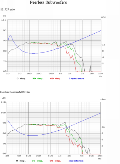

I don't know why you don't like paper, but do not limit yourself to just poly cones as an alternative. Peerless took a fine, inexpensive 10" subwoofer with a poly cone-the 260-and changed the cone to a sandwich construction. It increased the price only $5, but so improved the strength of the cone that it is now very usable for 2 way systems crossing over at 2,000 Hz.
The same speaker, with a poly cone, broke up just above 500 Hz. So it isn't a case of just paper or poly. There are additional alternatives.
Here are the two woofers. Both are available at Parts Express by the way. Note the difference at 800 Hz. Otherwise, these two speakers are exactly identical-same magnet, voice coil, basket, etc.

I showed the Peerless 10 inchers not for you to consider them, since they are not 12 inchers, but to illustrate that a sandwich cone can be superior to a poly cone. I didn't want you to get locked into only looking for poly. Some people really dislike poly, considering it the worst possible cone material. I don't dislike it, but I don't think it is necessarily the best thing out there, either.
