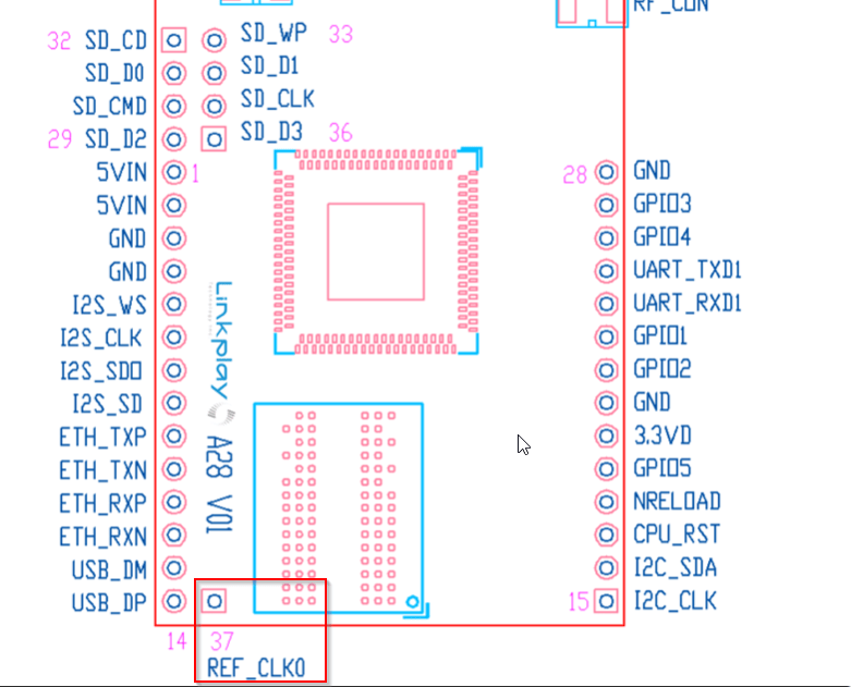

i was just going thought the datasheet for Linkplay A28 on Parts express and observed pin # 37 mentioned as reference clock, has anyone probed it's purpose?
REF_CLK0 sounds like it might be MCLK output from the board. A scope could be used to check on that. Assuming that's what it is, since they refer to it as a 'REF' (i.e. for reference) makes me think it should probably be buffered if used in subsequent circuitry as an MCLK signal.

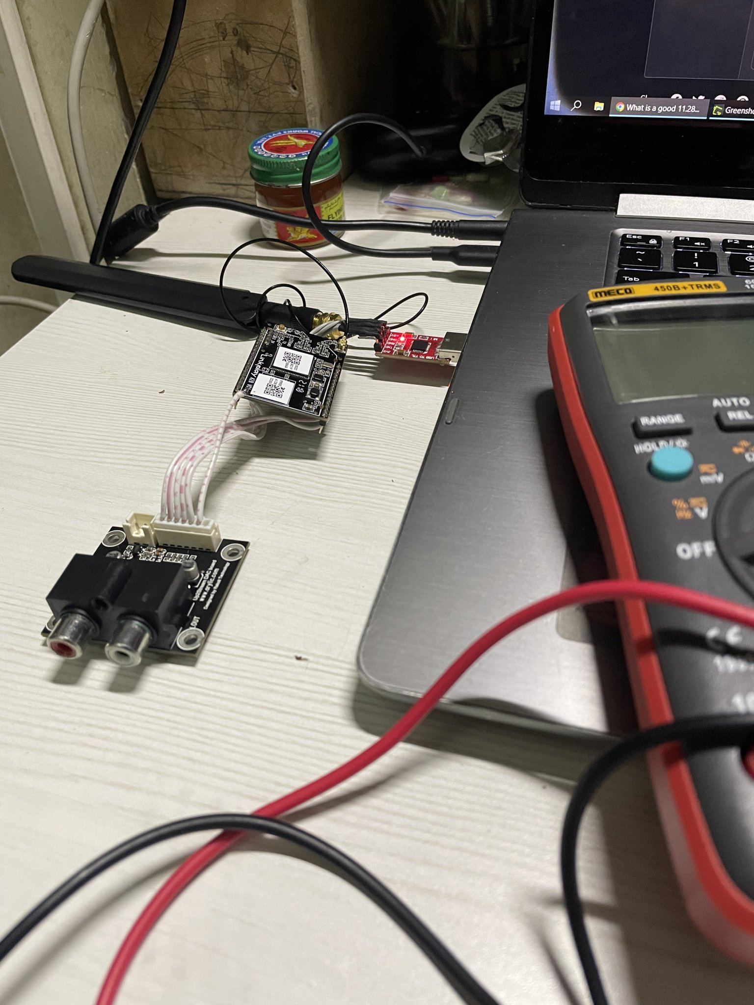

Hi @Markw4
Unfortunately do not have access to a Scope right now but maybe over the weekend, I might be able to access one all provided my health improves.
But tried a crude test when playing music to the Linkplay A28, I connected my multimeter to the WS = 44.10kHZ, BCLK = 1.4112MHz, and the Data out Pin was 0.300 ~ 0.282MHz was the reading.

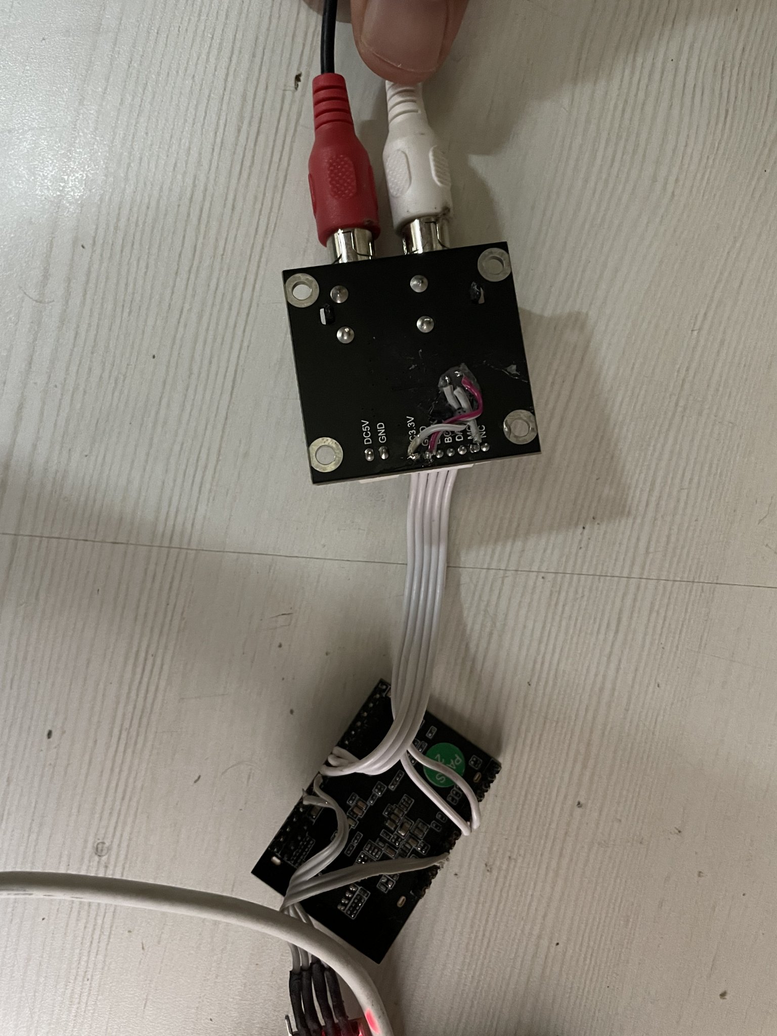

Hi @Markw4
Well that ref clock pin #37 didn’t work, I will see by giving it a pull up later in the weekend.
I currently tried a 50MHz txco connected as seen in the image and I have audio
infant the linkplay device announces “connected to your Wi-Fi” 😬.
During airplay the volume changes are sluggish. I feel the bass is a bit low but that might be the ESS9023 dac may be.
It is Arylic’s DAC board.
