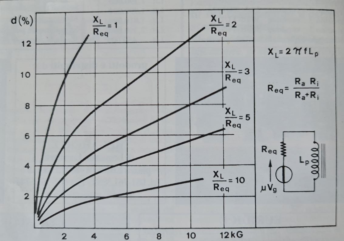

The ratio between inductive reactance XL and equivalent resistance Req IS the measure of how much inductance you need at a given low frequency.
XL=2*pi*f*Lp where Lp is the primary inductance
Req = (Rload + RDC) //Rplate
To get low distortion XL >> Req (the much bigger simbol >> means at least 6-8 times, more is better)
This is relatively easy down to about 40Hz with triodes. At 30Hz it is only possible with low plate resistance tubes like 300B, 2A3 etc...with other tubes with Rp in the 1K-2K range it can be still fairly good.
The 5H people talk about in that blog for a 5K transformer is poor for 30Hz or less except for tubes that have 200R or, possibly, lower plate resistance. Sometimes transformers have better inductance than declared sometimes not. This is obviously related to actual inductance, not catalogue numbers....

The picture can be considered a "universal" behaviour of distortion as function of total induction for different values of XL/Req.
Ra is approximated with load resistance reflected to the primary for simplicity and DC resistance of the windings is not taken into account. However things are not much different and, in case the DC resistance is excessive, things get worse...

Of course it is related to a core made of FeSi grain oriented laminations with a gap and DC induction is optimized for max headroom (i.e. DC induction is equal to or just above 50% of the total relative to the working conditions and output power level)
What is Req?
Back to post #27.
Again? It's written in the picture.....
Take a transformer with 25:1 turn ratio, primary DC resistance 125R, secondary DC resistance 0.2R. For 8R resistive load the reflected primary impedance is 5K.
Then pick your tube and say you want to use a 300B at 400V/75mA where its plate resistance is 750R.
Then Ra in that formula, also including the DC resistance of both primary and secondary, would be:
Ra= 5K + 125R + (25*25*0.2)= 5250R
Ri = 750R
then Req =5250 // 750 = 656.25 R
If ignore the DC resistance of the windings to go faster Req = 652.17 R....very little difference as one only uses this formula for an estimate.
Then if you want stay on the curve where a ratio of 8 between XL and Req and decides to have it at 30Hz:
(2*pi*30*L)/656.25=8
From there one can calculate L = 27.85 H
