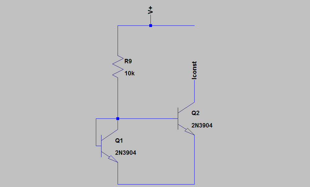

Forget the chip, 2 transistor and a couple of resistor is all you need for a simple CCS. (add a couple more transistors and you can make an excellent CCS.)
A transistors collector current (Ic) depends on the voltage across its base emitter junction (Vbe). Keep that voltage constant and you keep Ic constant(as long as the temperatures are the identical).
In the diagram the 2 trans. Vbe's are identical (wired to be that). The left tran. is conected to turn it into a diode, if the two trans. are identitcal and there Vbe's are the same then there Ics will also be the same. The resistor sets the current tru the diode, which in turn stes the current tru the other trans. That simple!

Still don't fully understand MOSFET based CCS devices
Same basic concept -- there is a relationship between Vgs (voltage between the gate and the source) and Ids current from the drain to the source. So, you bias the gate such that there is a voltage difference between source and gate and this will correspond to a particular current flowing across the fet. With a depletion mode fet, like the DN2540, IXYS 10m45, 2sk170, etc, this is particularly easy to do. You simply put a resistor on the source and connect the other side to the gate. As current flows across the resistor, it drops a certain voltage that is used to bias the gate. Enhancement mode fets are biased the opposite way and require an external way to bias the gate -- often a zener and a resistor.
The IXYs chips have measurably better AC performance, parasitic capacitances being what they are in bipolar transistors and even many mosfets, than the simple CCS shown above. This is particularly relevant as tube plate loads where the rp of the tube in question may be significant relative to the load impedance created by the CCS.
I think SY may have touched on this in some ancient posts and I have a number of highly analytical engineer friends who have devised experiments indicating that the more complex cascodes realized with particular mosfets or IXYs CCS chips were able to maintain a very high load impedance over a wide range of audio frequencies whereas the simpler CCS could not.
Depends where the CCS is used - in the case of the cathodes of a 6AS7GA/6080 for example even the 317 configured as a CCS will be adequate because of the low impedances involved relative to those the CCS is capable of generating.

Change Q2 to a FET and the resistor to 1M and you get a lot more near ideal results.

A Quick Overview of CCS Options:
1. Two terminal FET constant current diodes (e.g., the CRxxx series) have poor dynamic impedance. They do not perform well unless the tube they're hooked to has very low plate resistance.
2. LM317-based CCS are quite poor. They're fine for things like heater string feeds, but the limited bandwidth and mediocre dynamic impedance make them unsuitable for high quality applications in signal circuits.
3. Degenerated pentodes are excellent current sinks but cannot be easily adapted to make current sources.
4. Degenerated discrete FETs make a much better CCS.
5. The cascode bipolar CCS is cheap, easy, and performs exceptionally well. Gek references an app note I wrote which sums up the design and performance. These devices are covered extensively in Morgan Jones's book (though the good parts aren't Google-able- you need to actually purchase a copy). The limitations as current sources are the lack of high speed high voltage, and high gain in PNP power transistors.
6. Cascoded self-biased depletion-mode MOSFET CCS are even simpler and cheaper (two MOSFETs, three resistors, total cost under $5), with outstanding performance. See, for example, the ImPasse article in February 2009 AudioXpress and Walt Jung's measurements on that CCS a month or two later. These can be equally well used as sources or sinks.
