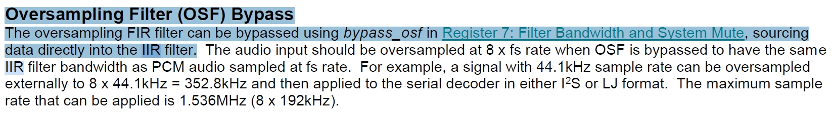

Please see below for excerpt from ESS datasheet...
