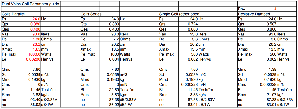

Dual voice-coil subwoofers can be a little tricky. Now I can't find my book right now, but if you are going to do some simulations, the T/S parameters will change when you wire them in single-coil, parallel pair, or series pair.
I have a pair of old RS 12" "Subwoofer" 40-1350 DVC...as I simmed them for an enclosure I got radical differing results. Unfortunately both coils are rated at Four ohms each & in parallel they of course dropped slightly below Two ohms, the kind of load that would tend to "eat" amplifiers. Keep it simple, two channels, one channel per coil with a pair of big fat inductors to cut it off above 80 hertz or so.

The inductance of the two identical voice-coils (Le) in parallel should be 0.001 Henries, not the identical values you have listed for the single-coil at 0.002 mH.Ron E's DVC wiring chart: View attachment 1188194
------------------------------------------------------------------------------------------------------------------------------------Rick...

At a glance it would seem so, but Ron E explains why it's apparently not, though not educated enough to follow, so hoping you and/or others can 'dumb it down' enough or conclusively prove him wrong.The inductance of the two identical voice-coils (Le) in parallel should be 0.001 Henries, not the identical values you have listed for the single-coil at 0.002 mH.
