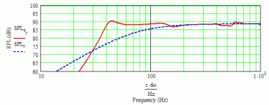

WRT converting them to a MLTL, adding a 3" i.d. diameter x 2" long vent 31.5" down from the top sims usable output to 40 Hz and if it sounds 'boomy', damp the vent as required, then dial in some series R to flatten it.
GM
Keeping my enclosure as it is, I would get a L of 47.5", thus quarter wave resonance of ~71Hz, pretty much dead on my driver's Fs, good coincidence!
I have some 2.75" diameter, 3" deep plastic ports just lying there not being used, could that do, I could even shorten them if necessary.
BTW, if anyone has a useful link or read for me on Helmoltz resonance and how to apply it to enclosures, I'd like to know more about that, I'm never happy with just using box softwares, I wanna know the mechanics behind! I failed to find anything relevant on that so far...
Assuming 2.75" i.d., then 1.5" long, though try them at 3" just to get a frame of reference. Insert the vent in baffle, but don't push it in all the way, so you can pull it back out to shorten if desired. Use some type of putty to seal them to the baffles though, such as Blu-tac, Play Doh modeling clay, etc. to ensure a good seal that's easily cleaned up.

OK, the dims you listed implied only an 11.5" offset which yielded a hard to cure dip, but at 16" it's close enough for the negligible dip to be inaubile with the minimal stuffing I suggested.

In a MLTL, the closed pipe dip becomes a vent peak that typically fills in a bit where the driver is beginning to roll off, so a plus, not a minus WRT response.
Anyway, same vent, just shift it down to ~35.25" from the top.

My front baffle gave me a sim'd baffle step peaking at ~7dB from ~500Hz to a bit above 1000Hz, quitle flat, then back to 6dB all the way up the FR. So uncompensated, it is very telephony yes, but with some EQ to counter the stepped response, it's better. I still get that not-too-lively midrange, but I have realistic expectations of a rather no-name-ish 25$ driver. At least things got better.
Ok, I'll try that new vent position and re-stuffing when I get a chance. Thanks!

Adding a port at 35.25" down the line did wonders! Opened up the low end nicely. It's much more tonaly balanced now. Still some lingering telephony, but I wasnt expecting it to go away with that of course, it's just better proportionned now.

So, are you saying that the simmed Fb peaking isn't an audible issue, i.e. bass sounds 'tight'/'accurate' (~critically damped) as opposed to 'loose'/'sloppy'/'resonant' (under-damped)?
