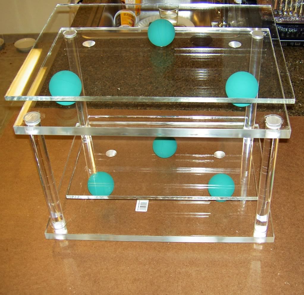

Along the same lines would 4-6 tennis balls decouple a sub of roughly 150lbs ?
My idea is to put a thick base with indentations (maybe a inch deep?…enough to keep the tennis balls in place) then attach a mirror image base with the same indents to the floor….foregoing the permanence would that work or would tennis balls be too rigid?
Edit…..I’ve seen a test where one tennis ball was squished in a hydraulic press to iirc 160 lbs so maybe one on each corner and one centered for a total of five?
To avoid permanence maybe non skid rubber on the underside of bottom plate?
Spikes are only beneficial to prevent the speaker from moving. They do NOTHING to drain away energy. They only transmit all of it to the surface they are on.I think you need to define the modes that cause this problem before you can move forward. For example, have you given thought to the reason why spikes can be beneficial?
I have done this Bob. With all kinds of squishy balls, for all kinds of applications. It works, but only so well. Anything still in the FR will transmit energy. THIS is why a person needs something to take the vibrations to basically zero. This sill require a suspension matched to the exact load to accomplish. Springs or suspension.
Thanks flaxxer……..in your experience would you consider the balls got you halfway there?

They worked well under equipment. Helped with my CD player and DAC.Thanks flaxxer……..in your experience would you consider the balls got you halfway there?
Not sure if hangin things from the ceiling would pass inspection! 😉
However the rebound rate on the balls is way up in the FR ... so not really. A person needs something with adjustable spring rate and rebound. Like a shock absorber. A spring with just the right specs would do this. Effectively "floating" the speakers, with springs which have a close to xero frequency vibration.
I wondered if the same thing could be accomplished with bungees. They do not have to be hung from the ceiling either. 4 "arms" at the edges of the platform, which stands about 6" tall could suspend the bungees to the platform 6" below. It would still rock slightly in any direction. The question becomes, the resonant FR of the loaded bungees.

There are feet designed for the purpose, usually made of sorbothane or similar, they are very effective.

I have experimented with many of them. Most do nothing audibly in my experience. Sorbothane has it's own drawbacks.There are feet designed for the purpose, usually made of sorbothane or similar, they are very effective.
I have seen stands which do however. They are as much as an automobile. They are made for literally "floating" the most sensitive equipment on the planet. Many are computer servo controlled.
The end result is the speaker ends up acting as if it is literally floating.
