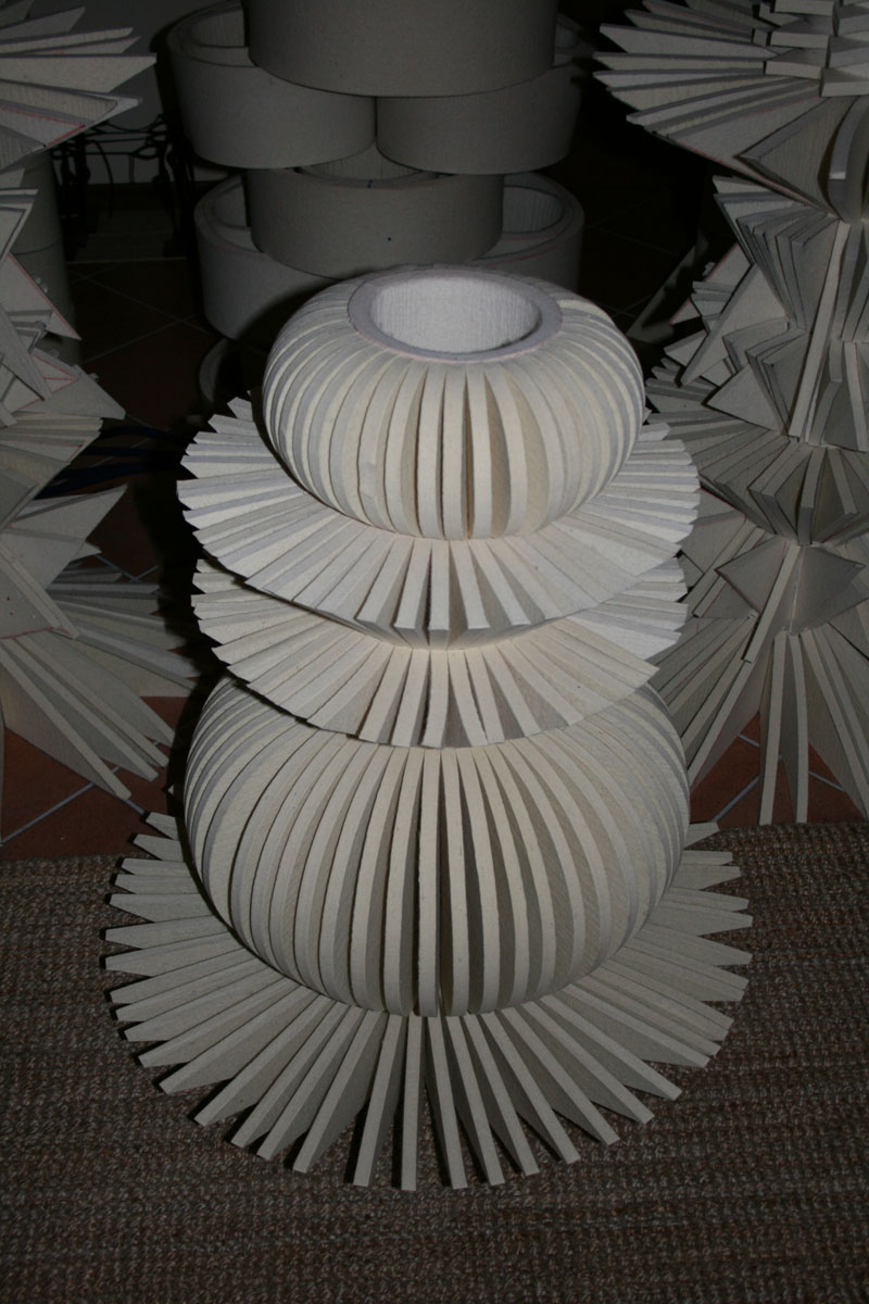

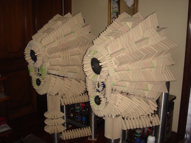

About Lorenzo Russo I can ask for some of his articles, published in Italian reviews over the years.
In the meantime....

Now those are interesting... What are the pricipals behind that design?

The basic principle is just one preserve: the original recorded sequence.
This is the same for the entire system, from the source to the speakers.
To achieve this goal you need ideally infinite (mechanical) rigidity and total mechanical decoupling of each part from the external world.
In practice this is impossible and you accept to commit yourself with the minimum error.
In this specific case, the speakers are subsonically coupled to the outer world.
This means they can just be vibrate at frequencies equal (or below) to a certain value: 1Hz or less in this case. Regardless of incoming or exiting vibrations those can dissipate their energy only at those very low frequencies.
In other words the loudspeakers are vibration free in the audio band and well beyond. In this way you have achieved your goal in practice.
The evident acoustic material around is to control the radiation out of the "cone" of your interest. The combination of the drivers is so that you get the best alignment in the time domain.
