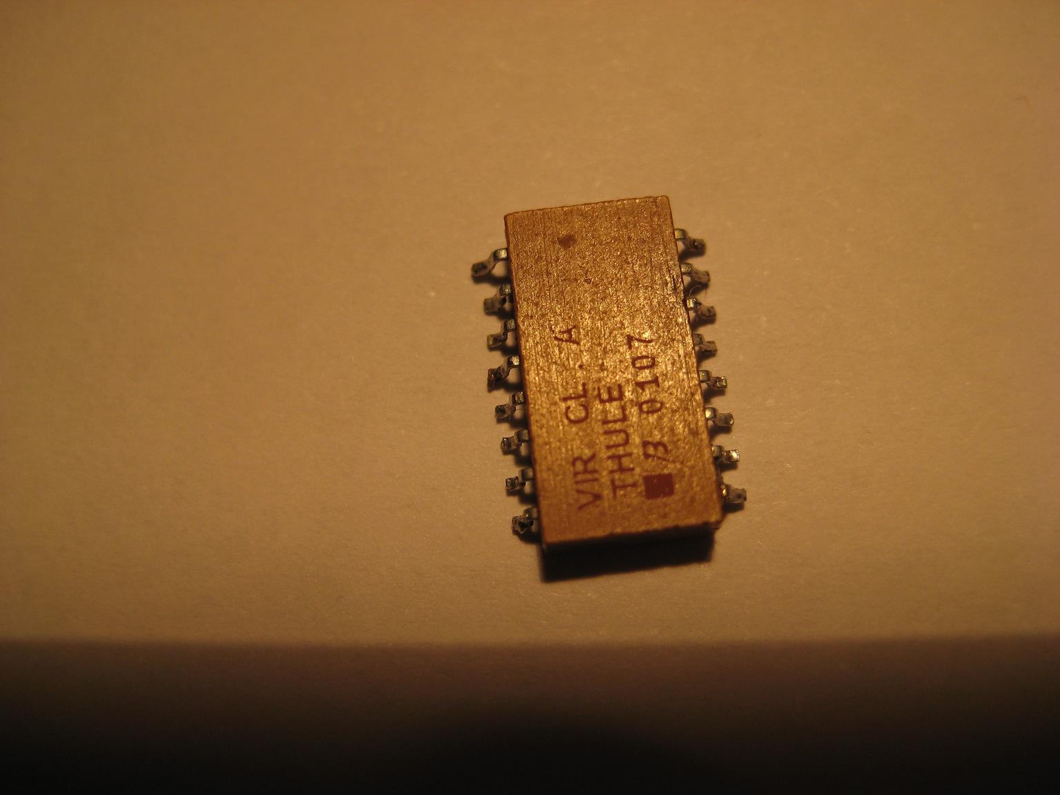

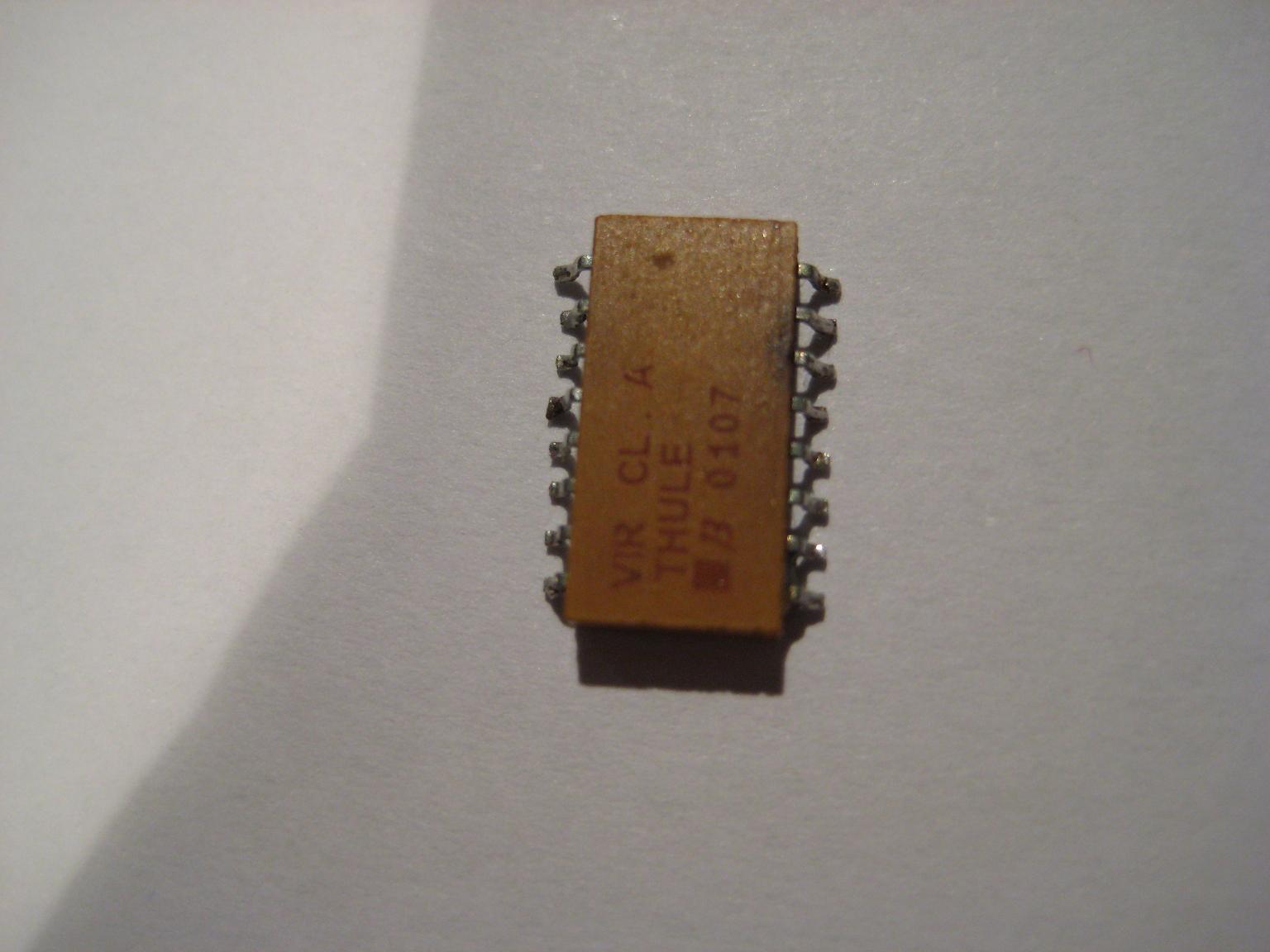

Faulty Thule Audio PA250B II amplifier
Hello Everyone,
Reading this thread, I understood that support for multichannel amps is nearly non-existant, but I don't want to loose hope, yet.
I have a faulty Thule Audio PA250B mkII amplifier (left surround channel isn't working anymore and also left front channel isn't working when I switch to stereo). The technician, who checked it claims the problem is in one of the chips. As I understood he disabled the channel, because it kept burning and he suspects that this chip is to blame. From www.sidekick-audio.com I've found out that this is a custom resistor network made specially for Thule and no alternative can be found on the market. Unfortunately they don't have it. Asked another former distributor www.highendmusik.dk and the answer was the same.
Maybe someone could give me an advice where to ask about the chip or a workaround solution, or maybe, help to find schematics of that chip so a replica could be made (is Thule's technology bought by someone?).
I'd be very grateful for any information on this.
I've attached pictures of the faulty chip.
Thank you and best regards,
Andrej (Latvia, EU)
P.S. also does anybody know where to find a service manual exactly for PA250 mkII, because I have both manuals for PA250 and PA350, of which the latter is similar to the schematics of my amp, but still not exact

Hello Everyone,
Andrej (Latvia, EU)
I may be completely wrong, but this could simply be a standard part marked Thule or a special selection. You need to use an ohmmeter yo determine the configuration and values. These devices are made by numerous resistor vendors like Bourns, Speague, Vishay etc. if someone posts up a schematic we may be able to work out the value for you.

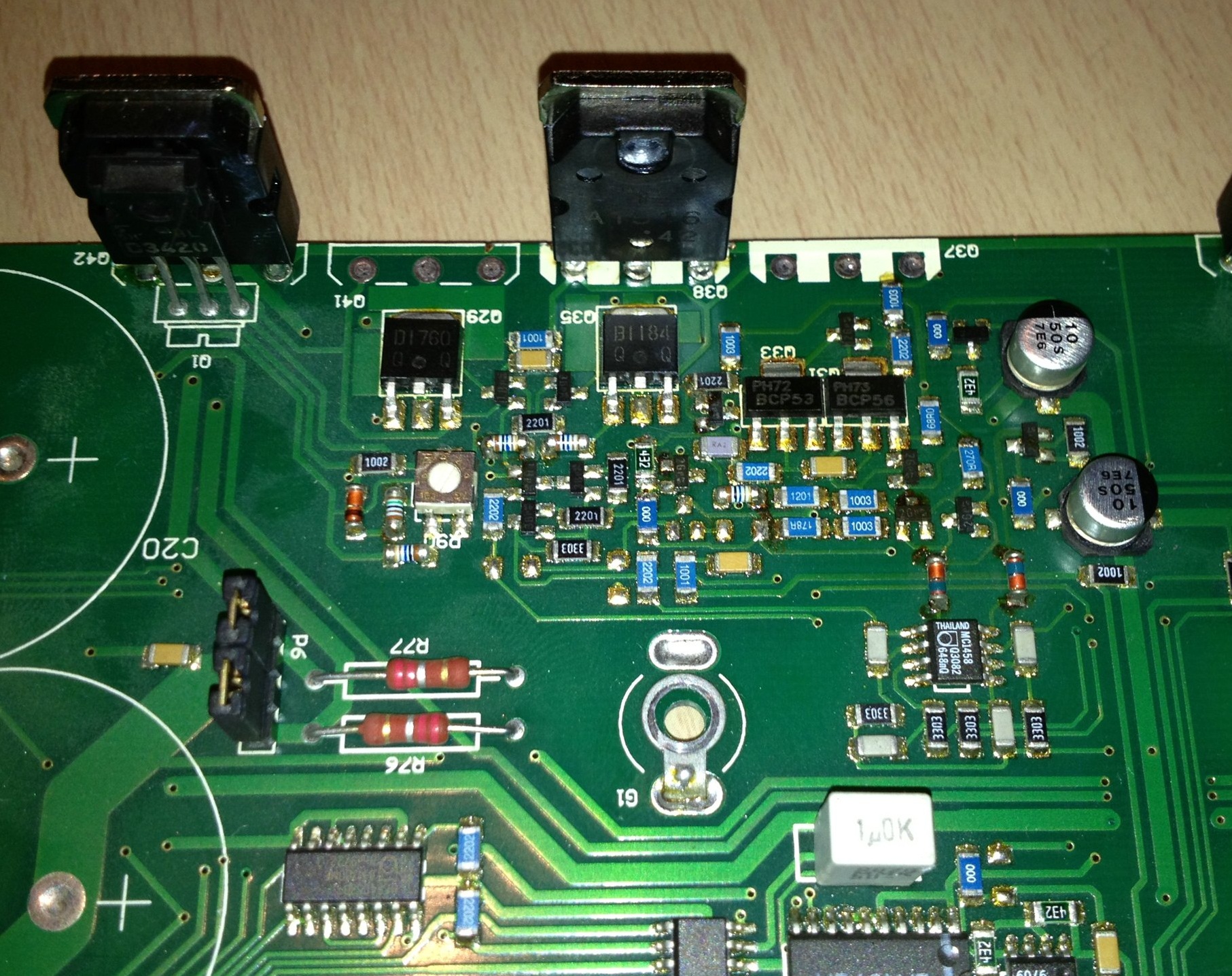

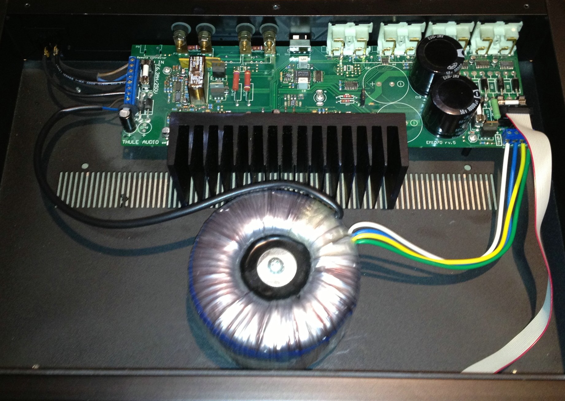

it looks like I'm the lucky owner of faulty Thule Spirit Start integrated with rev5 pcb.
So the good point is that it powers up, display lights up and volume could be adjusted.
One of the channels shows 26V dc offset, other about 1mV that is fine I suppose.
After a brief investigation it turned out that one of A1516 transistors is gone + 1k blue resistor (marked with red). The other Vishay smd resistor (316R) gets very hot once turned on and looks like burned, though still works, anyway I've desoldered it as well (marked with blue) and will replace.
The other two power transistors are fine (D1760Q & B1184Q), checked them as well.
It's not an issue to get these parts, though I'm a bit frightened by this post and I'm wondering could there be any other defective parts (for instance, two smd transistors marked with white. There are hardly visible markings on them - 1B p50 & 3B p75. So I tried to google them, but was unlucky. Hope these are fine)?!
Now the question, is it safe to replace A1516 and a burned resistor or should I investigate further?
tiefbassuebertr,
as you mentioned here that you modify and repair Thules, could you please advice me on my further actions as well as provide some clarification if possible regarding these two 1B p50 & 3B p75 smd transistors? 🙂

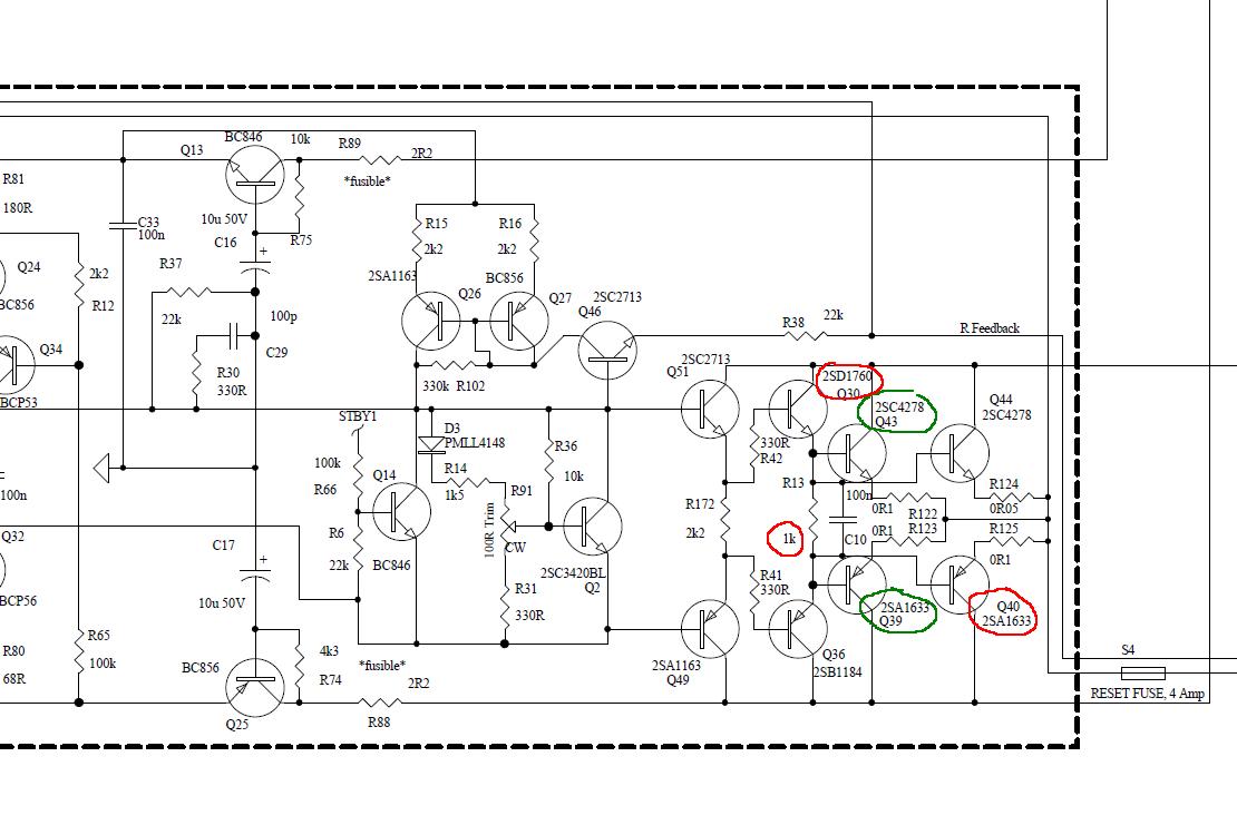

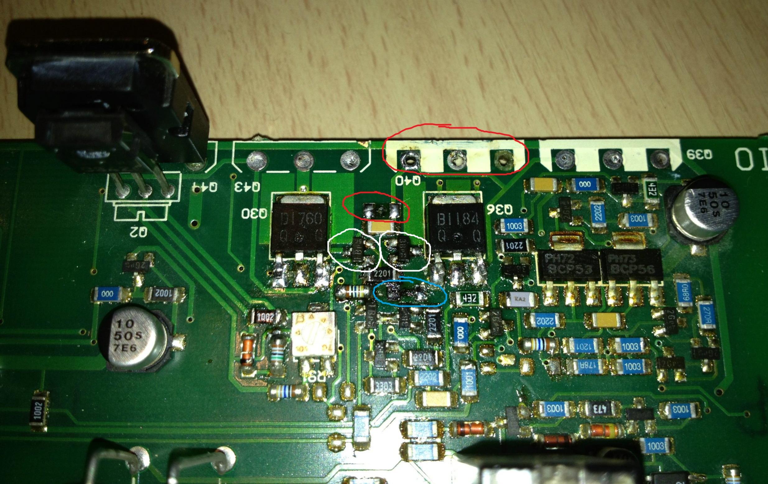

I would need a piece of advice concerning repairing my faulty Thule.
Finally I got all the parts and replaced two faulty transistors and 1k smd R13 (marked with red). I'm attaching the scheme from IA60 that is very similar to mine except 2 output transistors marked with green (none of them is on my pcb).
So I replaced the parts, attached the sinks back and turned on the device. Sudden smoke has appeared and R13 started to melt. I have double checked all the near devices before soldering new transistors (Q51, Q44, Q49, Q36 as well as resistors). So what could that be? 😕 I have replaced R13 with 0.25w similar size resistor as original one that was burned.

Hello Konstantin,
Sad to hear you still have a problem after replacing all those parts. Unfortunately to guess what may have caused the 1k resistor, R13 to burn is difficult because the power supply has a 100 volt potential that can be conducted across it for many reasons.
A worst-case scenario is that resistor R13 would have to be able to conduct 100ma, which is 10 watts by a 0.25 watt device.
A version of this scenario could happen if both Q30 and Q36 were shorted, collector to emitter. This kind of short could also be made by solder bridging traces. Could be caused by failure of Q49 and Q51.
Looking back further into the amplifier, the bias stage, with all other semiconductors having been ok, if D3 was open or lost connection with its trace, or R14 being open or lost contact with either of its traces, or pot R91 being open between itself and R14, then both Q30 and Q36 would be biased into very high conduction, far greater than R13, the 0.25 watt resistor could sustain.
These are the area’s I would look at first. Could be other conditions although most probable are those I just detailed for you.
Good Luck.

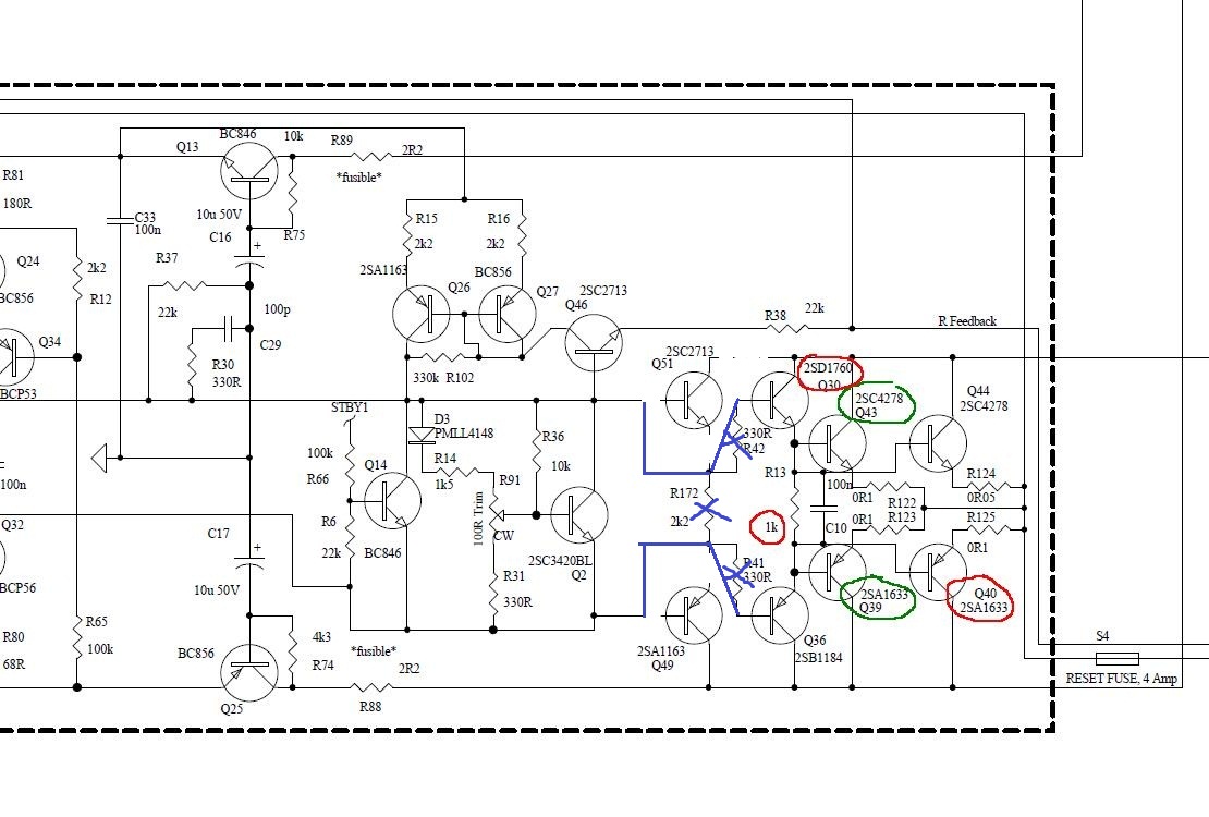

The reason therefore are unwanted oscillation. The output power follower consist of a triplet, that basically is better than an ordinary darlington, but more critical in order of the PCB layout.
Convert the power follower in a darlington, i. e. remove the first stage Q51/49 and perform all additional steps therefore.
Unfortunately I cannot assist you in respect to all necessary details.

tiefbassuebertr,
just a small clarification, should it look like that in the end? I'm frightened to cook any other parts accidentally.

tiefbassuebertr,
Partly right, bot very important details lacks.
check ot the attached pdf - perhaps this helps. But maybe not. Read all my posts here to understand, why.
