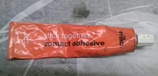

Can Fevibond be used to stick polyester open weave grill cloth to MDF ?
Pidilite Fevibond for Sticking Leather Rubber Rexine (50ml) : Amazon.in: Industrial & Scientific
If not, what product is available in India ?
Ask at hardware shop
SR998 is also made by them, comes in tins, and is intended for use by cobblers, carpenters and so on.
Much cheaper than tubes.
Try a small patch first.
