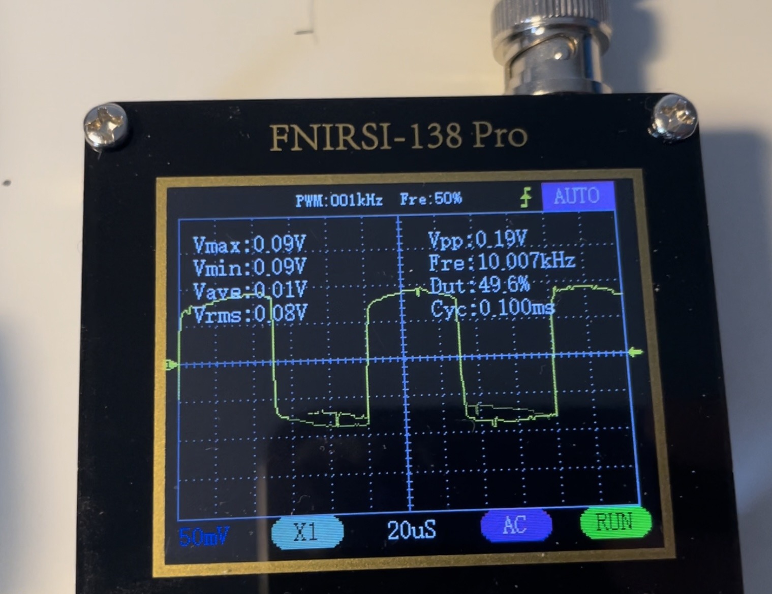

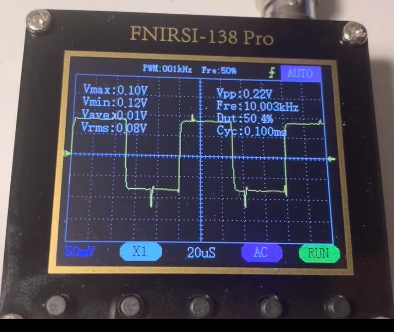

I had a chance to test LM3886 using square wave generator on low gains like 3.3x 4.7x 8.2x 9.1x and 10x.
To see the full picture, I started square wave generator output at 0V and gradually increased the output up to where I was getting 22Vrms from LM3886. At that level LM3886 was maxed out. Technically it was maxing out around 17V to 18V.
Used linear PSU with Antek AN-2222 200VA 22V secondaries.
Input resistor was 1K and feedback resistors were changed for every test.
At 3.3x gain with no compensation at all LM3886 was able to go up to 10Vrms output. More than that and it was breaking into oscillation.
At 4.7x gain no compensation I was able to get output up to 14Vrms.
At 8.2x gain got 17Vrms out.
At 9.1x got 18Vrms out.
Atx 10x got 18Vrms out.
In all the cases above square wave on the output was a perfect square. That applies for output level or 0.05Vrms, 0.1Vrms, 1Vrms, and up to the level right before the clipping.

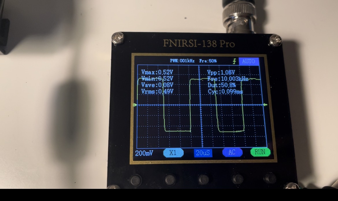

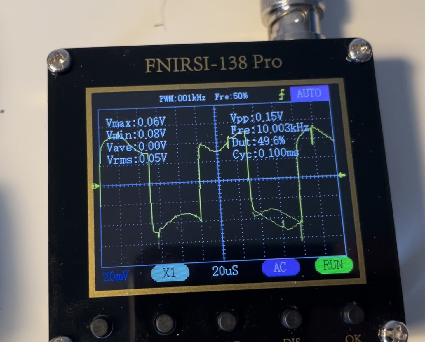

I also tried low gain of 3.3x while applying compensation capacitor of 33pF in parallel with the feedback resistor.
Square wave at low output levels looked strange - top and bottom lines turned into mini sine waves.

I also testet 47pF and 100pF caps over the feedback resistor. Same issue with the square wave - except even worse.
Another test I ran was adding resistor in series with cap. Basically RC network of 3.3k and 33pF in parallel to 3.3k feedback resistor. Input resistor was set to 1k.

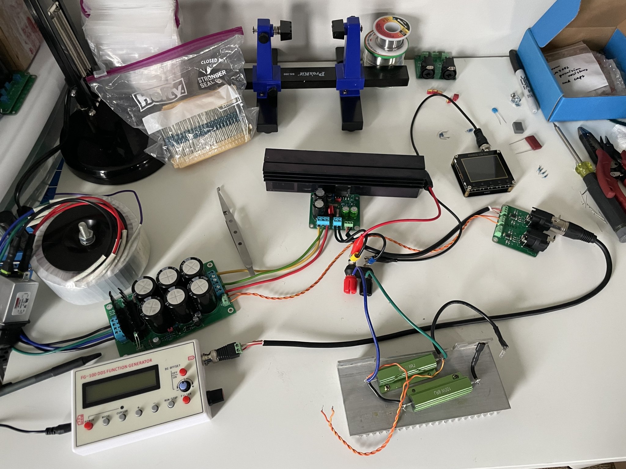

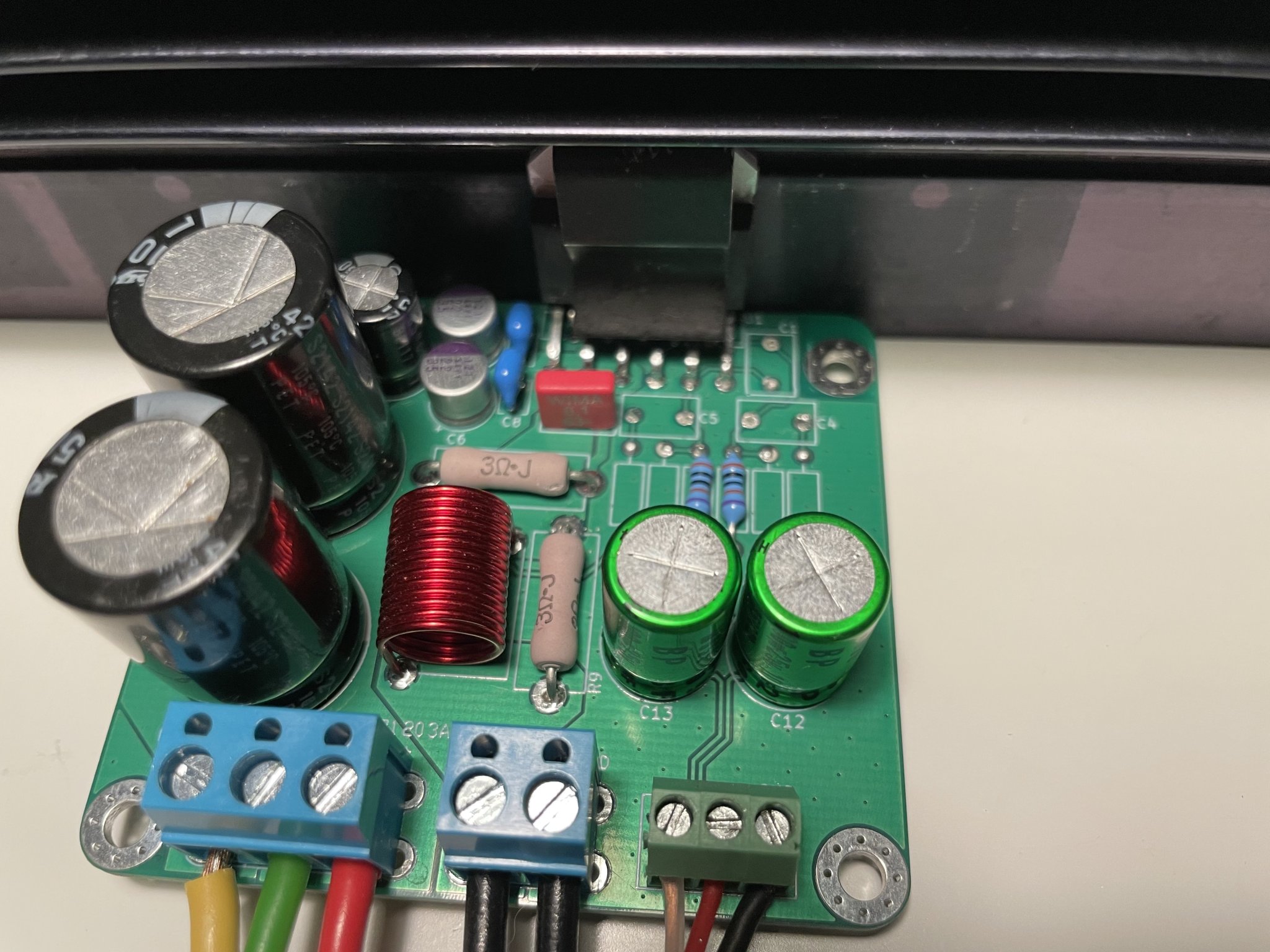

Attached is the photo of the testing setup. I am not using anything fancy as this is just a hobby.
Im pretty confident in oscilloscope, but not so confident in that square wave generator.
