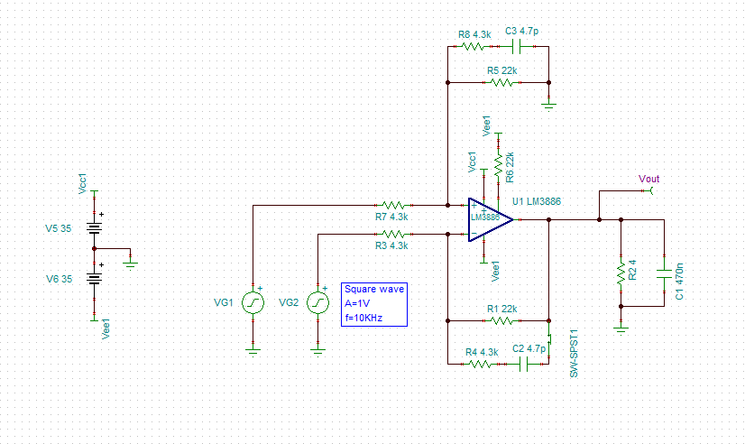

Would it be a good idea to use LM3886 as a difference amplifier with gain of 5 for both inverted and non-inverted inputs? Will the gain technically still be 10?
No. The relevant search terms are: Loop gain, feedback factor, phase margin. Or see Chapter 8 of Franco. I was told at one point that there's a .pdf version of the third edition of the book floating around on the 'net. Perhaps you can dig it up. It's a pretty straight-forward read.

I wonder if adding two capacitors to feedback resistors will ensure stability - I simulated few graphs in this post -
https://www.diyaudio.com/community/threads/lm3886-gain-of-5-as-difference-amp.388213/post-7073680

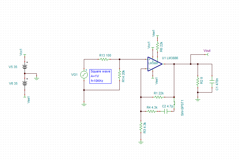

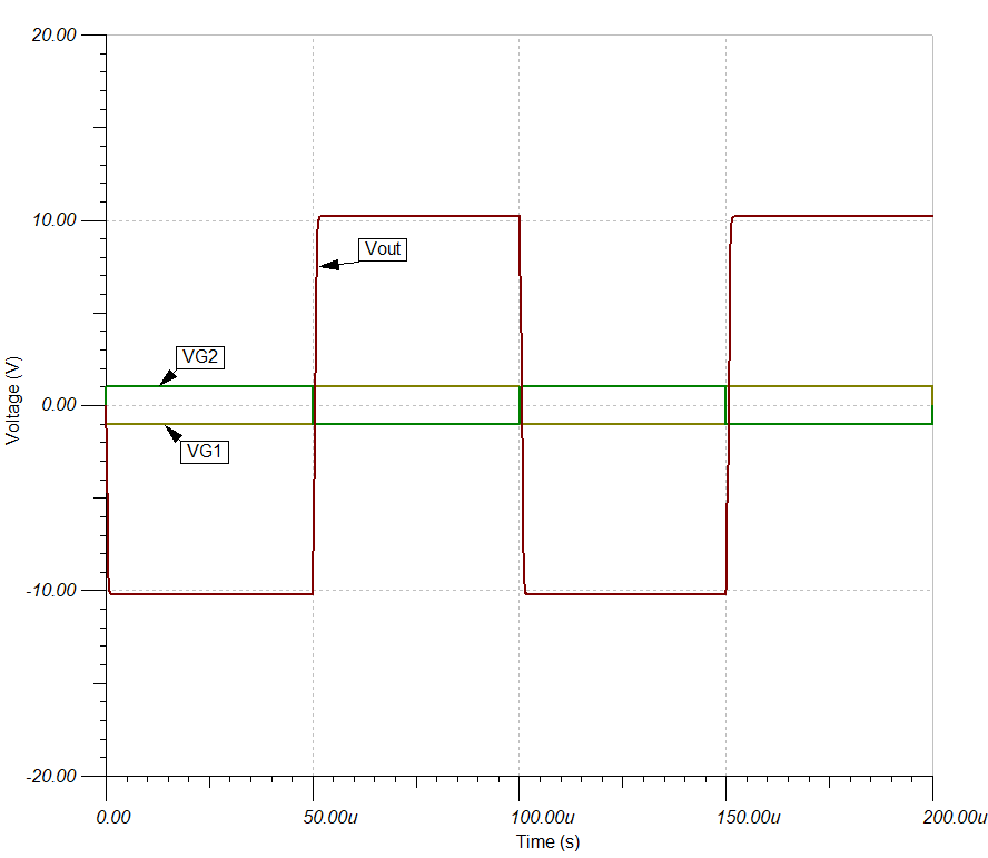

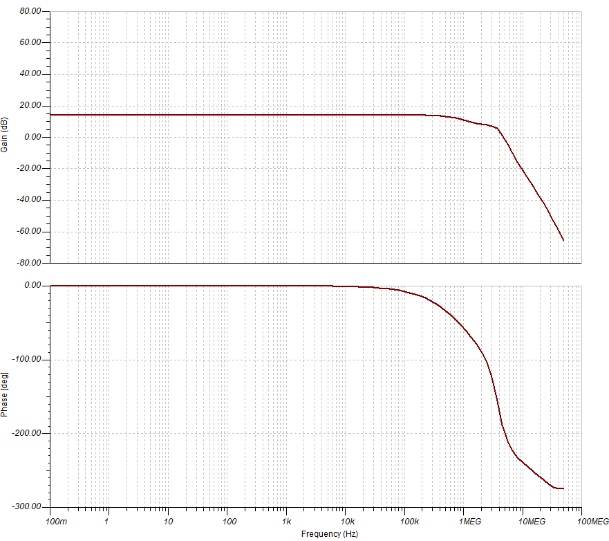

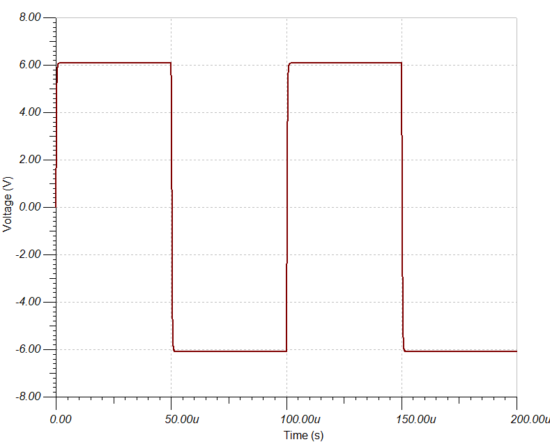

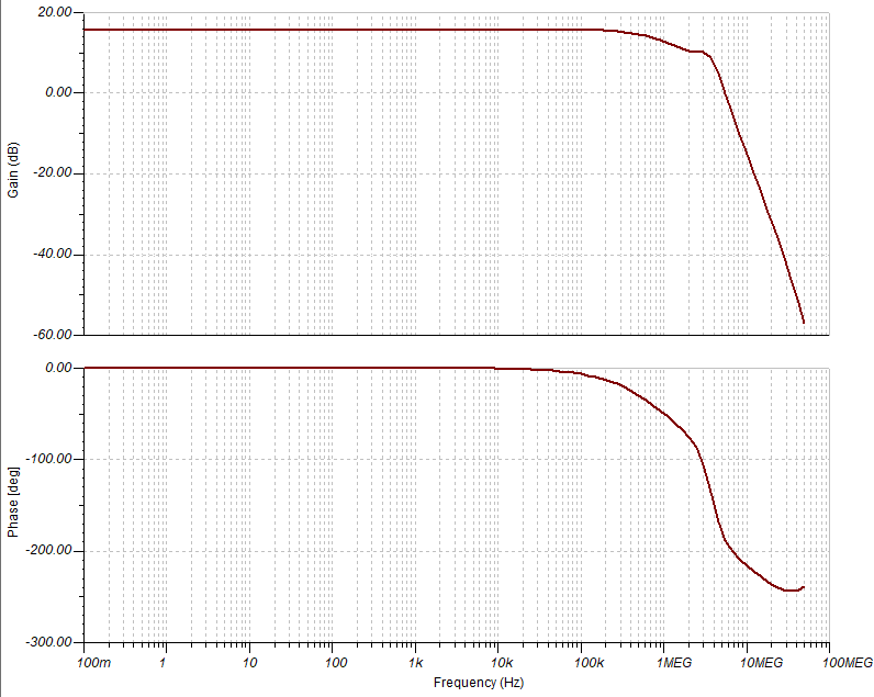

In the meantime, I have simulated my desired gain of 6x and came up with RC values for compensation.
I will need input resistance to be equal or more 3k since I plan on using three LM3886 in parallel - it will give me input resistance of 1k or more.
Right now I am using 4.3k input resistor that should allow for 4.3/3= 1.43K for input impedance.
I am not sure about small value of the compensation capacitor. It is 4.7pF. PCB traces will probably add 1~2pF additional capacitance. Should I try to increase lag cap to 10pF to diminish PCB trace capacitance effect?
Attached are screenshots of TINA-TI simulations.
