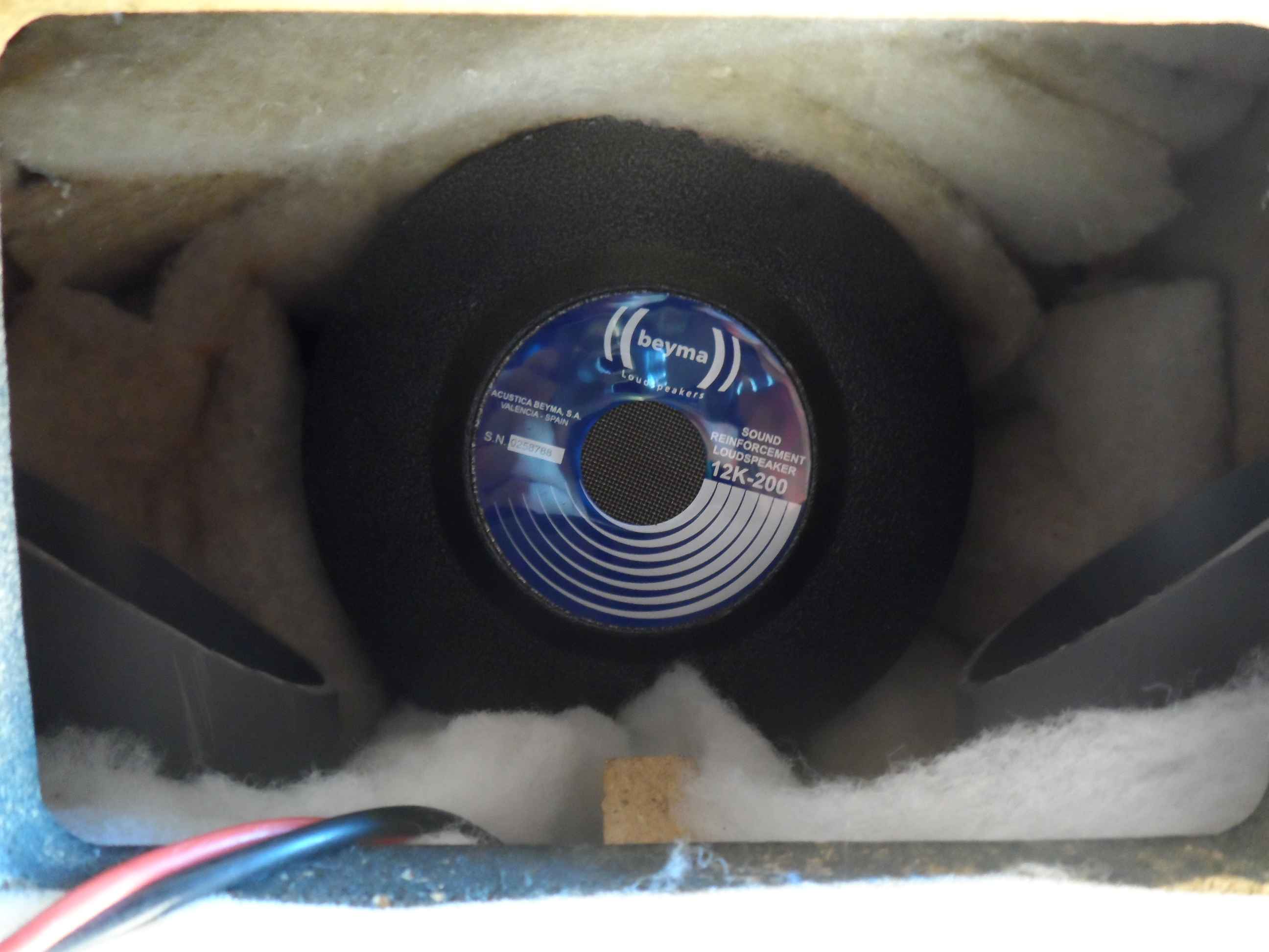

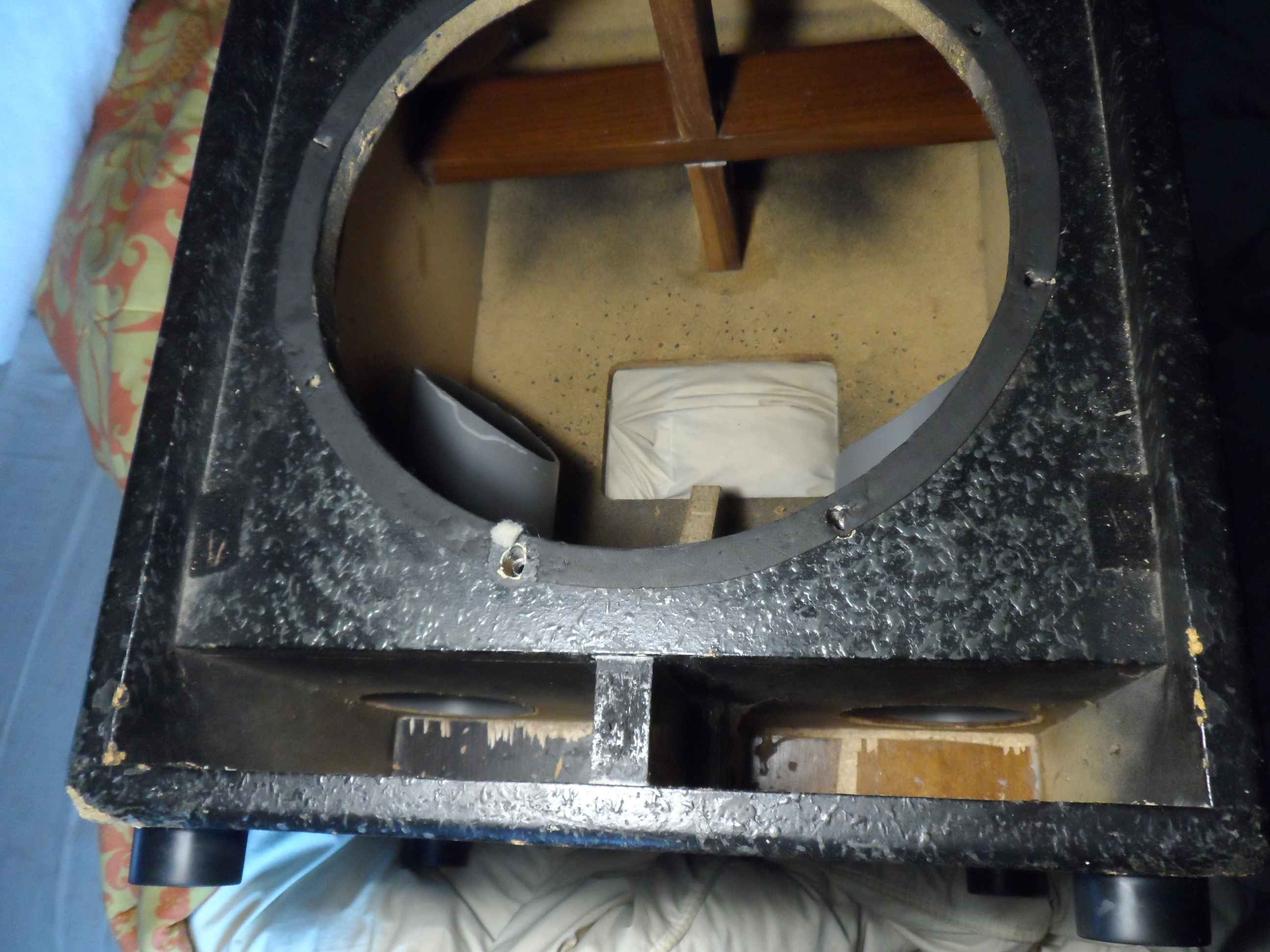

The most difficult case for a normal vented enclosure is the "high-output 2-way full-range" application.
The two pictures show a prototype speaker (vintage, modified).
For port standing waves:
- The location where the mouth of the ports exits inside the enclosure matters.
- The distance to the cone also matters.
- The optimum shape of the port is not necessarily straight or constant section.
- The optimum cut of the mouth is not neccessarily perpendicular.
- Location and amount of stuffing matters.
A Q over 3 in main resonant mode usually does not sound good.
Port standing waves do not sound good.

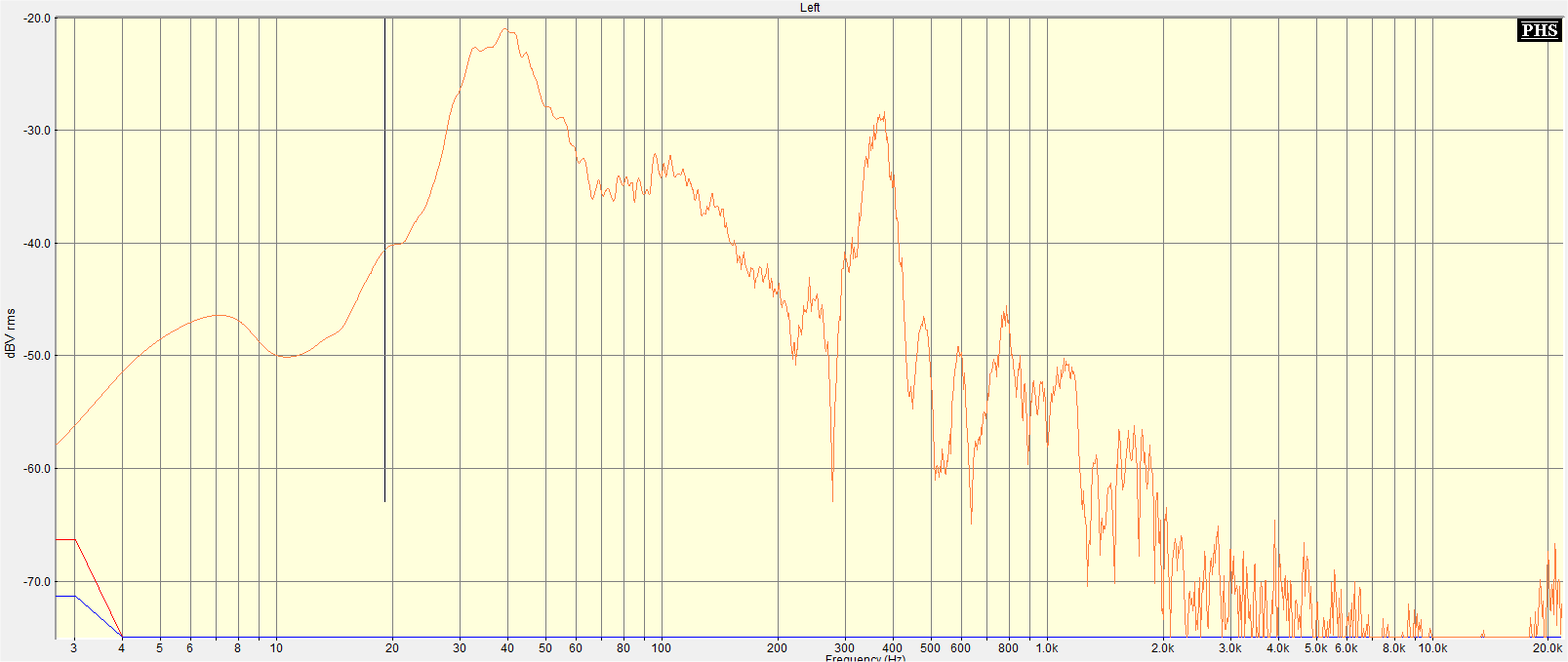

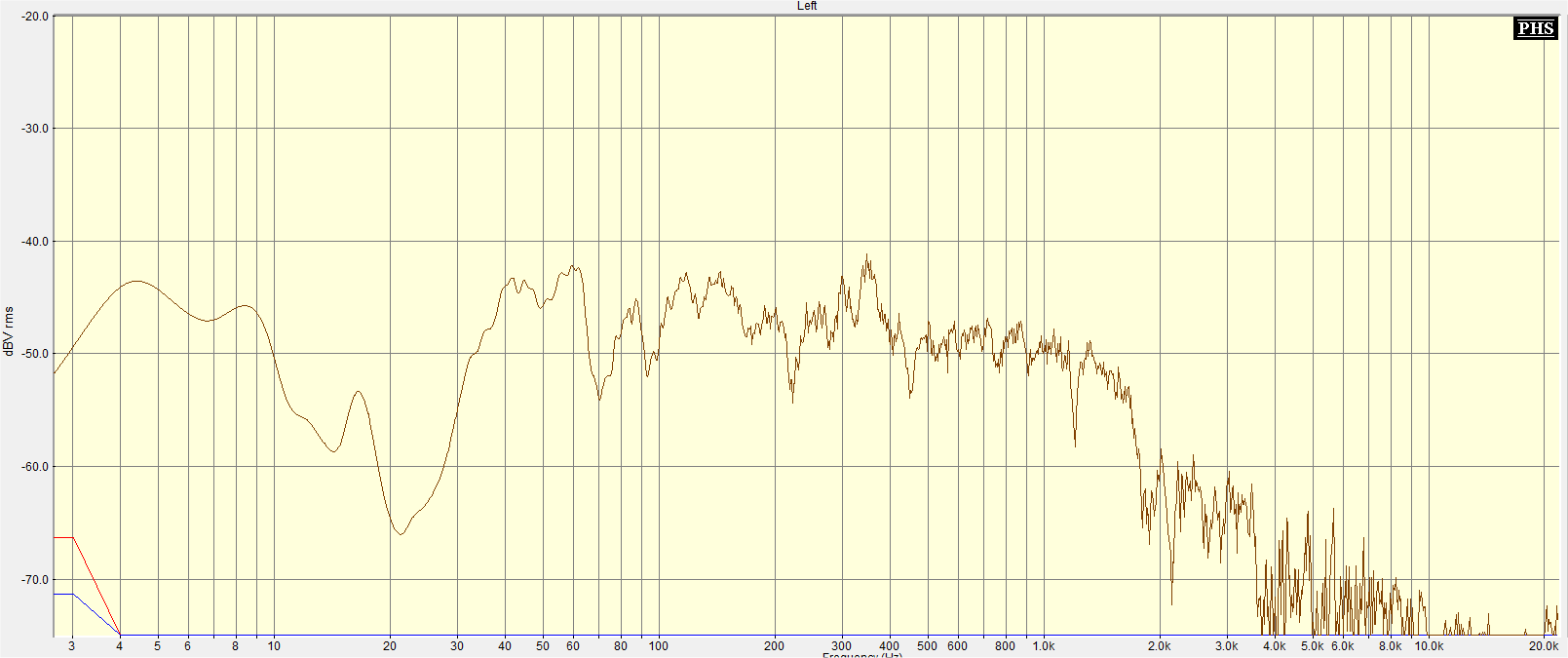

Frequency response plots are:
- Response at half way of port (in-room).
- Response at half way between (20cm to) port and (20cm to) speaker (in-room).
(The bump at 360Hz is the standing wave due to enclosure height being ~48cm.)
Distortion is the other parameter to consider. However, this is well explained in other sources.
