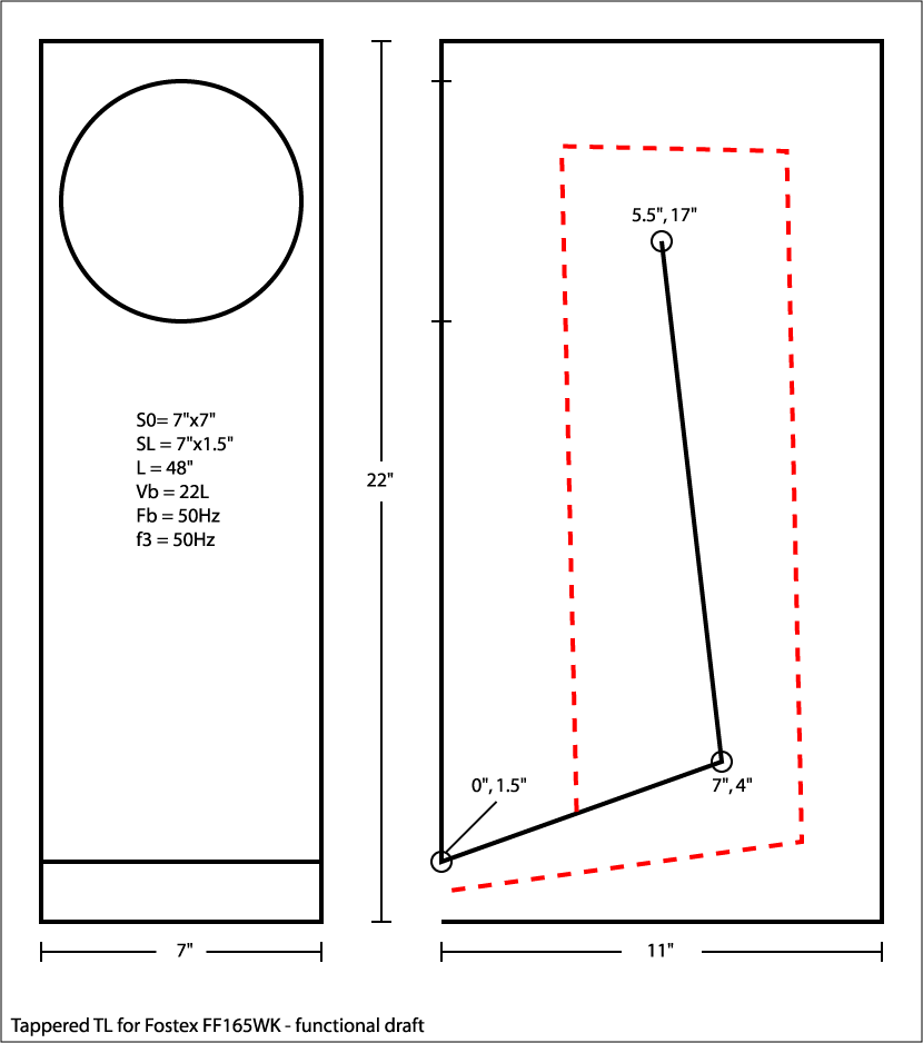

Looks like home audio drivers will be more suitable for you then. MA certainly is a good option, so is Fostex. Playing around with the 6.5" FF165WK in Hornresp, I came up with the following tappered line:
It simulates decently, with somewhat stronger low-end than a reflex of comparable size, with strong output to 50Hz. It's just a rough draft and does not account for material thickness. Net Vb is under 1ft^3. I have little experience designing and building such enclosures, so take this with a grain of salt, I'm just throwing the idea out there for kicks. I think it should perform at least OK. 😉
For a simple bass reflex, this driver seems like it'd work in volumes ranging from 0.5ft^3 to 1ft^3.

Ig81....Appreciate the box suggestion, but is a little tall for the available space. Am grateful for your suggestions.
