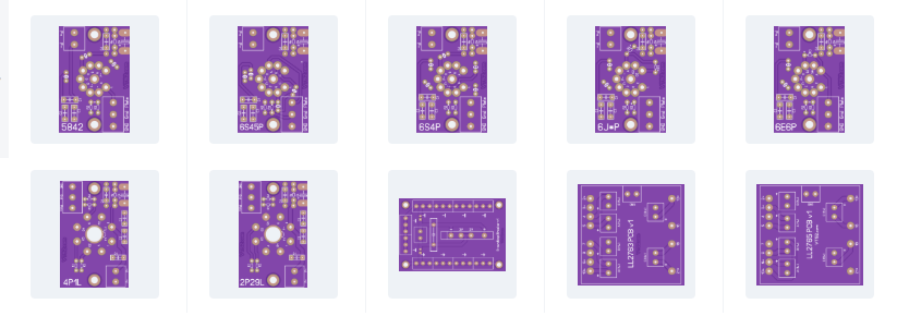

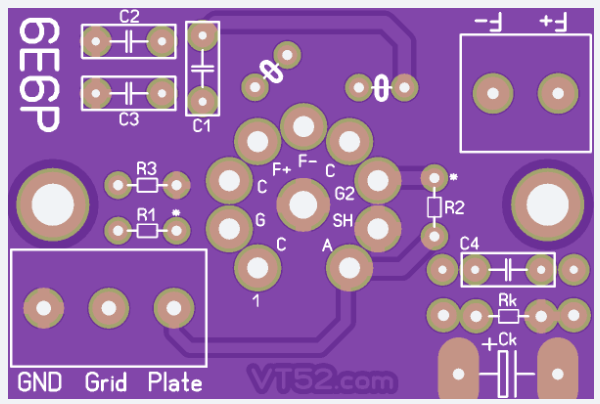

I made PCBs for about 15 different tubes to easily try them out, plug and play with connectors and bias chosen so they all run on 200Vdc from a universal PSU. 2P29L, 6E5P, 6E6P, 6S4P, 6S19P, 6S45P, 6J1P, 6J9P, 6J11P, 6J49P, 6J52P, EC8010, 5842, 5847, D3a and some others. But they are all configured to run between 15-30mA as I have an LL2763-40mA 2:1 interstage from a previous project. Output tube will be a 4P1L, bets are on the 2P29L but it's just good fun really.

Wow! Yes I want to concentrate on one topology (single stage driver, to IT, direct grid bias of 300B via IT secondary) for one output tube type (PSE 300B). Then try out many different driver tubes and IT's. A worthy use of time I think, on a worthy 300B. For a long time I was just building random projects then tearing them down learning. I'm thinking now I want to make this dedicated platform with very similar PCB's for the driver, same terminals, same size boards, etc. So the only variance is the driver board and what IT I use. The power section stays the same. To figure out drivers and IT's alone. My hope is to try many suitable driver tubes with resistor or ccs load with a collection of finer IT's, just see where it takes me. But first I have to build the platform shown in my schematic.

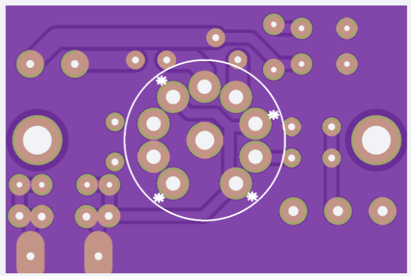

I tried most of the triodes about 20 years back, 6s45p is a beast to tame with its tendency to oscillate. I kept that in mind with the PCBs and added ferrites around the tube pins and/or on the pcb itself.
Working on a second set of PCBs with some more space and fixed header positions to make a modular amp basically: just plug in a different board to test a different tube. Mine are all triode strapped with auto bias parts on the pcb as well. Just B+, grid, ground and filaments.
